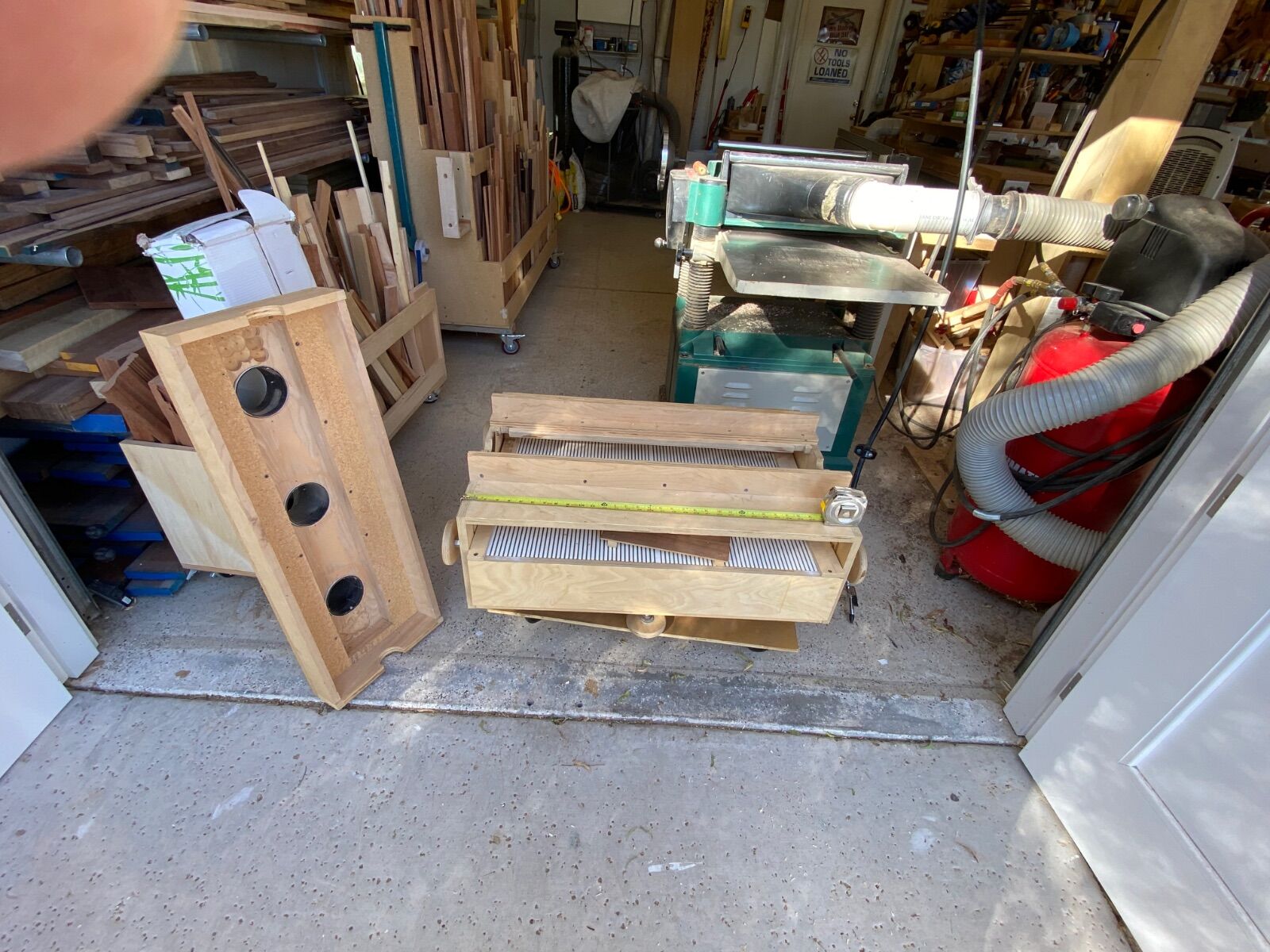

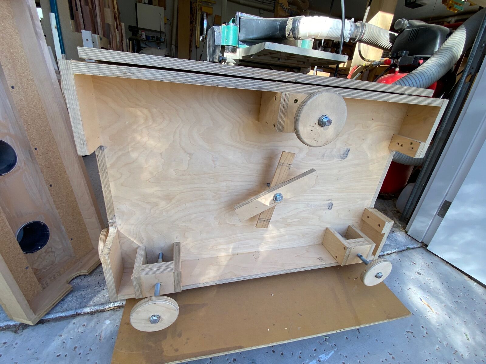

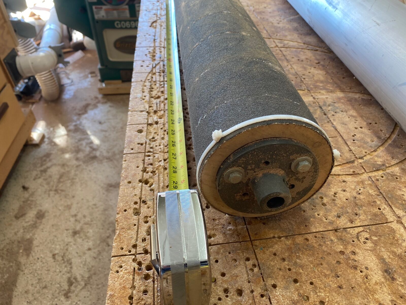

Popular Post Masonsailor Posted January 4, 2022 Popular Post Report Posted January 4, 2022 Well regardless of his eminence the Pope, here are my thoughts and lessons learned concerning the SS drum sander. My main purpose in building one was to be able to make a cabinet door that over the years has become our mainstay. The doors are a flat euro design that has the optical illusion of a raised panel door using contrasting woods. In the first version ala late 1970’s we tried using a wooden drum, mostly because it was what we had on hand. It worked very poorly because you can’t really balance it adequately. Without being perfectly balanced the results are pretty wavy. The next version used 4” PVC pipe that had fairly thick walls. That one worked fairly well. We ultimately packed them with moist sand before capping them to add mass. Balancing was good but not perfect. The final version uses 5” aluminum tubing with 3/8” thick wall. We found three of them at a metal surplus store. I think at the time we paid about $50 for them. These needed to be turned on a metal lathe to be trued up. The first version of those had an issue because my friend the machinist was trying to impress me with his lathe capabilities and turned them to a polished surface. Turns out it’s better to leave them a little rough. They grip the sand paper better. The aluminum tubes have more than enough mass. The ends for the tubes are hard maple. One end utilizes a 3” SS lathe faceplate and the other end a cup type live center. You could also use a cone live center. We turned then to pretty tight fit with a lip to match the outer diameter of the tube then used a mallet to pound them in. They are secured with three countersunk screws. That’s part one ! FlGatorwood, Cal, p_toad and 3 others 4 2 Quote
