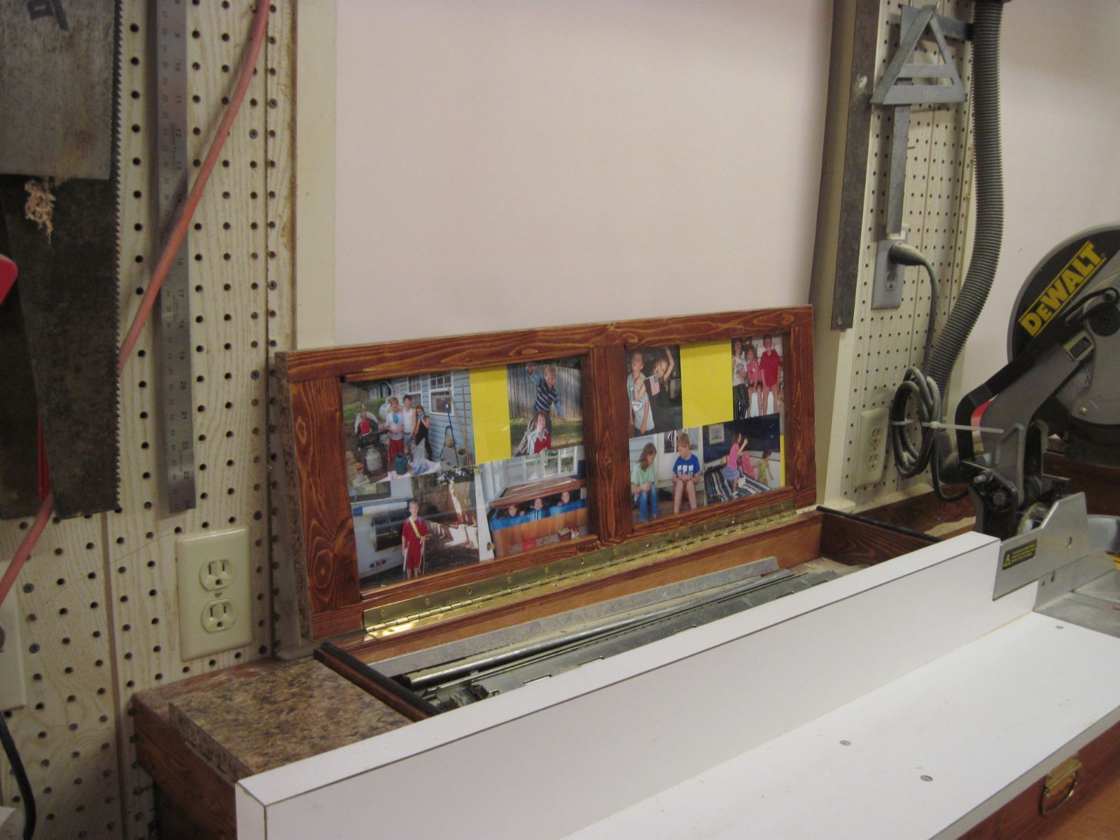

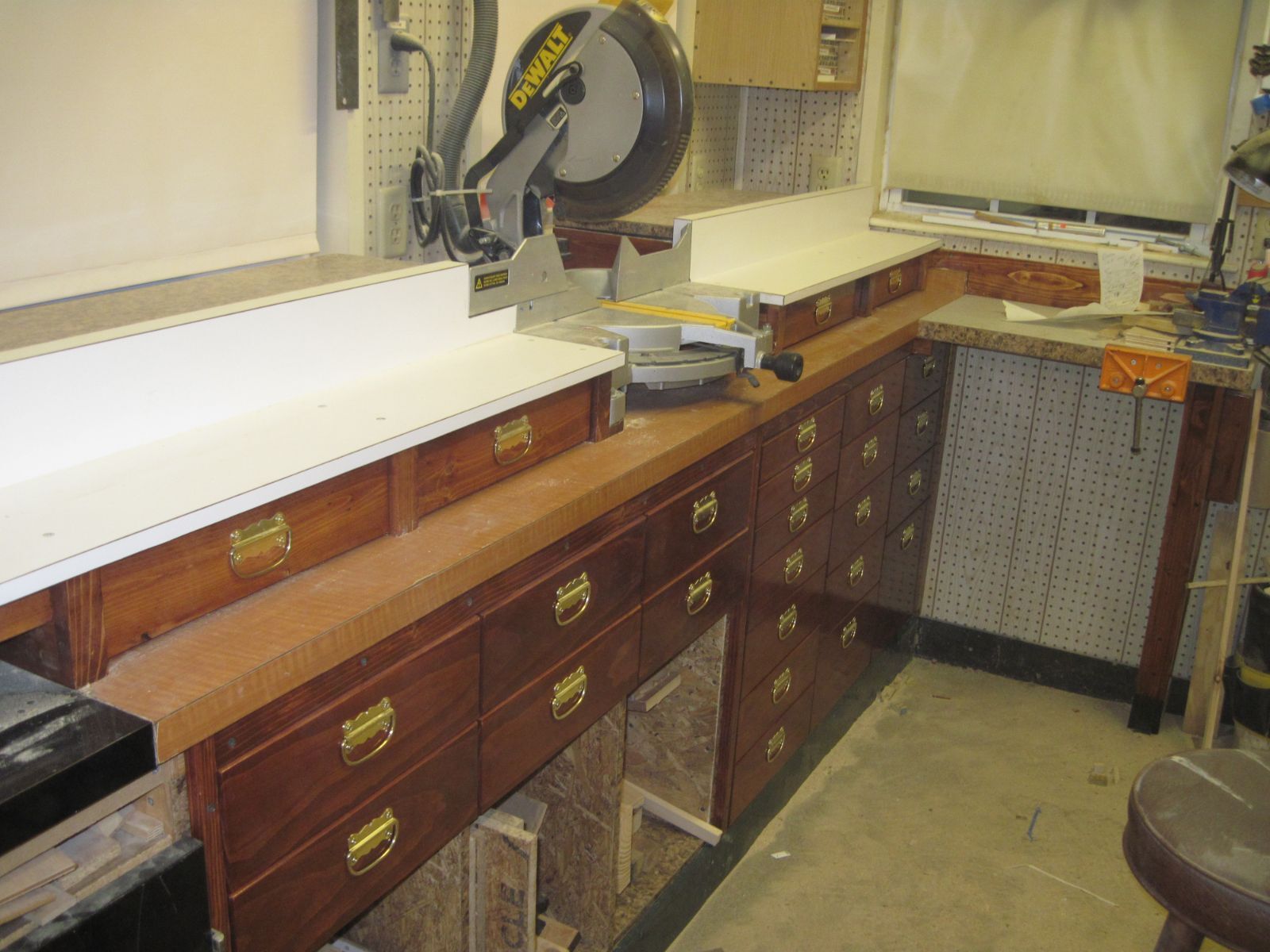

December 22, 20214 yr Popular Post comment_278842 3 hours ago, Outcast37 said: Same table. I won't tell you that it is impossible, it can be done. What I will say from experience is that the negatives to this are problematic. What you have is a tool (tablesaw) that can be mounted flush with the top and will greatly expand your capabilities. You can couple this with a built-in router somewhere on the table and that works pretty well. The negative comes with the miter saw. It is a above the table tool no matter how you position it. So it will be in the way of the table saw operation in some way shape or form. Now you could make a flip top so it is down and out of the way when using the table saw. BUT, that means it is one or the other, not both at same time. Shopsmith owners find themselves in this dilemma, but I am told it is easy to swap back and forth. If space is limited, then you must work with what is available. Key here is to maximize the space you do have. This is my miter saw set up. Typical of my work it is more extravagant than most. The level of detail and finish is not what is important. It is the use of space that I wish to demonstrate. Others will post what they have done for a miter station giving you some more ideas. Report
December 22, 20214 yr Popular Post comment_278843 Wow @Gunny, that's nice. I honestly don't think I've ever seen that wall in your shop. Love all the drawer space plus the finish and handles. Well done! Report
