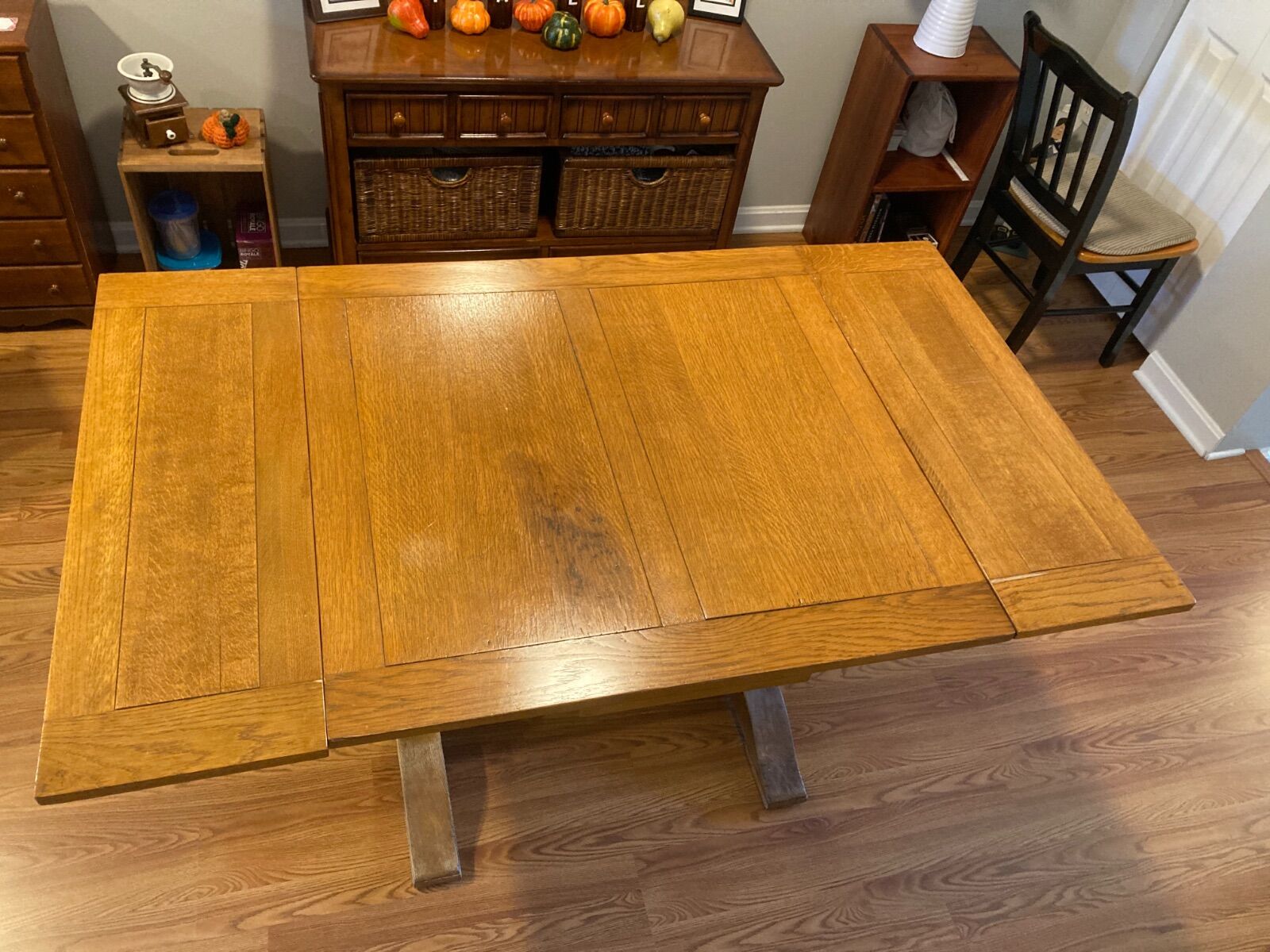

November 18, 20215 yr comment_275525 Help identifying the cause of the damage to the finish on this table would be greatly appreciated, as well as, some recommended techniques for removing and refinishing. My first thought was stripping and using oxalic acid solution but I wanted to determine what exactly is the cause of the black almost mold looking marks on the wood. Any help is greatly appreciated. Thanks in advance Report

November 18, 20215 yr comment_275560 It looks like the typical stain of oak (tannin), iron, and water. The usual cure for this is strip, oxalic acid, and refinish. I cannot tell from the pix if it's veneer or not, but it could be solid panels because of floating joinery. If veneer, be careful in sanding as to not blow thru it. It's probably best for color matching to do the whole top rather than try to recreate the center as a perfect match to the ends. If it's not the above type of stain, the other two bleaches may work. Report
November 18, 20215 yr comment_275589 I also am not a finishing expert, but here is my guess. Is it possible that someone tried to rub out between coats of a water based finish with steel wool? If so, maybe that is rust damage from the steel wool. Just my WAG. Report
November 21, 20215 yr comment_275881 Oxacilic acid is used to bleach out the iron stained wood. The stipper is to get down to bare wood to let the oxacilic acid work. If after the finish is removed and the black color is also removed it may have been captured in the finish such as was writen above steel wool dust. When finishing get the book from Jeff Jewit it explains it very well and simply. Once stripped and if necessary bleached. *Sand to 220 with care from 150 and if veneer be extremely careful. Then reapply you dye to set the background color. Then reapply your stain to the the foreground color. Vacume after sanding and before application of the top coat. Report

November 22, 20215 yr comment_275885 Looks like a scorch mark to me, maybe with a hot pan or an iron. Could also be mildew. Hard to say much without knowing what kind of finish. That said, I don't think there is any fixing it up. Best to refinish the whole top. .40 Report
