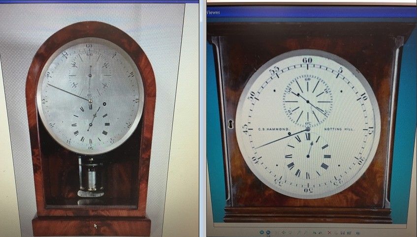

November 8, 20215 yr Popular Post comment_274641 That is a very unique clock. Looks like an antique the way you made it. I think I would have to be an engineer to read it tho. Is there some kind of history as to the reason they made it so complicated? Report
November 8, 20215 yr Author Popular Post comment_274645 46 minutes ago, Gerald said: That is a very unique clock. Looks like an antique the way you made it. I think I would have to be an engineer to read it tho. Is there some kind of history as to the reason they made it so complicated? Yes Gerald that was my intent. Here is an original Ingraham Grecian clock, not very complex although some did have alarms. The next two photos show an antique clock that I took more style cues from. Rather than being complex, they are simple in the fact that the hands are mounted on extensions of the gear shafts of the hour, minute and seconds train. The date was not incorporated on these oldies but I wanted to have the date displayed. As far as reading the time, the clock on the right says 42 minutes after 12. I suppose people got used to reading them. Report
November 9, 20215 yr Popular Post comment_274659 Well however you read that clock it is very cool. Paul Report
