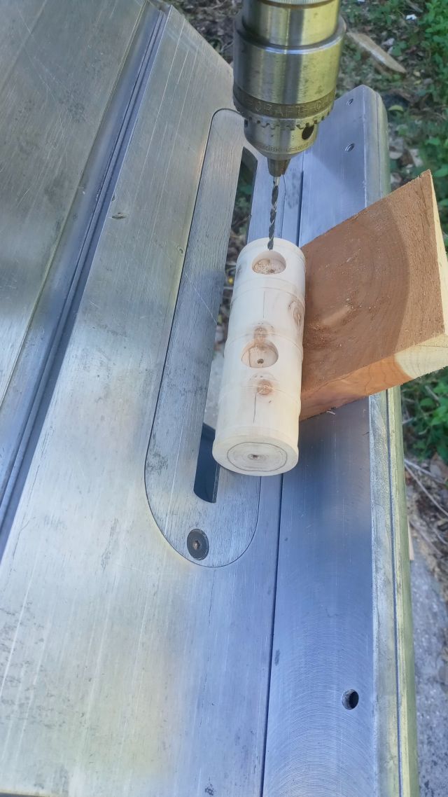

November 3, 20215 yr Author Popular Post comment_274143 Time to turn boiler tank. Turned on a Shopsmith. With high speed steel skew chisel. Cut cab and forgot to show that it was cut on a bandsaw. Turned stack and water port. Holes bored for water port and stack. Edited November 3, 20215 yr by FlGatorwood Report

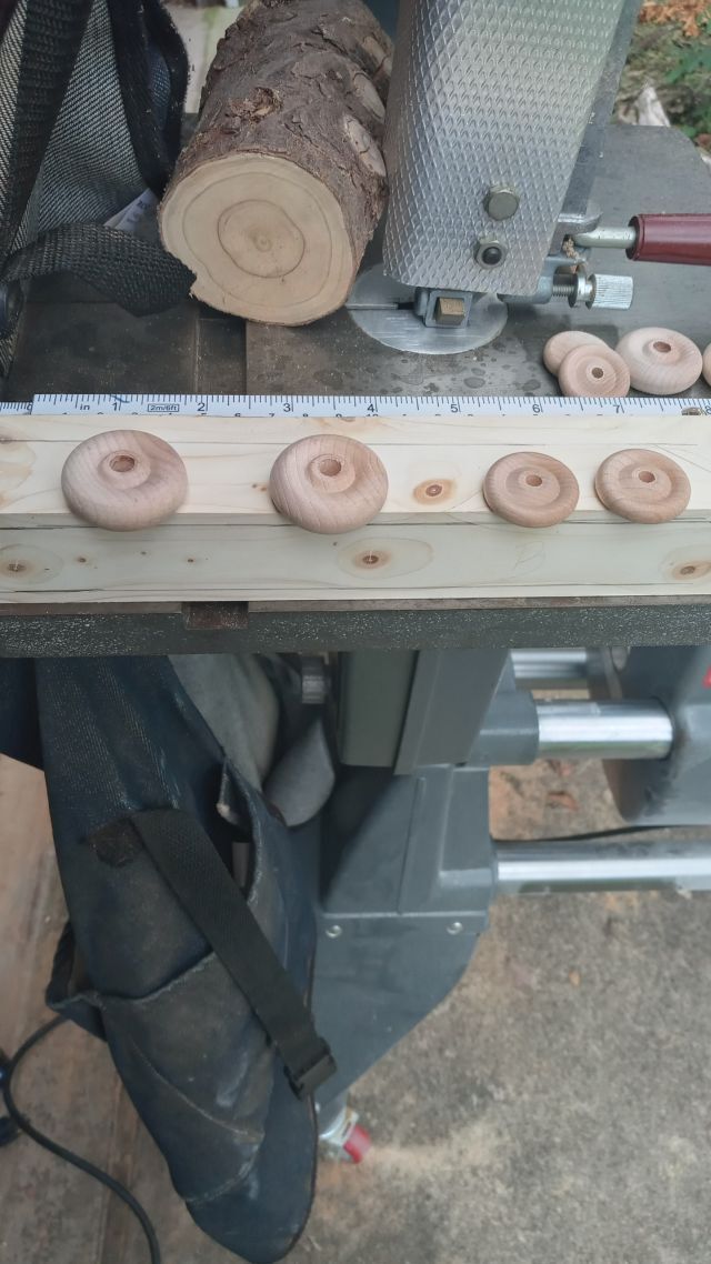

November 3, 20215 yr Author Popular Post comment_274145 Unsanded parts dry fit. I got this out of sequence. There is always a time for wheel layout, how many, where and what size. Pilot holes drilled. Water port and stack screwed to the tank. Holes recessed so as not to interfere with curious little fingers. At the cow catcher, the hole is bored to receive the knot of the pull string. Edited November 3, 20215 yr by FlGatorwood Report

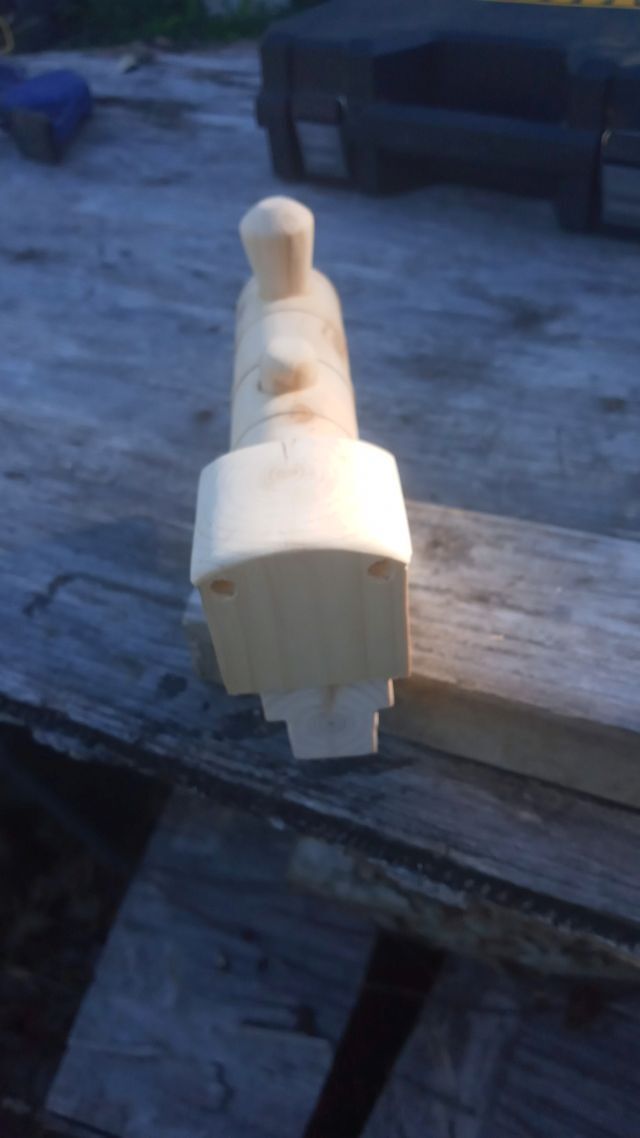

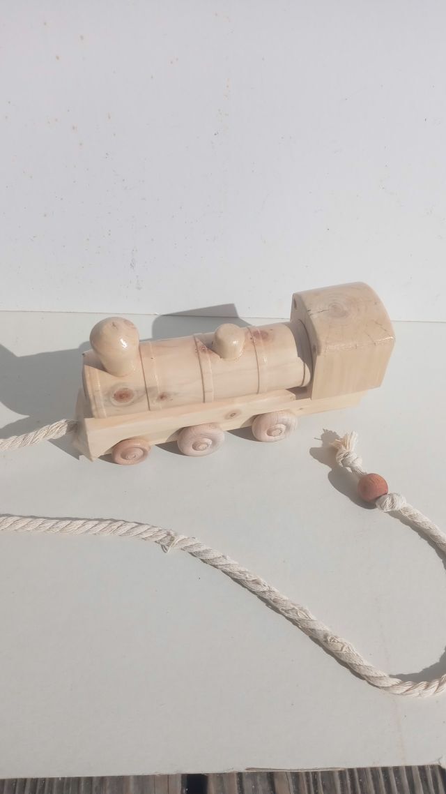

November 3, 20215 yr Author Popular Post comment_274147 Water based Minwax poly applied. Initial sanding was 220, the graduated to 600 grit. Stack has a slight list to it. The old man must not be able to see as well as he once did. Need a ball for the tow rope. I thought this was oak, but after turning with a skew chisel, it appears to be mahogony. Pretty much ready. I don't recommend this rope from Michaels. I had to use glue to get it to thread through the holes. My abnormal signature with date and made in USA. Going to give it to the grandparents tonight. Need another coat or 2 of wipe on poly. Edited November 3, 20215 yr by FlGatorwood Report
