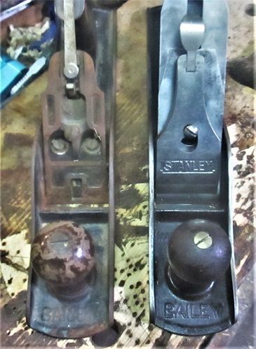

This chipbreaker WAS missing that bolt that holds it to the iron....Spares Box provided one.  Wire wheel to remove the rusty and krusty stuff...Several brushes helped out...
Used a "Beater" chisel to dig some of the junk out....then a wipe down...then work on the sides..

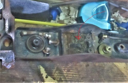

Clean the handles...frog, and all the threaded stuff...Wheel was not engage with the yoke....was pushing the yoke into the back of the frog...

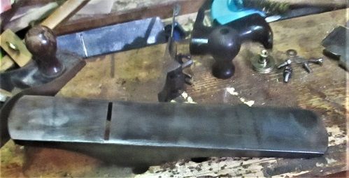

Got the sole looking a bit better, cleaner,anyhow..
Sharpened the iron, polished the chipbreaker...then put things back together..and a test drive...
Almost like new?   One done..

A Stanley No. 5-1/2c....aka Jumbo Jack plane...other than having a Tall knob instead of the normal shorty...everything else shows as a Type 11
3 patent dates...
Flat faced frog, small Brass adjuster wheel..
How often did Stanley cast the model number into the frog's behind?
