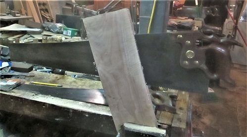

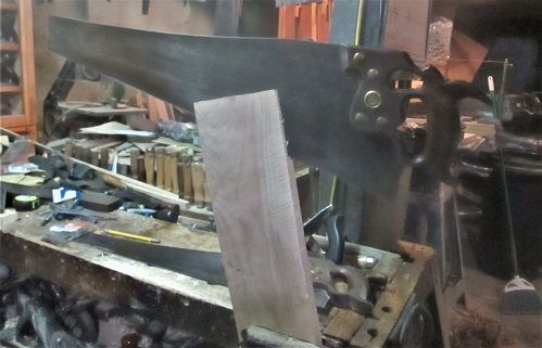

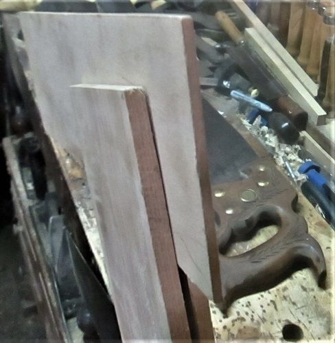

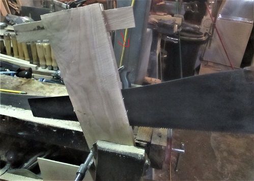

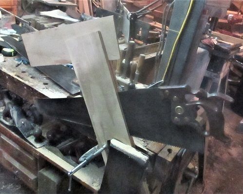

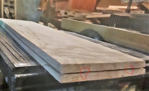

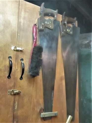

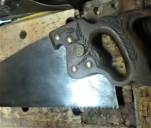

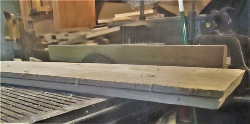

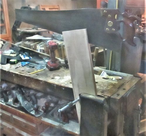

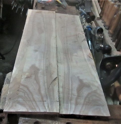

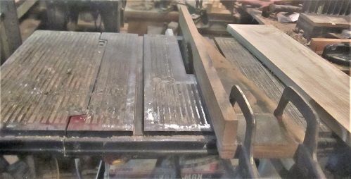

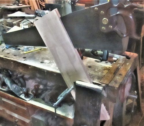

September 20, 20215 yr Popular Post comment_271461 Well, I did have a slab of Ash left over from the Tool Chest build... Too big for a box project, too small for much else. But, IF I can resaw this down a bit...maybe a box could be made? It is laying on the tablesaw because this is how a resaw begins in this shop. I set the rip fence to about center of the board ( 7/8" thick =~3/8"?). Needed to set the blade up almost as high as it could go...without bogging down.. Think of this as a powered kerf saw...where other use a plane that makes a kerf cut to guide a big frame saw...Bandsaw? Ah..nope. Mine leaves more waves than the English North Sea..Goal here is to run a kerf all the way around...keeping the same face to the fence....and hope the board isn't too cupped.. This one was just a hair cupped. at least on this end..the other? Was a little "fun" to hold upright...but wait, there's more....about 3-4" down the center needs sawn...saw blade can't reach THAT deep...and the bandsaw is too narrow of kerf to follow the tablesaw's kerf....so... Something like this. Leg vise, aided by that c clamp...slight angle to help the saw. The saw? A Disston D8, 5-1/2 ppi, 28" long RIP saw. Olde School. If one buys 28" of saw blade, one is expected to USE 28" of saw blade....so, after 5 minutes of saw work.. Got this far. Goal is to get as close to the top of the bench, flip the board over and saw down from the other end...started to bind a bit here..we have ways. Nothing fancy... Just some 1/4" scrap plywood..that other saw laying there? Disston D-112, 7 ppi, 26" handsaw...some do use it as a rip saw...but... That be more of a cross cut saw...and cuts slower....time to flip things over... I leave the wedge in place...so the leg vise won't close the kerf up too much...this is the start point...3 minutes later... Just syeady, full length strokes, not looking for speed, just making sure the saw tracked with the kerf....again, started to bind a bit...need a wedge.. Wasn't very much longer, a minute or two...then a "pop". Note all the saw dust? Got the saw out of the board, went to hang it up, out of the way....it bounced back down onto my arm.. Ow! Saw WAS going to get hung up! Along with the crosscut saw...as for the slabs? Not quite a book match? Waiting on a plane to flatten and smooth these 2....then we'll see what happens. This small board has been kerfed, and waiting it's turn....may leave that angled end? Maybe a "Salt Box" set of ends? grain is running the wrong way... And...that is how I resaw here in the shop....thanks for looking in... Report
