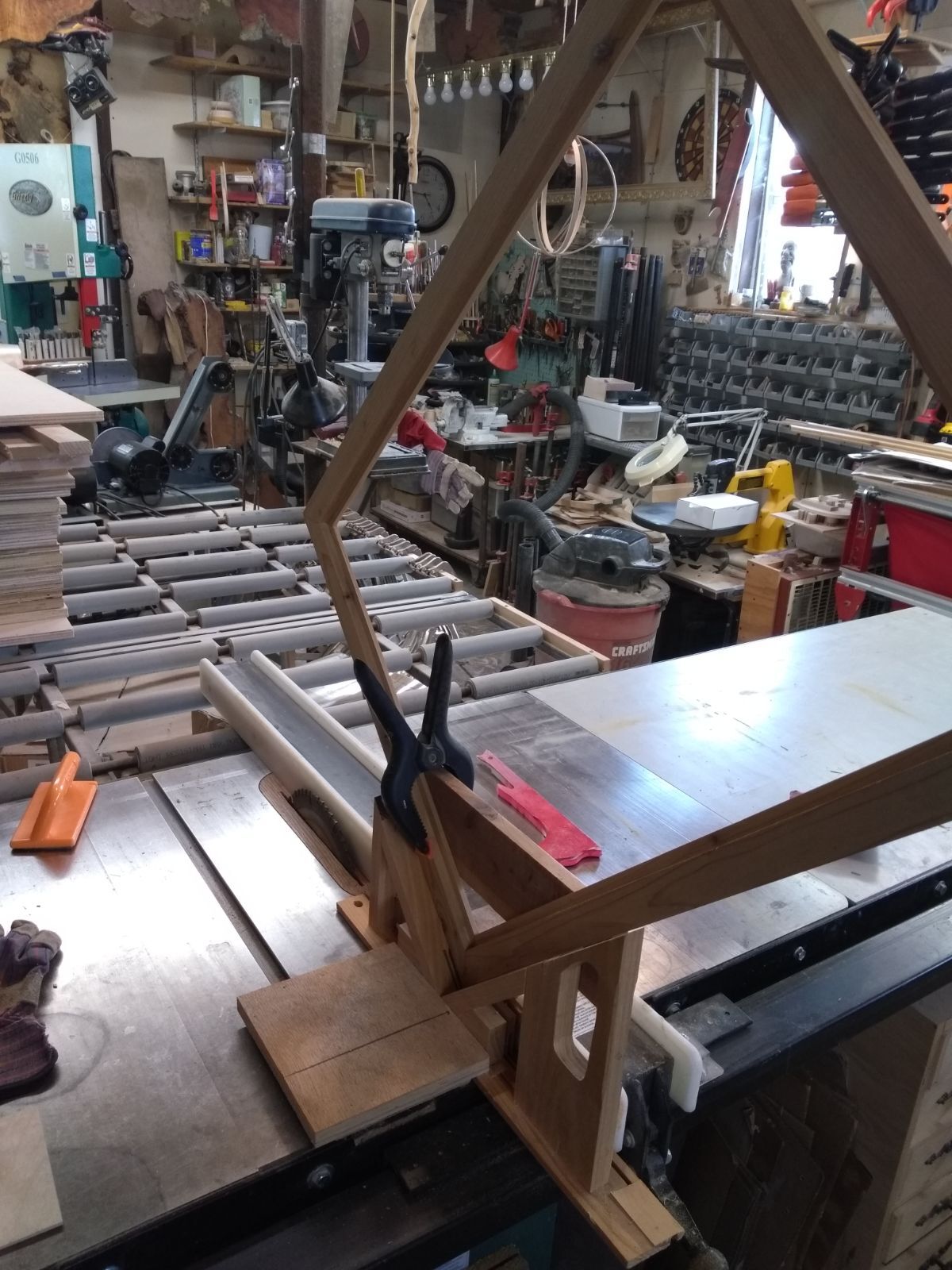

Or you can keep changing blades until you get the exact width you will need...This is more or less what I did then I only use that blade only for the corner cuts.629282640_IMG_20200206_100648345cuttingslotsincornersofframes.jpg.6b4528e71a9bfb1d4ff58cae190fcb5c.jpg
I glue these frames up using four corner clamps and its just end grain to end grain glued but after it dries it will stayed glued until I can gets the gaps cut in each corner  and marking where the scroll saw will cut me some slot fillers. I do mark the bb as up so it will end up glued in to the slot in the up positions.
  Then the small strips I cut out of the back of the frame is used with the 23 gage pin nailer to hold the stained glass or what ever I built the frame for...These pieces will be too long to start. I can cut a frame from stock wood and have it ready to glue up in about a half hour. And I have made the strips to attach the pictures back in the frame instead of going to buy something.
 Once I get the 4 pieces of wood in the clamps and before any glue is applied I can check with a framing square to make sure the the corners are 45 degrees and can take out any one side, apply the glue retighten the clamps and check to see if things have not slipped out of where I want to to set up with the glue. Two clamps are always still tight so the three pieces of the frame should still check 45 degrees. As long as as opposing side are exactly the same length your frame will glue up like it is supposed to...
  When I first rip the wood to the width of the frame and before I do any miter sawing I saw out the area in each piece of wood where the picture will go and it ends up being about 5/16" square. Its never exact for this is not critical as to the size so eye ball is good enough.
   Then, and this is important to cut the first miter with the gap down on the table for the other end of that piece of frame you will size the correct length then the other end of the miter will be cut with the back of the frame in the up direction. The reason for the first angle to be sawn with the gap for the picture is facing down.. You are not cutting for length on this one but the other will always be where you can see the mark where you want the saw blade to go on....
  The gap down means the sawed out piece of the frame will always be down for the very first angle sawn on all 4 pieces of the frame.
 This won't take very many frames to realize why.
Remember make opposing sides the same length and for a square frame all 4 sides are exactly the same length.
