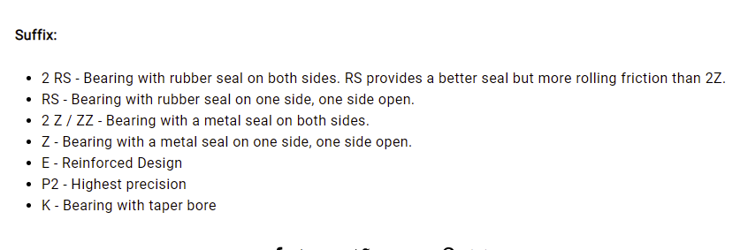

May 27, 20215 yr Popular Post comment_266237 23 hours ago, Gene Howe said: Cal, my advice would be to sit down to pee. Trust me - that thought crossed my mind! I did add to my knowledge base yesterday while ordering the bearings. One of the bearings removed was a 6101 RU. The RU doesn't mean anything today, ordered a 6101-ZZ, which will be an upgrade with seals on each side. The second bearing was a 6202 Z. Fortunately the Timken catalog had not only descriptions and size diagrams, but pictures to boot. A simple 6202-Z would not work, needed a 6202-ZZ-NR. The NR indicates it has an outer groove and snap ring. This bearing keeps everything in check with snap rings on the shaft to hold it in place and the outer snap ring to keep the shaft from wandering. I did upgrade to the double seal ZZ. Likely Gunny and Dan were already aware of changes in the bearing identification system over the years - but for the rest of us, be advised that if the machine is older the bearing ID numbers may be a bit diffferent. While the bearings were a bit expensive, the machine (A Reliant) has been a good one and I cannot begin to replace it for the cost of these bearings. I have had it a good many years and have done a heap of sanding with it. I have the shaft cleaned up, and a new belt at the auto supply today. Bearings should be here next week and we'll be back in business Report
