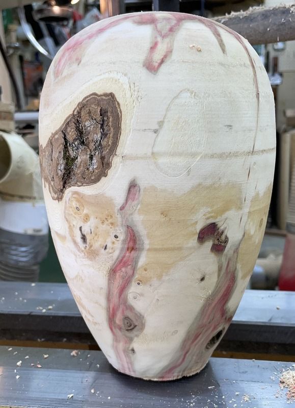

First tall form in a while, W.I.P.

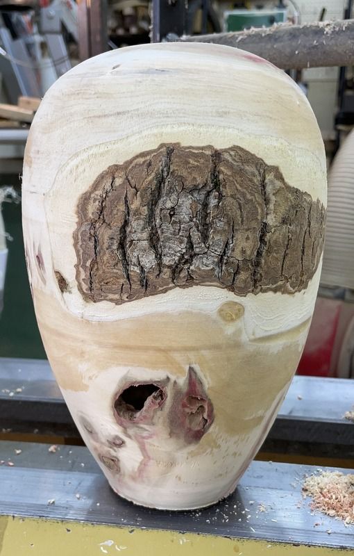

I've got a pretty special piece of wood on my lathe this morning. Funny, it's been laying outside my shop since last fall and I almost threw in the fire pit. Cut a chunk off this morning and decided to do a little hollow form. Was very surprised by the ambrosia.ambrosia1.jpg.09b457fbf65836a0aeb62111502c526a.jpg
It's near final shape but not quite there. I had stepped back several times and thought it was pretty good. But there is nothing like a picture to let a person really see. I can see it's a little fat at about center and I'll address that for sure. If I don't blow this up or go through the side it's going to be special I think. About 9" tall and around 6" major diameter. I'll leave as much bark as I can, I think it'll be a nice contrast to the color.
Looking good.  Never thought about taking a picture to examine the form.  Great idea.

Well, I got it off the lathe in one piece, actually there are lots of pieces but this is the one I wanted to save, pretty consistently 1/4". Up to the turning Gods now. Really hoping it behaves.
really hoping it behaves
Edited by Steve Krumanaker
5 minutes ago, lew said:
Love the shape! How will you dry it- or was it pretty much dry?
It's very wet, very, I actually had to wipe off my face shield several times it was throwing so much water. It's in a lawn and leaf bag laying on the shop floor. No sealer on it. I'll leave it for a month or two and then take it out and let it dry another bit before sanding and such. I have enough to get two or three more of these out of the log too.
