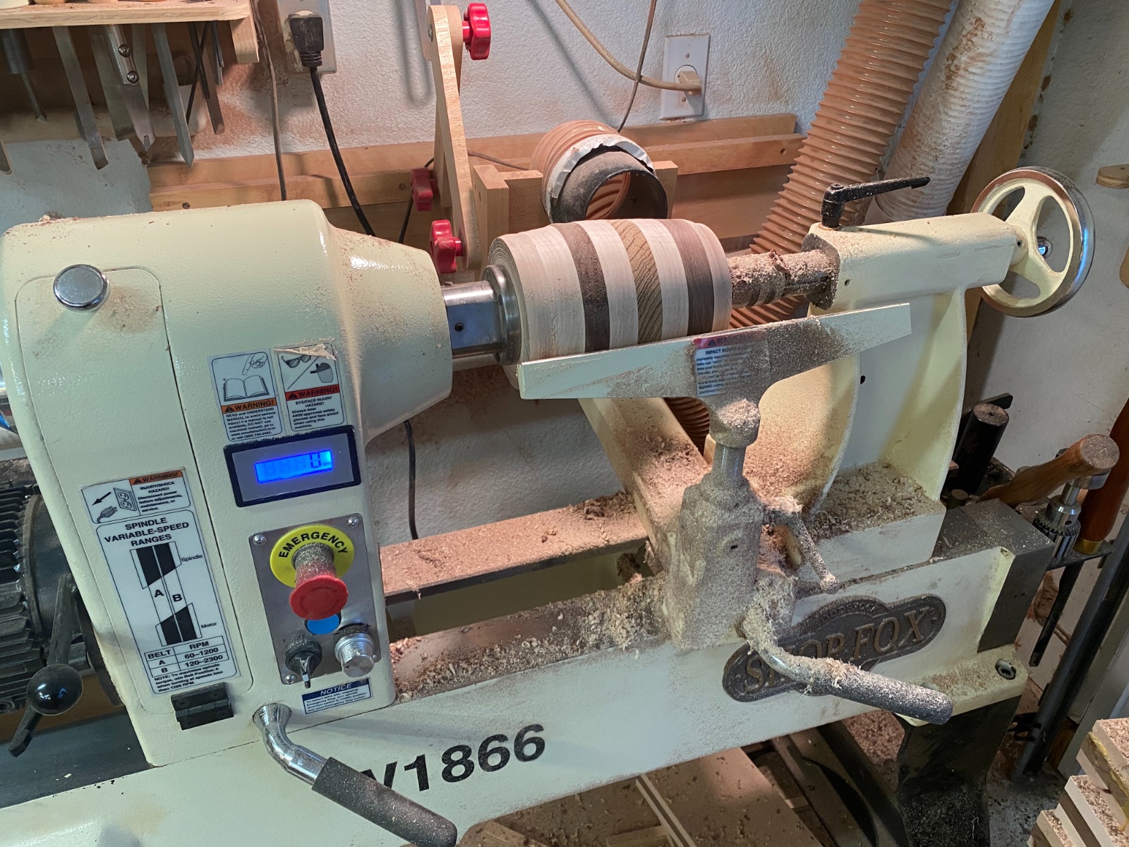

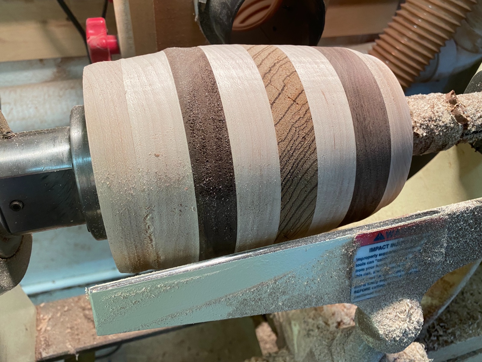

March 5, 20215 yr Popular Post comment_259629 I got bored with the media room so I quit early and do some turning. I’ve had a blank sitting around for a while and I decided to to turn a top for a grandson. Not sure which one yet but I will figure that one out later. Paul Report
March 5, 20215 yr Popular Post comment_259645 They're fun to make and then play with too. Make two so you can play with him. Report
March 6, 20215 yr Popular Post comment_259758 Gonna be a gigantic one there huh? I like to turn tops when we do demos at the MS Ag Museum like this week. With a top the kids will stand and watch. As I turn I color or stripe the bottom and top and ask one or more of those watching what their favorite color is and by doing this personalize the demo. Sold 143 tops at demos like this last year. Report
March 6, 20215 yr Author comment_259826 Probably not going to be that big. The blank is a bunch of scraps I glued up a long time ago. They are fun. Haven’t decided what kind of tip to use on this one. Probably brass. Paul Report

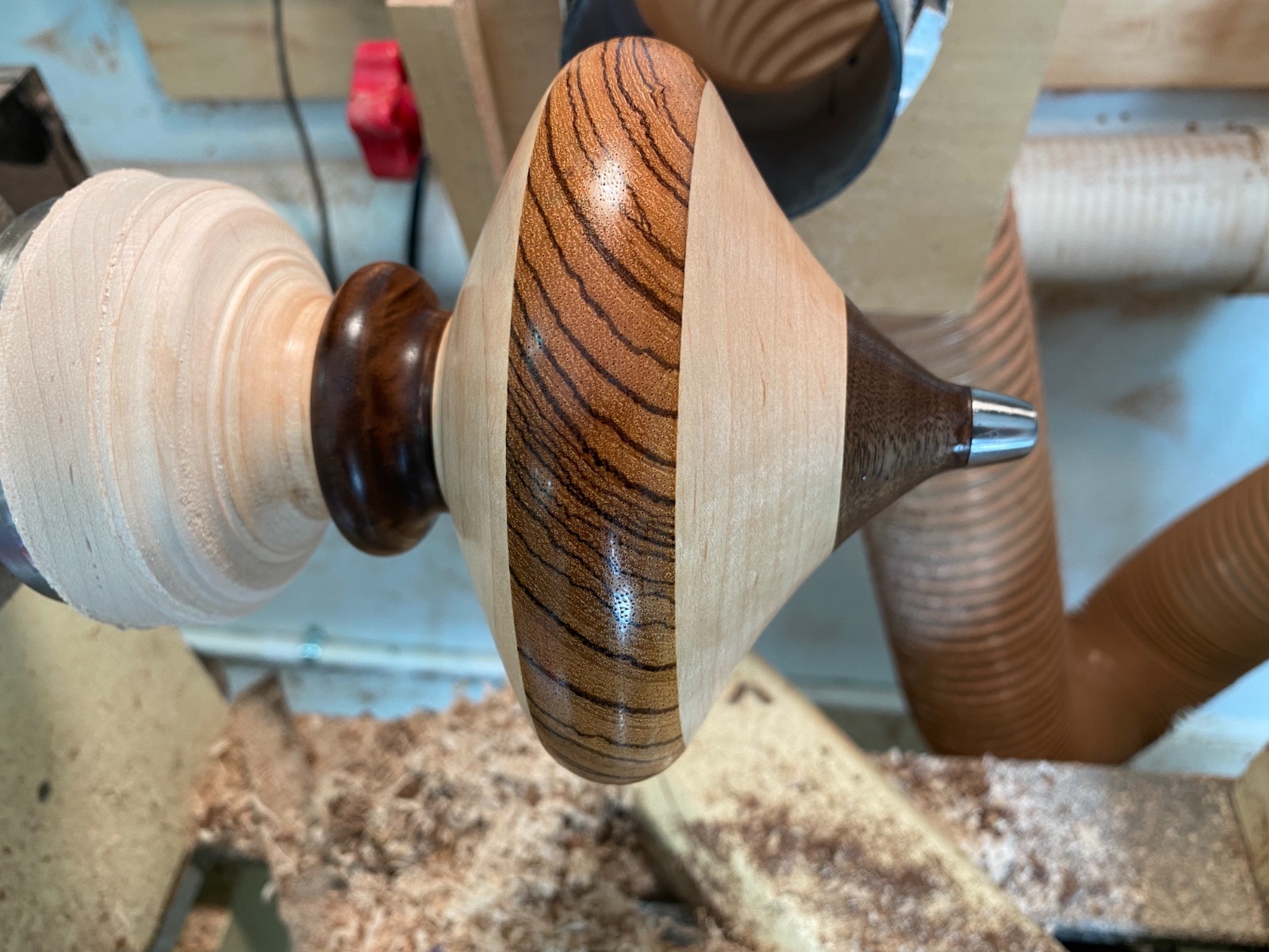

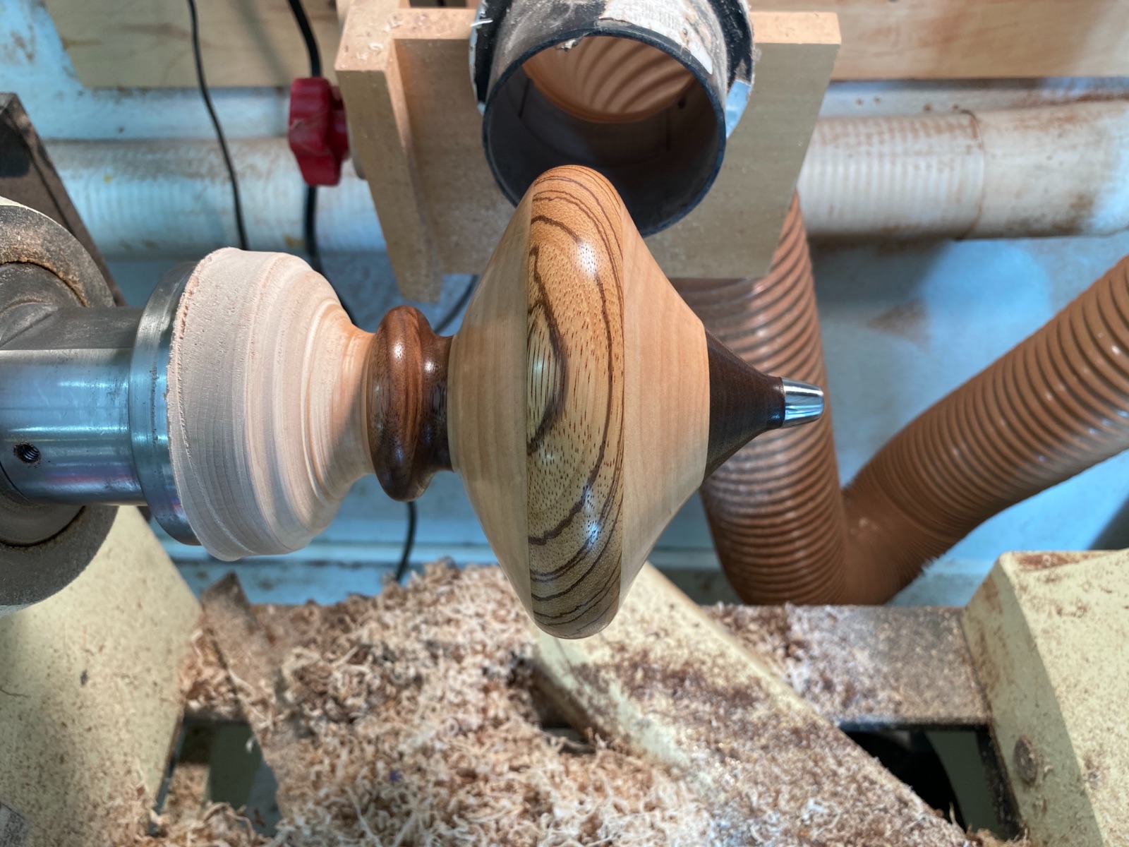

March 8, 20215 yr Author Popular Post comment_259979 Finished it off except for parting it off. I was thinking I would buff the finish but it came out glossy enough. I will let it dry tonight and part it off tomorrow. Paul Report

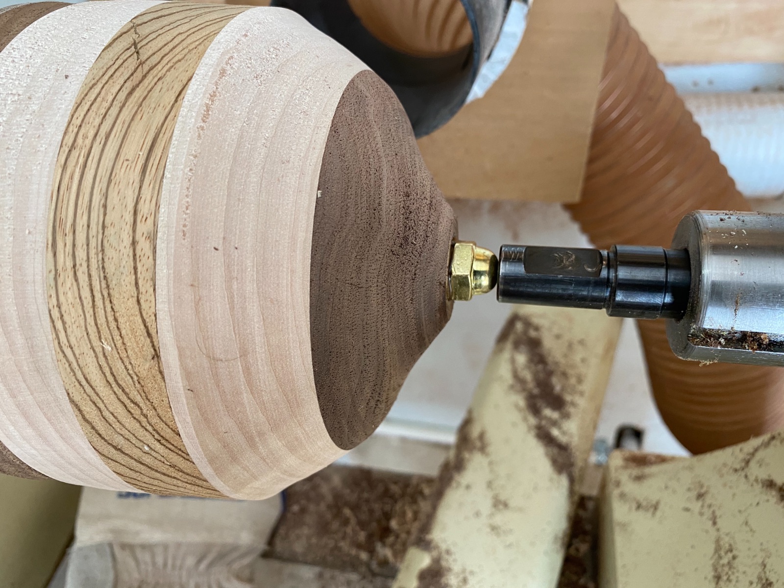

March 8, 20215 yr Author Popular Post comment_260004 The tip is an 3/8” acorn nut on a 3/8” stud that I epoxied into the top and then turned it down to what you see. Paul Report
