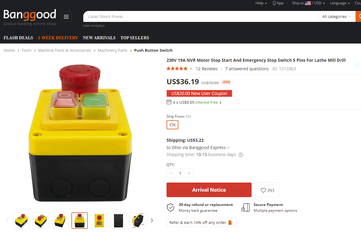

February 20, 20215 yr comment_258602 The Record Power is made in the UK and I wonder how accessible parts and service might be. Remote switches can be bought and wired for any lathe. Report
