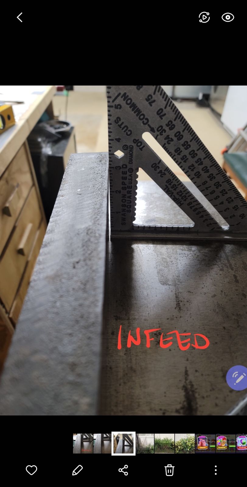

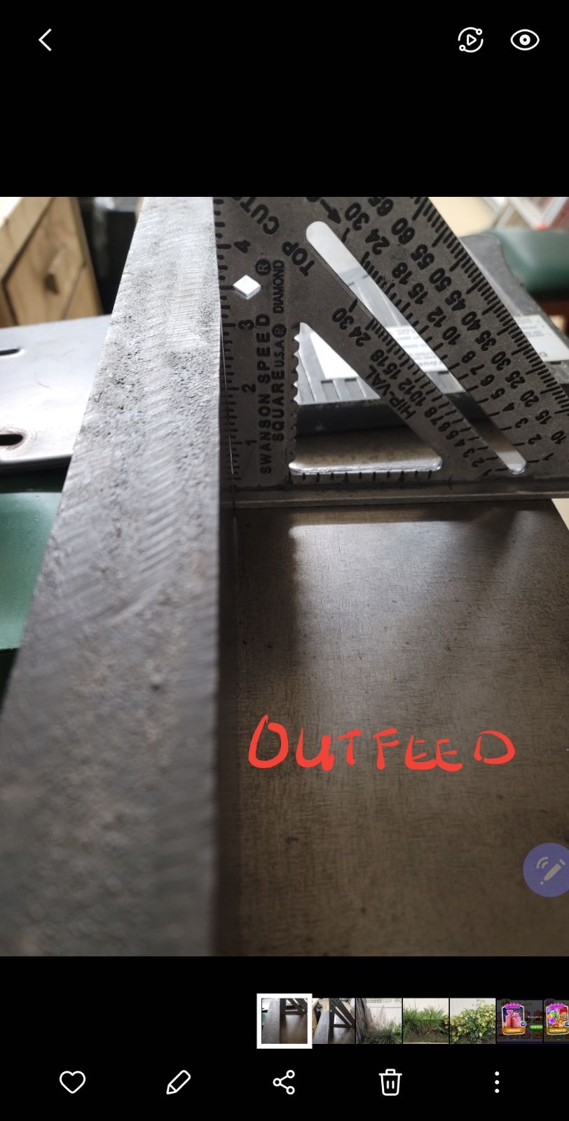

Ok so bI picked up a Craftsman 11320680 jointer that v really needed to be cleaned up.  I  removed the fence and cleaned everything up,  replaced the blades.
When I remounted the fence it is square to the outfieed table but is out about a 1/32 or so to the infeed table.   The bottom of the fence needs to come in some on that side. Having issues getting the bottom of the fence on the infeed side to move in some without throwing out the outfieed side.
Any help would be greatly appreciated.

It’s possible it’s not the fence but rather the infeed table that is not aligned. Check to see if the fence is straight, flat and no twist. If the fence is okay, use a straight edge to check the orientation of the outfeed table to the infeed table. Both tables should be parallel and coplanar across their widths
Lew is right on.. Both the infeed and outfeed should be set parallel to each other then the fence can be set
Thanks I will try and check this out this afternoon
