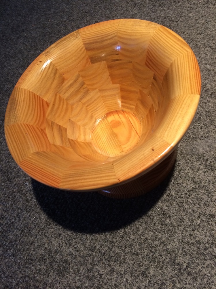

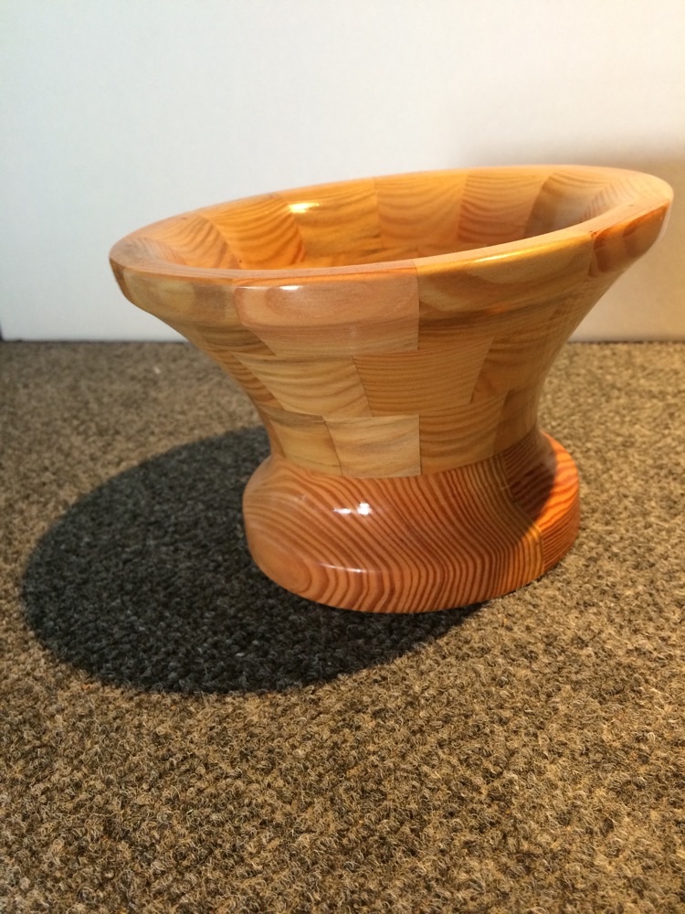

What kind of glue was it ? I’ve turned Douglas fir and it can have some pretty grain structure but it needs to be flat to produce a good glue joint.
