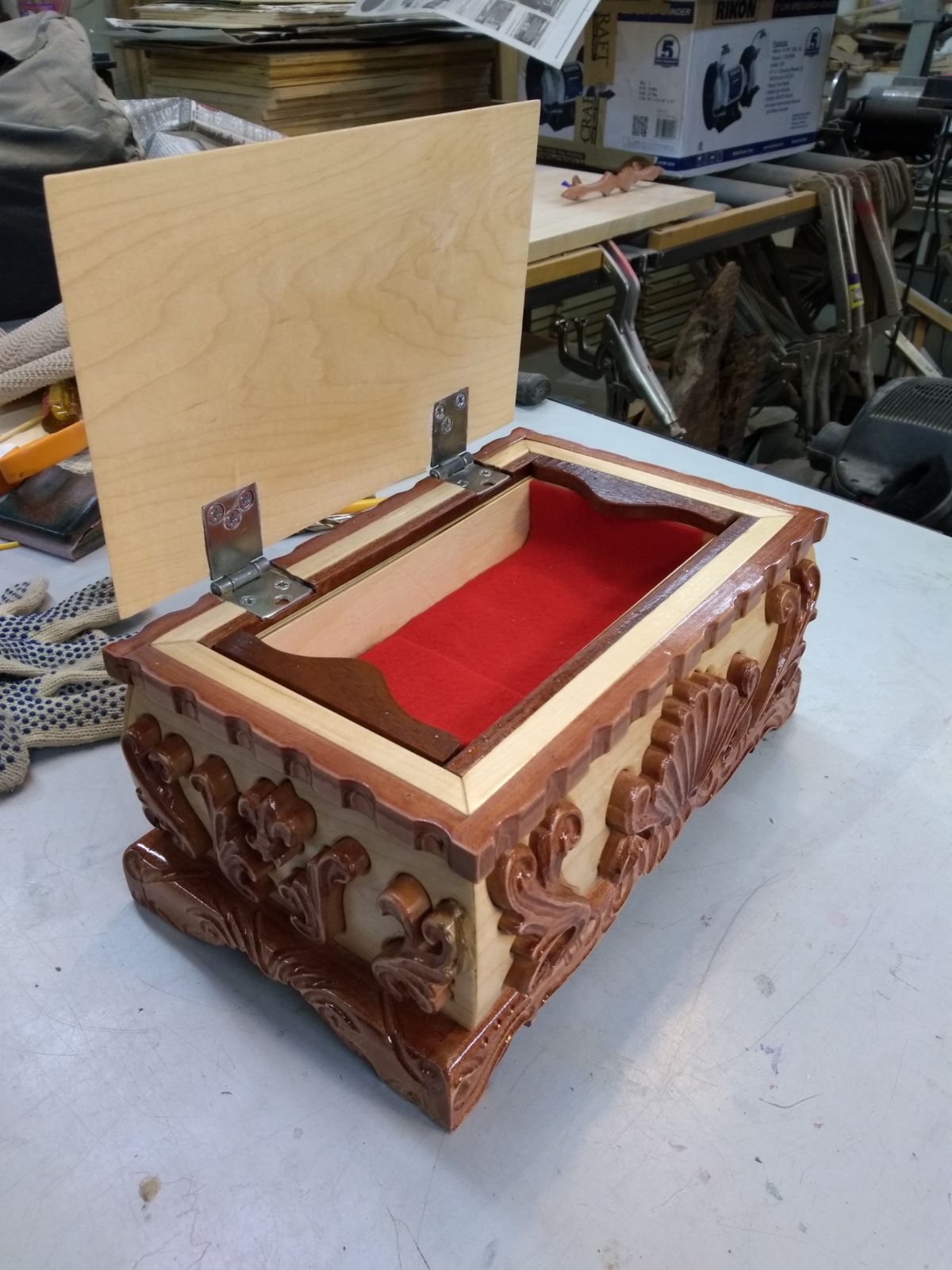

February 5, 20215 yr Popular Post comment_257195 I'm still working on these jewelry boxes. There are lots of first time things going on with these boxes for sure..This box was the goat so I have a few things I wanted to see for my self. I had nothing on paper just in my head. It is sitting there with 4 screws holding all the pieces together so I could exchange things and then put it all back together. In a round about way this is almost like the rest of the carving I do. Like I have different carvings , some up and others down and one end is different that the other. Some of the pieces was in the wood pile from things I built from long ago....Like the handle on the top was the cut off sides from two pieces and I just glued them together back to back and I ended up with about the right length handle for the top. The brown base is four small pieces glued together and the brown top piece is four small pieces glued together and those are holding it all together or else the box would fall apart... I learned not the have the carvings too close to the ends for the wood is tapered 45 degrees and would cause problem later...These mistakes will stay with this box for a reminder for later..al the carving pieces was my own design and they will be pushed out more for the finished product.... and I still can't decide which way the carving should be , right side up or up side down? And since I tapered the lid, hinges and the screws that close to the edge might be a problem? Also I don't have to worry about ever seeing another box exactly like this for no one has a weird brain like mine! Report

February 7, 20215 yr comment_257342 On 2/5/2021 at 6:43 PM, Masonsailor said: Those are amazing ! Wow Paul Beautiful work, too. I wouldn't hinge the lid. A flat piece on the underside of the lid to keep it aligned would allow it to be lifted off with the top handle. Who is going to be the lucky recipient of this latest piece of art? Report

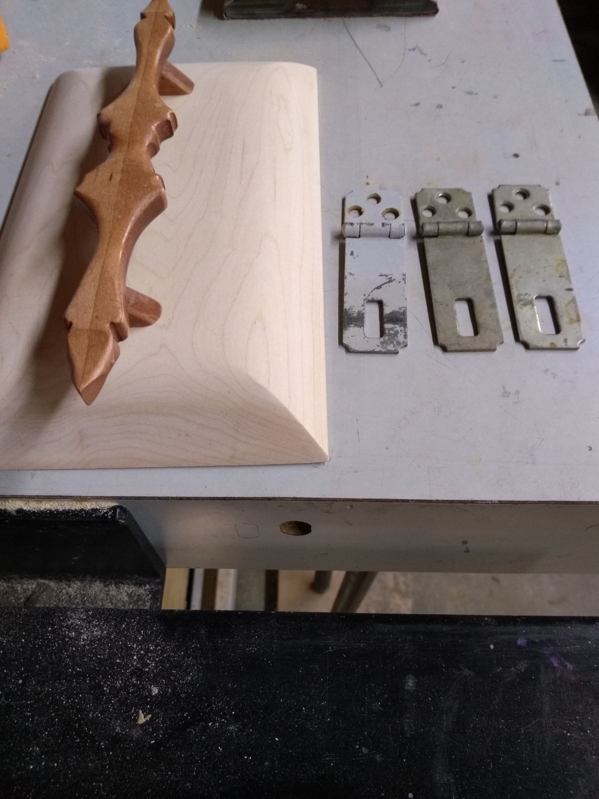

February 9, 20215 yr Author comment_257577 I hope it stays in this house. Gene the hinges started being cut in yesterday and I had to make the hinges out of a couple of old hasp as I needed one side sticking out past the curve down on the lid.. See the precision hole drilling? A living proof there is no cnc in my shop. I have a ton of old hinges and drawer pulls and old wooden swivel wheel casters I replaced while in the furniture repair refinish business and lots of that stuff like these hinges I change to fit my needs.. I like to think I can do it all in this shop with what I have learned over the years. Also the handle on the lid is not glued down. It has a dowel through the pieces so I can spray it then assemble. Report
February 9, 20215 yr Author comment_257578 Gene with no hinges would be the easy way out but my way of thinking a loose lid especially with the long handle on top would be needing some repairs in the future as the finish will make it even slicker than just the piece of maple wood. Those tile floors I'm sure would not get hurt but I'm afraid the box might end up in the closet.... more of that past experience trying to guide me now! Report
February 9, 20215 yr comment_257591 With a gorgeous handle on the top like yours, hinges would almost guarantee that it'll get dinged against the table, or whatever else it could hit when opened. Unless, of course, you use those expensive stop hinges. Edited February 9, 20215 yr by Gene Howe Report

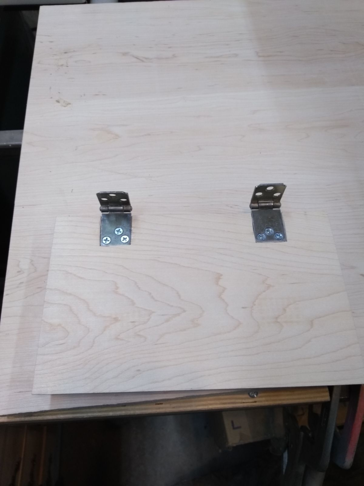

February 12, 20215 yr Author comment_257831 You might not believe me when I say I missed drilled those holes in the hinges but it is very important once I drill the holes in the wood before I take the hinges off to spray the finish to be dead sure which hinge goes back on which side...and when using hinges that already have the holes drilled to use a marker to identify what goes where even though it really don't matter with factory drilled holes. I like to use the brown bottle of Aleene's glue for gluing the felt down for it seems to work better with a little longer set up time and don't seep through the felt before it does set up and it stays where I put it. I also use an old credit card or those door keys to the motels to get the right thickness. I also cut all the pieces of felt before I start installing them. I am sure glad I insulated the 20 x 30 foot section of my shop with all I could stuff in the 6" thick walls and this morning it was right at 50 degrees when I walked in and outside it was 27 ... the concrete floor is much better holding the heat in than a raised wood floor. The 4" purlins I used to start with presented a problem but I slit 2 x 6's into 3 strips then screwed them vertical every 16" then used osb or particle board ? to cover the insulation. Thick solid sheets of foam I sand witched in between particle boards for the ceiling. Since this area is not used to minus degree weather I am sure a lot of plumbers will get a lot of attention Monday and Tuesday for it is forecast to be there. Just like folks are not use to freezing weather on the highways here and a few folks done went to the happy hunting grounds...in the Dallas Fort Worth areas. Report
