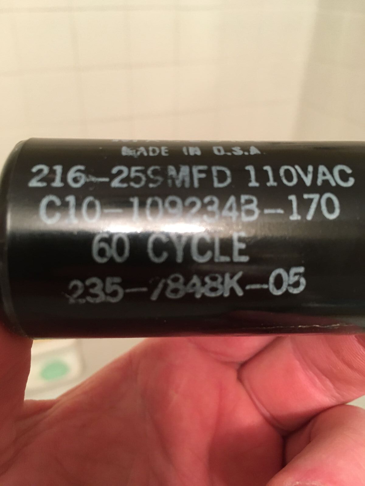

Thanks for the advice.  After doing a utube search I'm sure what I have now is a bad capacitor.  Mine makes an ominous buzz for a couple seconds and then blows the house breaker just like in the video.  Wonder if I could get it straight off ebay or amazon.  I've been putting in the numbers on the capacitor but I'm not sure if I've found the right replacement yet.  It says MALLORY just above that writing.

This should hook you up.  $12.50  not bad at all.
Start capacitor

Oh I see...nameplate.  It's a Craftsman 10".  Not sure of the model number though.  I was able to get the capacitor out of the motor so I'll just match the numbers for a replacement.
Well, lesson learned is if it walks like a bad capacitor and talks like a bad capacitor, it very well could be a bad centrifugal start switch...and that's what it turned out to be.  After getting the new cap in it did the same growl no start and after getting it all apart and cleaning the switch it starts like a dream.  Well almost, I have a replacement bearing on the way but after that this 30+ year old motor should run like new.  Thanks for all the direction guys.
