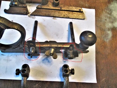

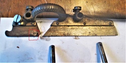

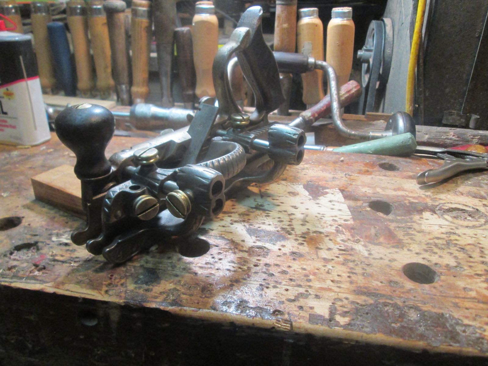

January 26, 20215 yr Popular Post comment_256105 Ebay find...a Type 3 Stanley No. 45......$36 + Tax + S&H....$52..arrived here last week....Last Friday, though...I had a trip to see about a leaky blood vessel in my head... So, finally got back home today. New meds, got rid of some others.....smallish Stroke. Still worn out and sore....may take a few days to get back to "normal".... Any...seems this plane will need a lot of cleaning up.. 99% of the black Japanning is ...gone. Wood is in great shape. This is supposed to be all black, except for the raised boss where the fence will rub, and those BRASS bolts.. Same here, skate needs shined up, Brass needs cleaned up, the rest needs black coloured.. Those rods need cleaned up. They thread into the main stock. Wingnuts need cleaned up. Wood could use some soap, and a new finish... Might take a day or two.....will give me some time to find a few cutters, too...until then, I can "borrow" a few from the Type 20 I already have. Stay tuned.... Report

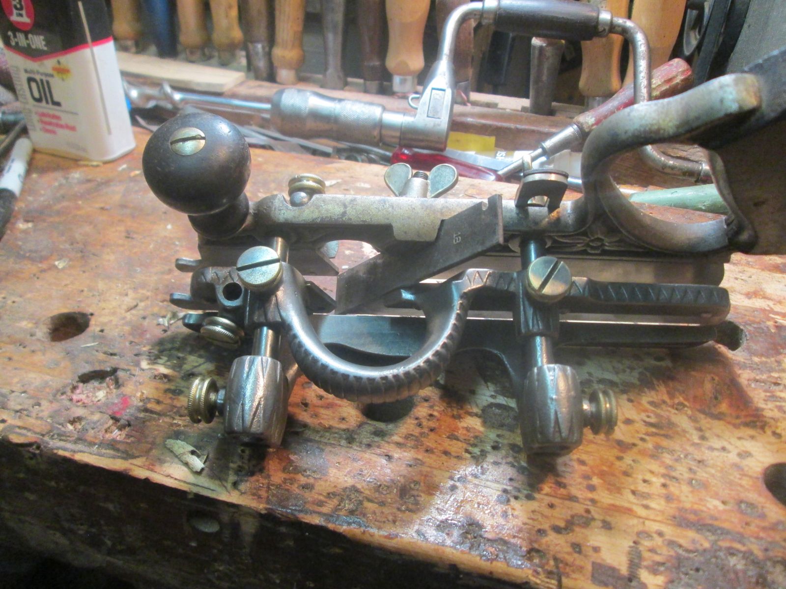

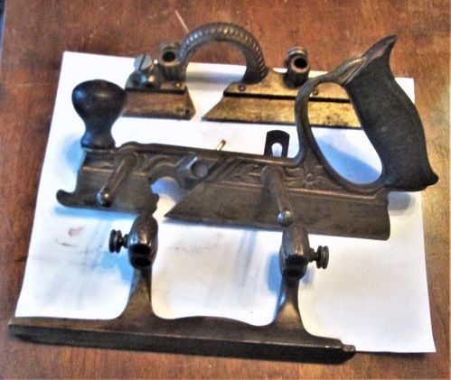

January 27, 20215 yr Author Popular Post comment_256165 Problem is....NOW I'll need to build a box/case for this new to me plane.....not enough room to stick it in with the other Stanley #45.... Latest 45 is now cleaned up. Had to change out one spur....was too worn down. Cleaned all the dirt and crud off....plane is actually nickel plated...in other words, it is a Type 4 version....not a type 3....oh well... Patent Date MAR 11 94....1894, that is... have it set up as a 3/4" wide Dado cutter... Report

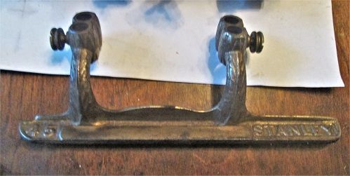

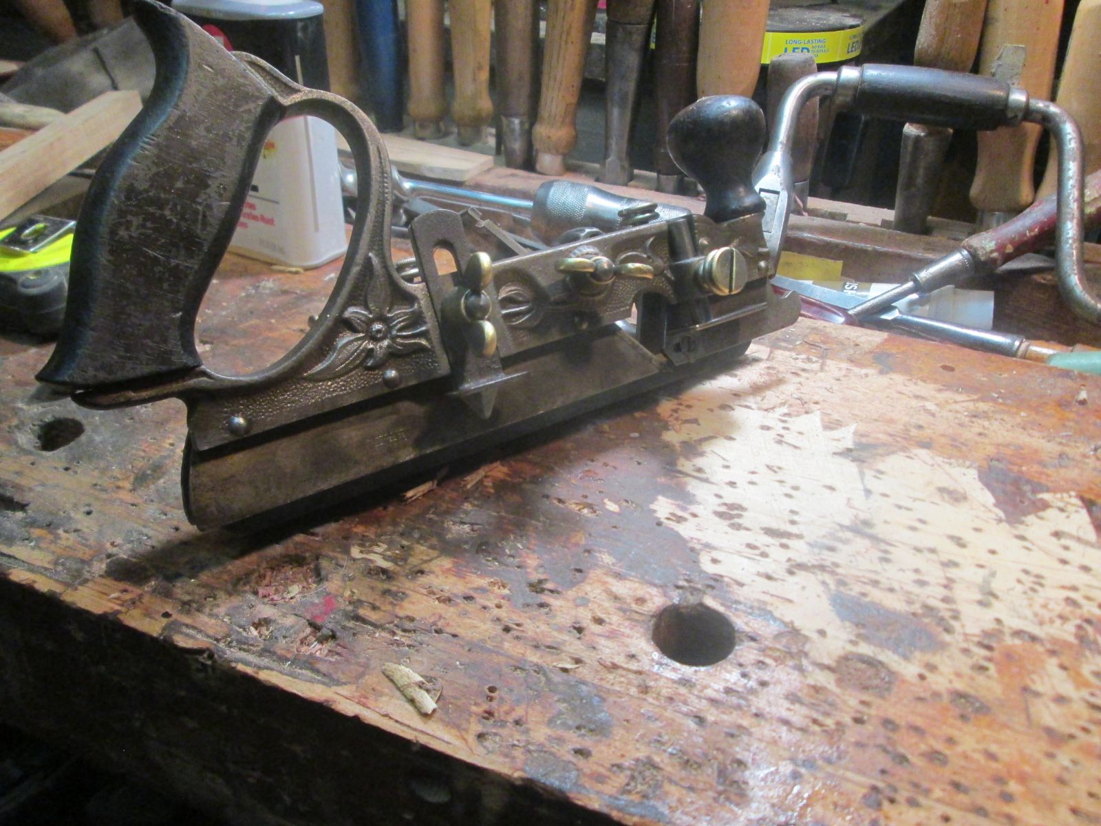

January 27, 20215 yr Author Popular Post comment_256180 Having an issue with these photos....unable to edit them....here we go... Right side, all clean and shiny. ( photos are "write protected"?) Brass hardware is shined up, as well... Left side. Added a 3/4" wide cutter....still missing one depth stop... Top view. "Top of the Line" back in 1894... Report

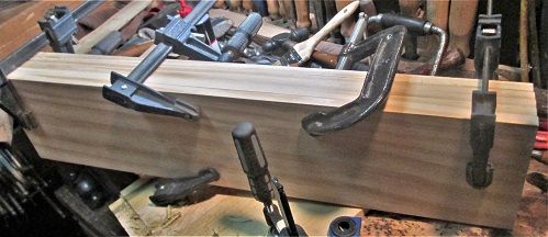

January 27, 20215 yr Author Popular Post comment_256256 Not quite done yet....still have a box/case to build for it... 5 planks, 1/2" x 6" x 24"long....clamped up, and getting used to the weather down in the shop. Will let it sit a few days...while I clean off the bench...again. Trying to decide whether to lift a lid, or make a slider lid...... Stay tuned.. Report
January 27, 20215 yr Popular Post comment_256257 1 minute ago, steven newman said: Trying to decide whether to lift a lid, or make a slider lid...... Thinking lift and lay over the side lid. Report
