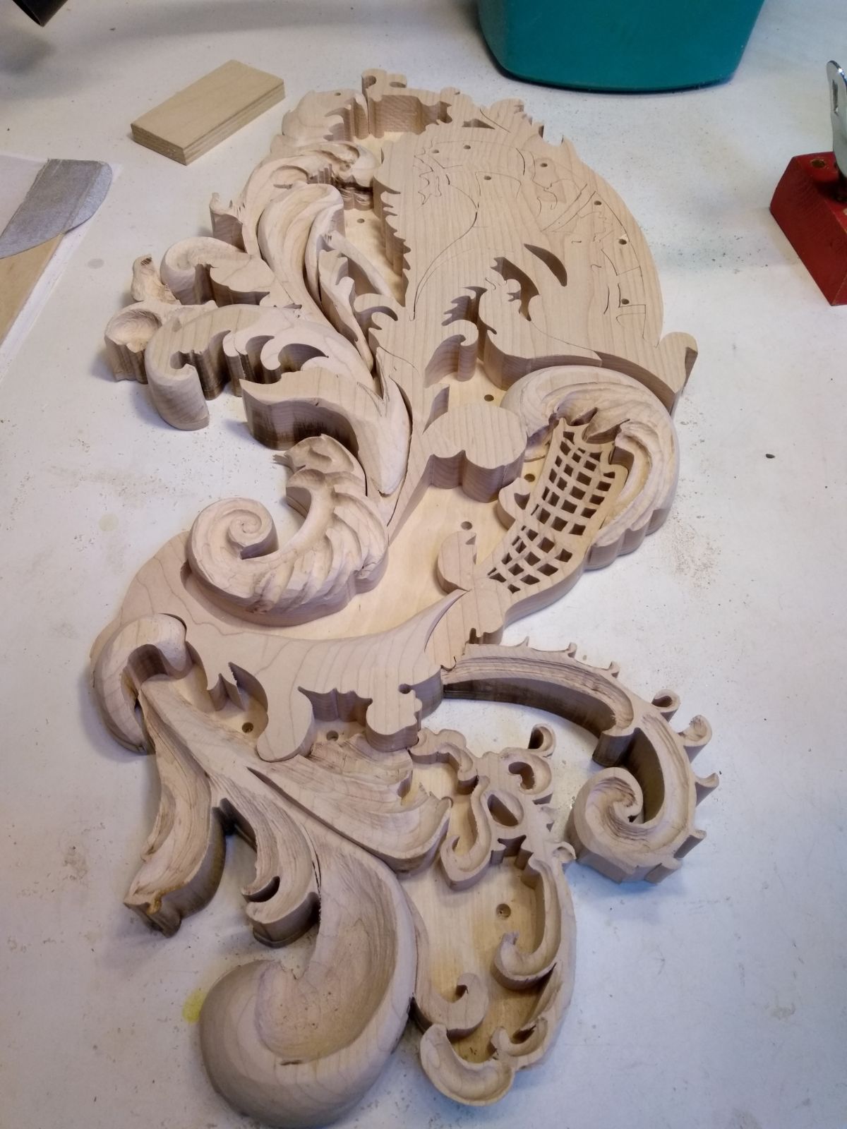

One more picture for Sat,1896854360_IMG_20210123_174617134thirddayonthiscarving.jpg.2a87d774813f5d900019b903c609a09b.jpg
This is what I call ruffing all the pieces in and am about half way in it!
  I enjoy this type of woodworking the most....
Looking good Patch. I like the area that resembles lattice work, I think that's the first time I've seen that in one of your works.
Looks like a great start to another masterpiece. Keep the progress pics coming.

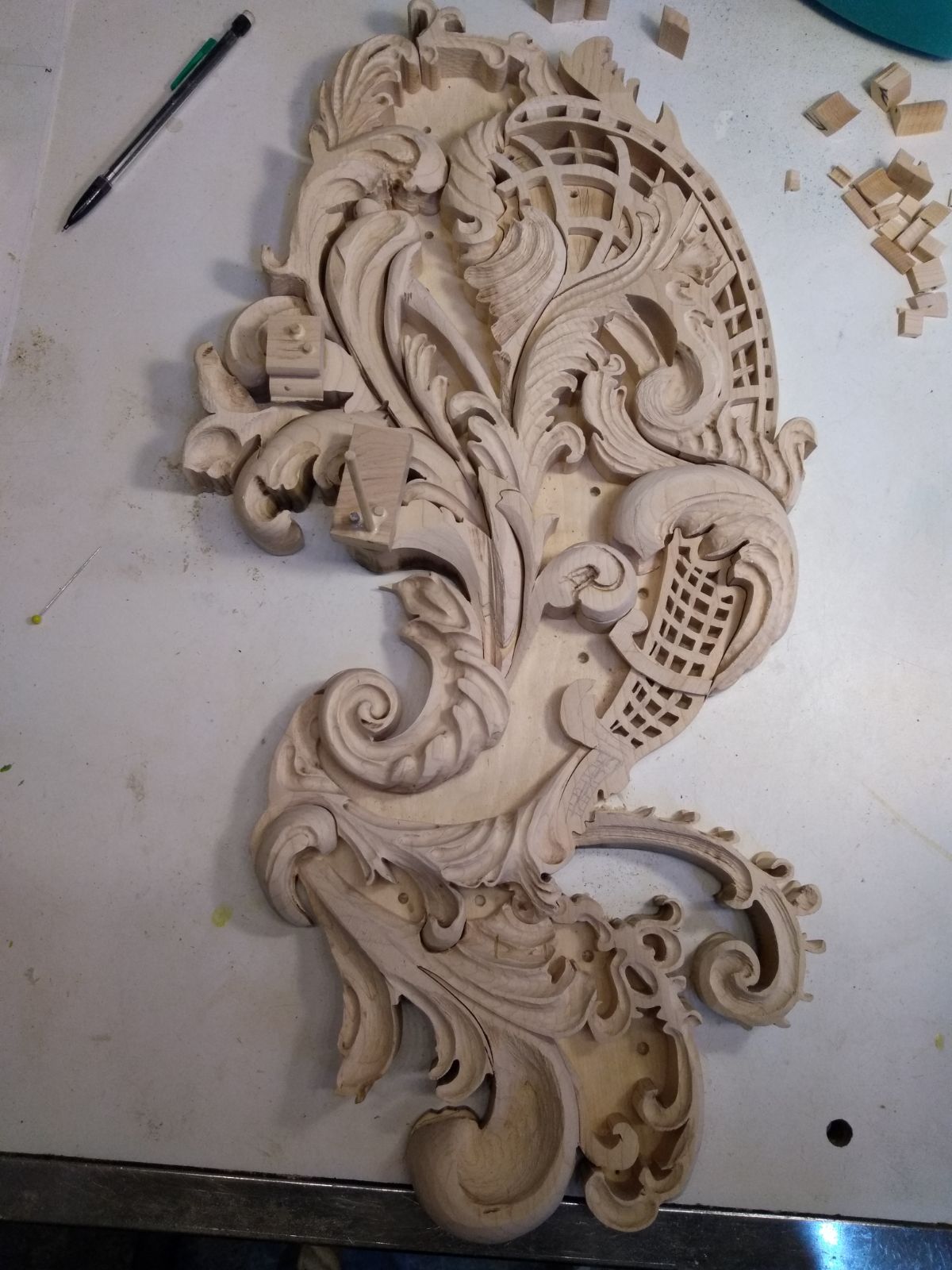

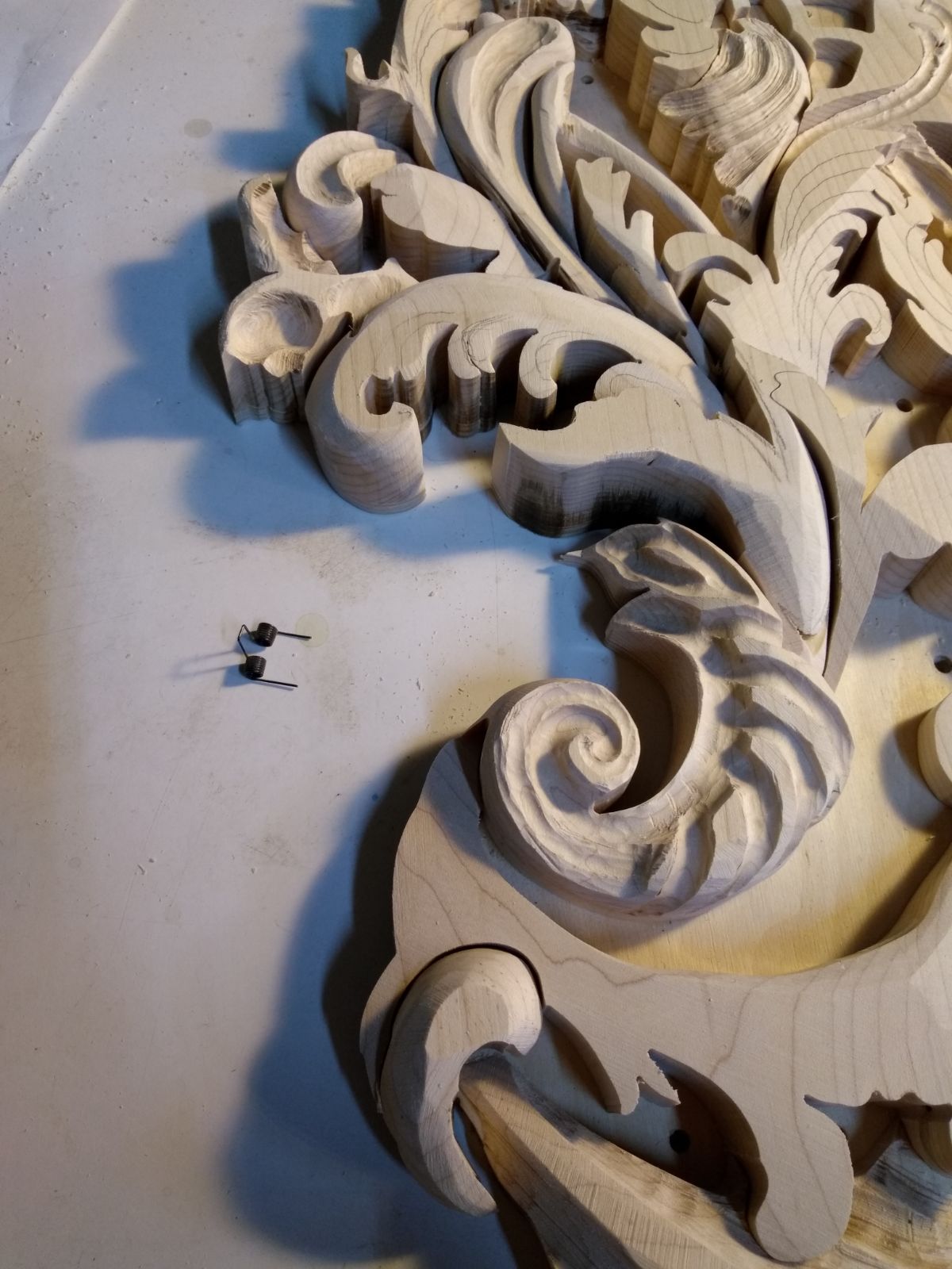

Okay, Sunday noon.1237561415_IMG_20210124_124531059sundaynoon.jpg.554478932ba25ed96a04f6634606cdfc.jpg
Any body seen a spring like this.  It showed up where I'm carving and have no idea where it came from...never seen one like this and might be hard to find another if I figure out where it goes...its in the lower picture... This morning was one of the very few times I cleaned off the work area and it showed up while I was grinding  with a small angle grinder....maybe goes under the trigger of one of the grinders?
   I'm like a kid with a new toy for every time I get a little more ruffing these things in I can't wait to get it in place and see how the picture keeps changing with each new piece in place.626201739_IMG_20210124_124754031sunnoonwithaspringIdontknowwhatitis.jpg.ea84dbc8781f179394edfbf119978302.jpg

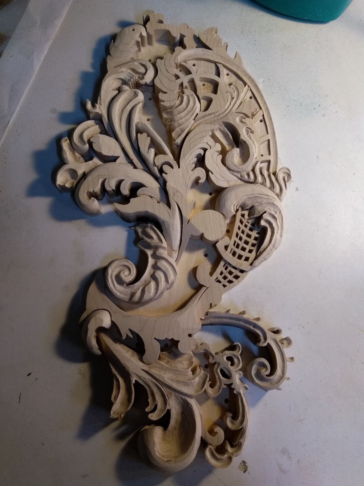

  Tuesday morning.1586873013_IMG_20210126_094020780tuedaymaornig.jpg.3e098fd9fe1fed66c6baefcf5bdbbd2c.jpgI'm starting to add height to some leaves. I'm using some 1/8" dowels but they don't measure the same so I use a number bit that will be a tad larger than the dowel... This is from a number bit set and I use these bits more than regular drill bits..20 sizes from #60 to 80..
 I'm putting two different heights to the mesh screen in the same area in the upper right side and will be a bugger to glue all the pieces in without some glue showing!!!!! Waiting for glue to dry right now.

 That's looking good Jess. The lower area of that mesh looks like it might get a little tedious in there.

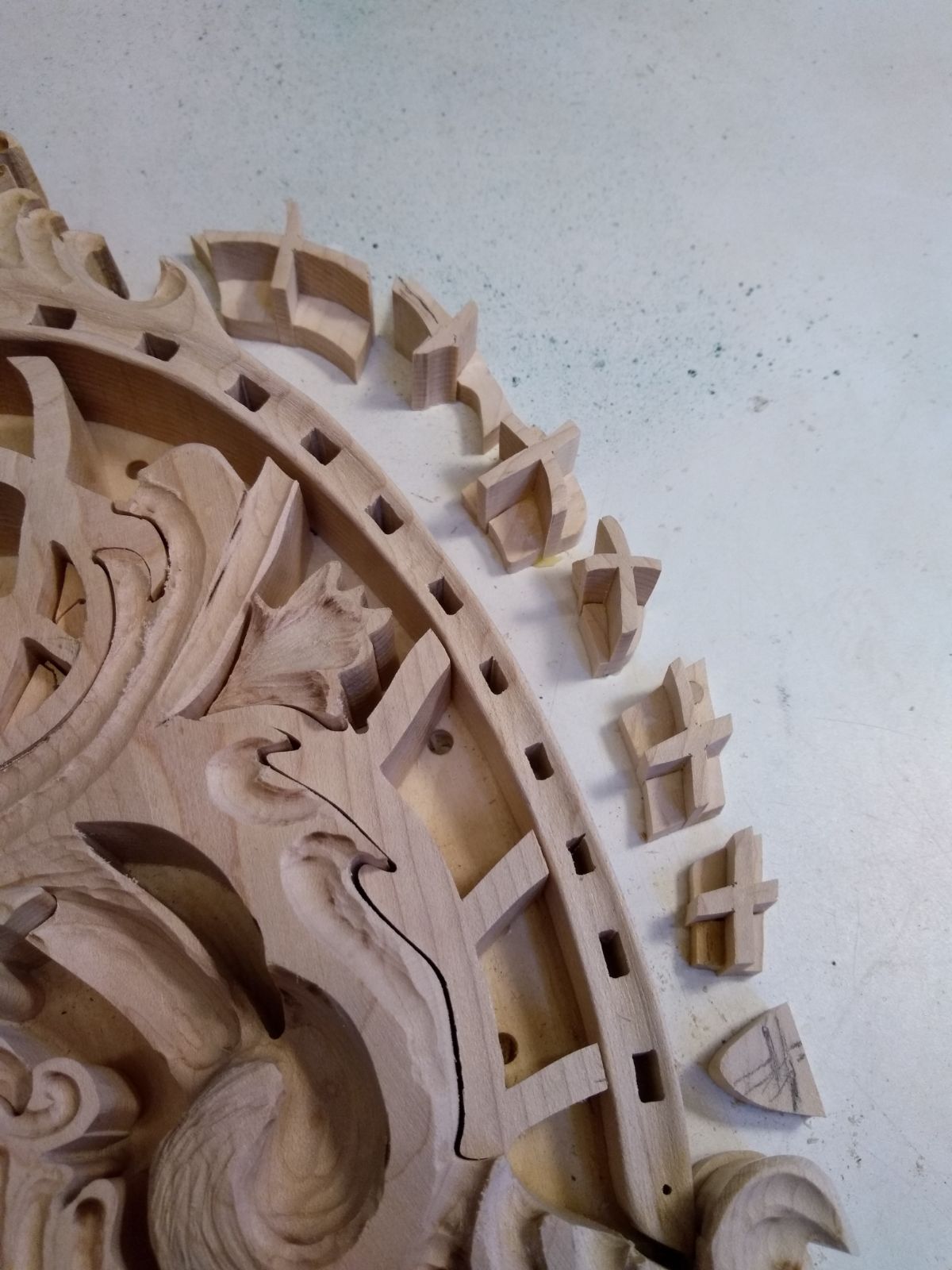

Bob, this is where I use metal cutting blades with the scroll saw. First reason there are no reverse teeth to accidently pull the wood off the table. And the second reason I have metal cutting blades almost so thin you can see through the metal for they are so thin!  I have already cut those last holes and finishing up with the smoothing of the pieces.. Then I like to make sure the pieces are the same height where the pieces are mated up with other pieces 816281877_IMG_20210127_125343033Wednesdaynoon.jpg.a0602a591ae236efec08bfb0ef43ef07.jpg

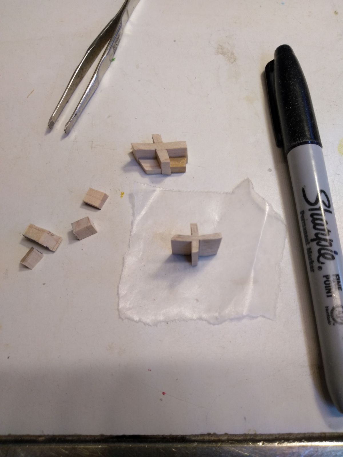

I'm putting the mesh looking stuff two different heights and the bottom sections are five pieces for each piece to be glued up for each hole, and easy to loose a few pieces like the one off color piece in this next picture which don't match the area ... What I do is after I saw out the four pieces leaving the piece in the middle that looks like a cross.. I then take those four pieces a shorten them by cutting off the top sections and the bottom pieces will match up where the came from.2141481228_IMG_20210127_093245047Wednesdaynoon.jpg.c74e1b42add19a36b5852cc01c9a6205.jpg

  If anyone chooses to do some carving in the style I do notice how most pieces I make the small ends or the pieces I choose to grind down lower than the other end of same piece I make the connections in to a V shape so the one piece will stay put and the sawing will hide after the finish goes on. Usually the upper end of all the pieces have counter sunk holes before any of the carving begins so all all the pieces will have a definite place already established.

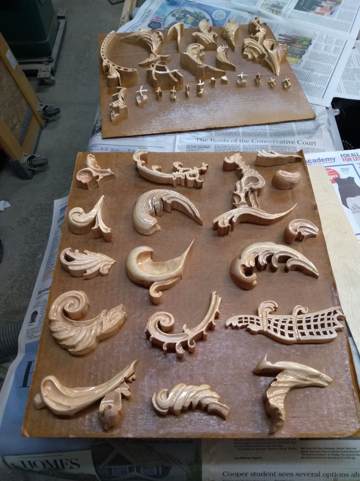

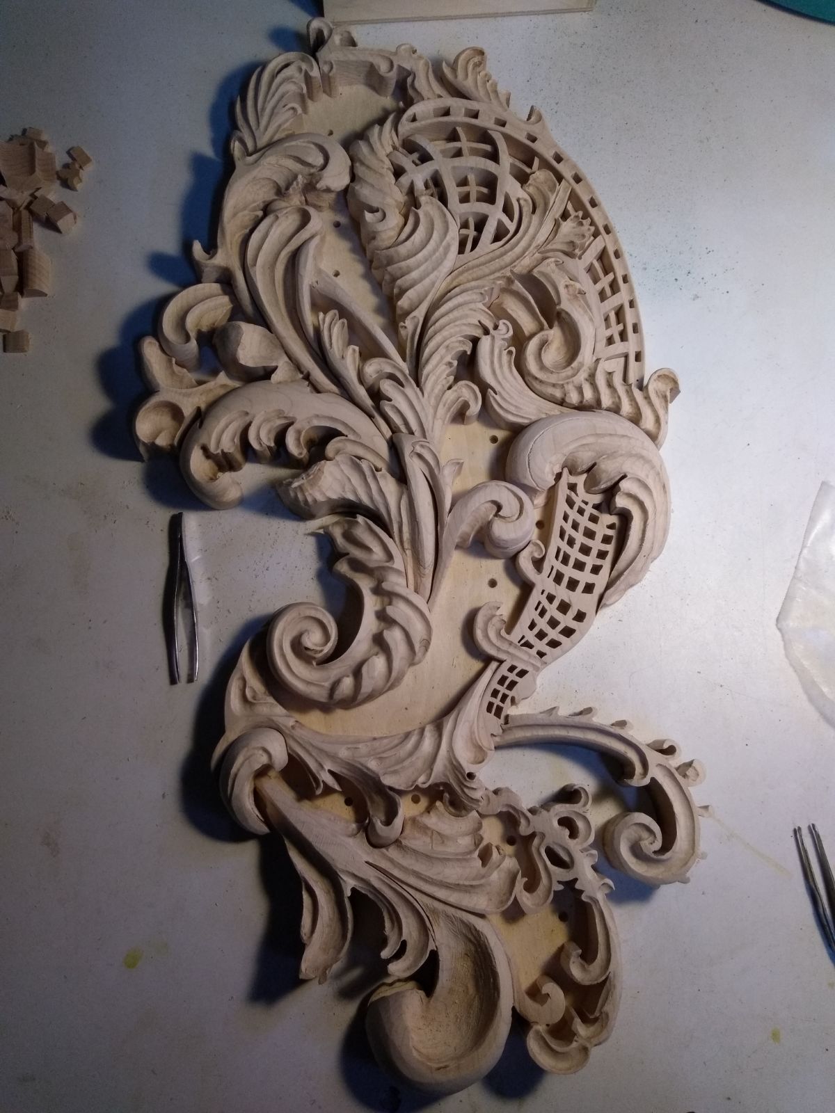

Thursday noon. 1775366033_thursdaynoon.jpg.4c950e5e8f9f8f1c7814758ceb51fdc2.jpgI think I am about finished with the smoothing of the wood.
  These diamond bits do almost all the sanding. I turn the speed down to 2 or 3 on the Dremel and use a circular motion. 1/16" shaft so the diameter of the diameter ball is about 1/4" on down to 1/16" so one has to take his time and let the bits do the work.

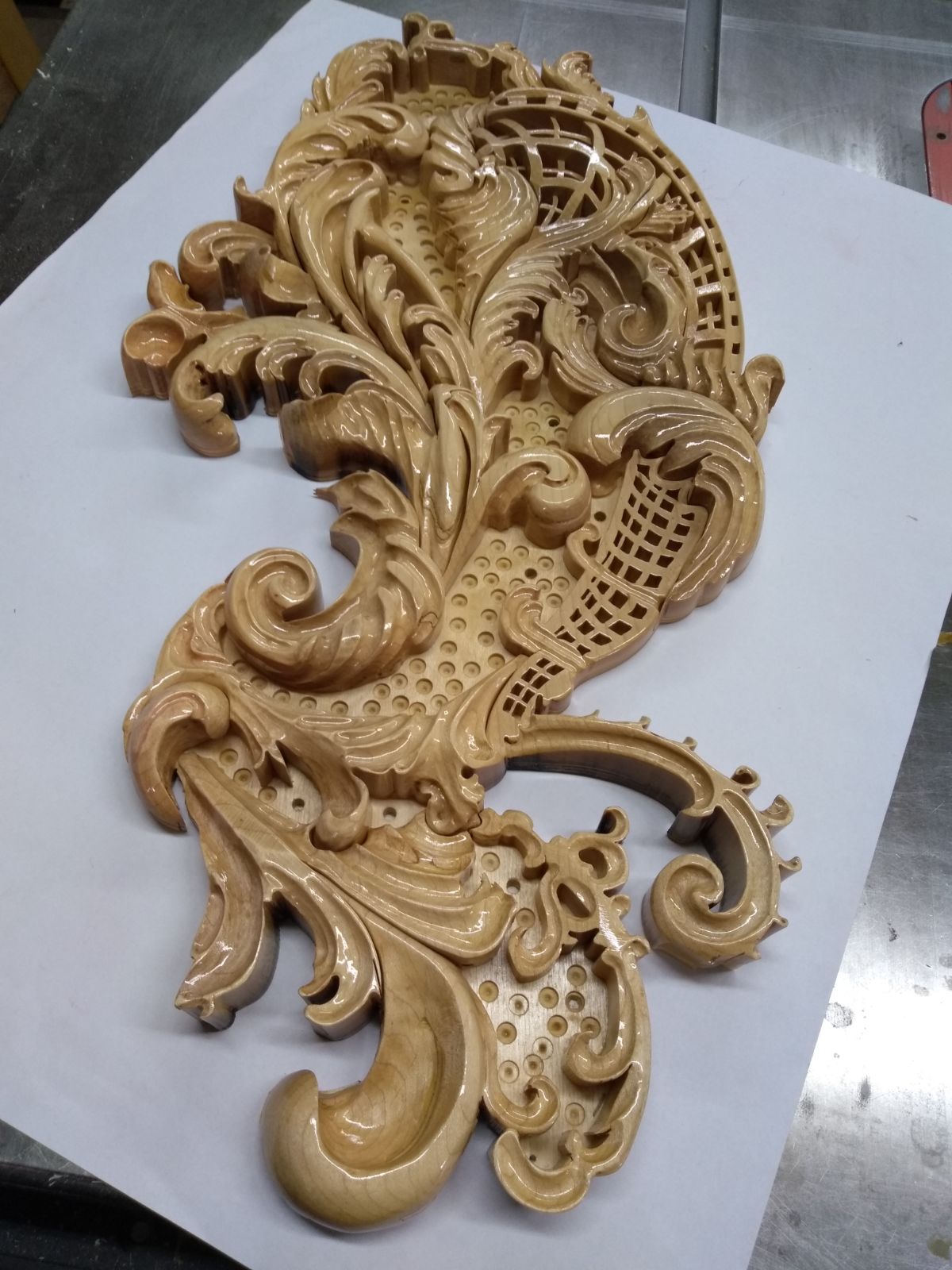

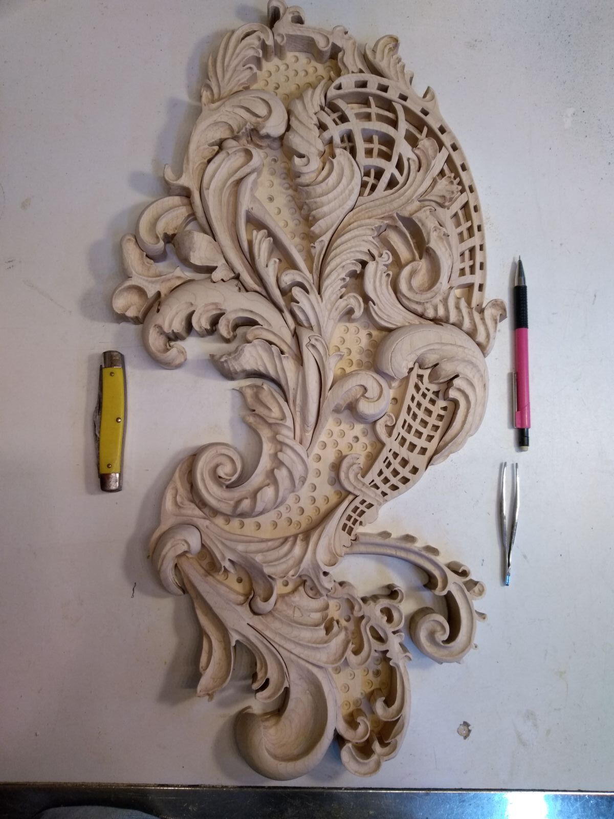

Saturday morning first coat.336067154_IMG_20210130_083912711sundaymorning.jpg.a258c1605f0c1b678d26c8e8f4f84399.jpg

831547267_IMG_20210131_131123021sundaynight.jpg.a8b05daff778b7ea8e41f2a0e78180f0.jpg!
WOW!!!!!!:TwoThumbsUp:
Beautiful Jess!  C'mon over and I'll provide the brew!
