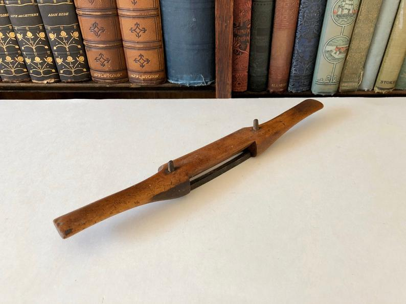

Funny you should show these. I have a Stanley much like the ones you have . Guess like planes how many ways can you make one. I also have a wooden one I really like . The blade could probably never be replaced and is bent at ends with long taper which goes up thru the handle.
This image I just found is very similar but mine has a much better finish.
