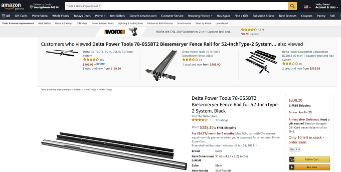

December 23, 20205 yr comment_252143 Ron, you may want to hold up on the fence....watching the news this morning it sounds like you might be able to get several blades with it, and a few other goodies. Report
