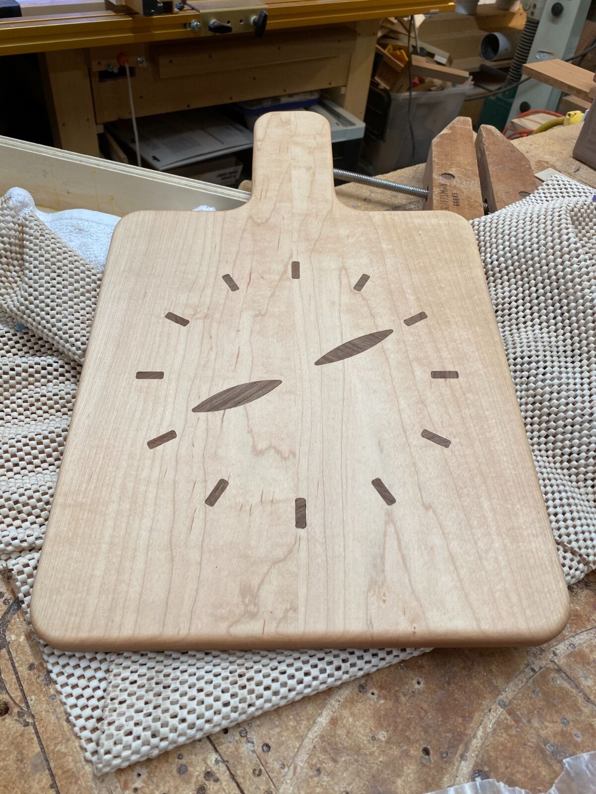

It is a hand held CNC Steve. It has one advantage over a standard CNC and that is it is not limited to size. There is a video of a guy who inlayed a musical staff throughout an entire floor in a music room. I can’t say enough good things about it. I use it on almost every project in some way. It is extremely accurate. Down to .001”. The design software has a long learning curve but once you get it down it makes life easy. Inlay work is a snap. It cuts both the positive and the negative from the same drawing and they fit perfectly every time.
Paul
To give you an idea of how quick it is that cutting board with the clock inlayed into it probably took less than an hour from start to finish.
Paul
