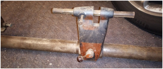

November 3, 20205 yr comment_246998 I saw there is at least one other Craftsman model 113 lathe in this group (or was). I was just given a 113 for free (and wondering if I overpaid?!). [the model 113 is distinctive because it has a 2+" tube as a base] What do you do for parts? Specifically, the adjusting wheel on the tail, but probably more before I'm done! Thanks Report

November 4, 20205 yr Author comment_247041 17 hours ago, Larry Buskirk said: @PeteM http://www.vintagemachinery.org/pubs/222/2875.pdf or http://www.vintagemachinery.org/pubs/222/1985.pdf I can't tell the diff between the two samples you listed. Mine looks just like both, but maybe I'm missing a detail or two. The stamped info on mine is "1-133" (and "75621" which I suspect is the serial). I found another commentary that indicated the C'man 113 had a tool rest marked in inches: mine isn't, but since the tool was made in the 50's, can't be sure what is OEM. I think Gerald is cruel. "Boat anchor". That's way off base Gerald, and I refuse to dignify that idea, only because I don't own a boat! The word "recycle" has floated to mind. I've never owned a lathe, and thought if this one is salvageable it might be an entry/throwaway, but I'm suspecting renovating it will involve more than my supply of patience. The thingy on the right (tailstock?) doesn't spin and the adjustment wheel is missing. On the left, the entire housing that shielded the drive and had the motor switch is missing. I'd consider offering it for parts, but I'm not sure I can get anything loose on this puppy. Was hoping not to have to buy a boat to find this useful! Edited November 4, 20205 yr by PeteM Report
November 4, 20205 yr comment_247052 @PeteM, Yours looks more like the http://www.vintagemachinery.org/pubs/222/2875.pdf lathe. You might find a complete used tailstock assembly on eBay. There should be a tag that has the number listed something on the order of 113.xxxxxx Not all of us can afford some of the lathes available today. Myself included. Edited November 4, 20205 yr by Larry Buskirk Report

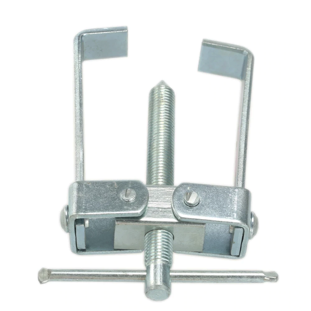

November 5, 20205 yr comment_247130 Might be able to rig something like this to push on the rear of the shaft. Or if the shaft has threads, what size are they and can you just get a nut to fit and use a wrench to adjust? Report
November 5, 20205 yr Author comment_247148 Hey gang, thanks for the insights. I'm not yet decided whether to keep or toss, but I've learned a lot. Since the acquisition (free) was motivated by a g-kid's desire for round legs on a desk (and that would cost money, eh?) (and the desk got done a month ago, tapered & "rounded" legs), not quite sure what investment is warranted! But I did find: --Gerald, Mr Sears was listening to you, and put a keyway under the entire tube, so the head/tail/tool clamps are fixed in rotation --again G, the manual says use a blank longer than finished piece, and oil the non-rotating tail (but the commentaries pointed out that wax works really well) --Larry, I think you're right that it's a 113-23881 (it's REAL name!). But I suspect I'm going to be searching for parts to a deck chair on the Titanic! --Dan I sure hope you didn't get that thing from your urologist. Edited November 5, 20205 yr by PeteM Report
November 5, 20205 yr comment_247156 @PeteM, I just took a quick look on eBay, and found a few that might fit. It all depends upon what you care to spend. This one is for a 113.23851 but looks like it would fit. It also has a live center with it. https://www.ebay.com/itm/Tailstock-from-Craftsman-12-wood-lathe-model-113-23851/373297262997?hash=item56ea403195:g:NOsAAOSwmjxfli3c I found a few others also by typing "Craftsman Lathe Tailstock" into the eBay! search bar. Report
