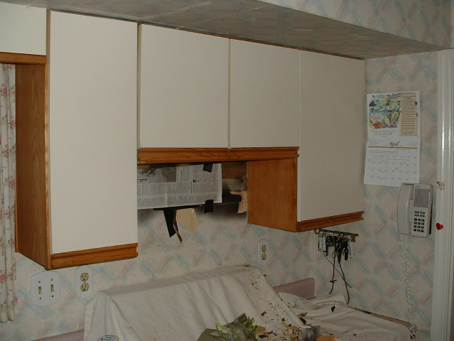

Danl Posted October 19, 2020 Report Posted October 19, 2020 My son has asked me to refinish his kitchen cabinets. I am planning to use Sherwin Williams Sher-wood Kem Aqua plus white for the doors and drawer fronts. This is the product I used for the small additional cabinet I made for him earlier this year. It is a water base material. If I skuff the door/drawer fronts with P220, is this enough prep for the SW product to adhere to the oak wood? They will be cleaned with Murphy's soap prior to sanding. The end panels are not wood, but a plastic laminate. Can I use the SW product? If not, what is needed? Will the end panels need skuffed? Appreciate your input. Thanks in advance. Danl FlGatorwood and Cal 1 1 Quote
lew Posted October 19, 2020 Report Posted October 19, 2020 Don't know what you are gonna use to get rid of that big black mark on the door in that first picture I'd use Simple Green to wash down the cabinets. Not sure about scuffing the end panels. Gerald, FlGatorwood and Cal 1 2 Quote

Danl Posted October 19, 2020 Author Report Posted October 19, 2020 4 hours ago, lew said: Don't know what you are gonna use to get rid of that big black mark on the door in that first picture I'm sure if they let the dog in the kitchen the black mark will go away in a hurry. haha Danl lew, Cal and FlGatorwood 3 Quote

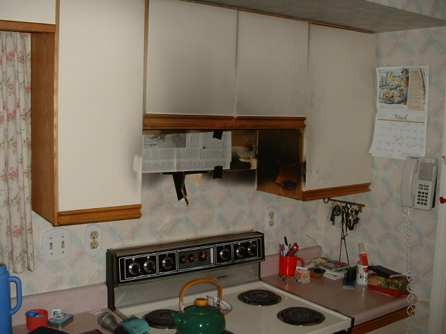

Popular Post kmealy Posted October 20, 2020 Popular Post Report Posted October 20, 2020 25 minutes ago, JimM said: Aren't some of the dedicated primers (Kilz, Bin, ...) shellac based? B-I-N comes in two formats now, shellac and "synthetic shellac." I look for the original. When I have refinished cabinets I've always stripped and sanded them. So I don't have much experience with just top coating. I have rehabbed some kitchens that were done with some finishes that will not take any top coat, even itself after a short recoat window. I've also had to turn down touch up table repair jobs on this type of finish because it would not accept any touch up finish on top of it. Fortunately, it's rare, but it's still out there. Be aware that the oak's grain will telegraph through an opaque finish. Just be aware of this. In repairing fire damage to vinyl end panels, I've scraped off the damaged stuff, applied a self stick veneer, sanded and finished. p_toad, Cal, DuckSoup and 3 others 6 Quote
