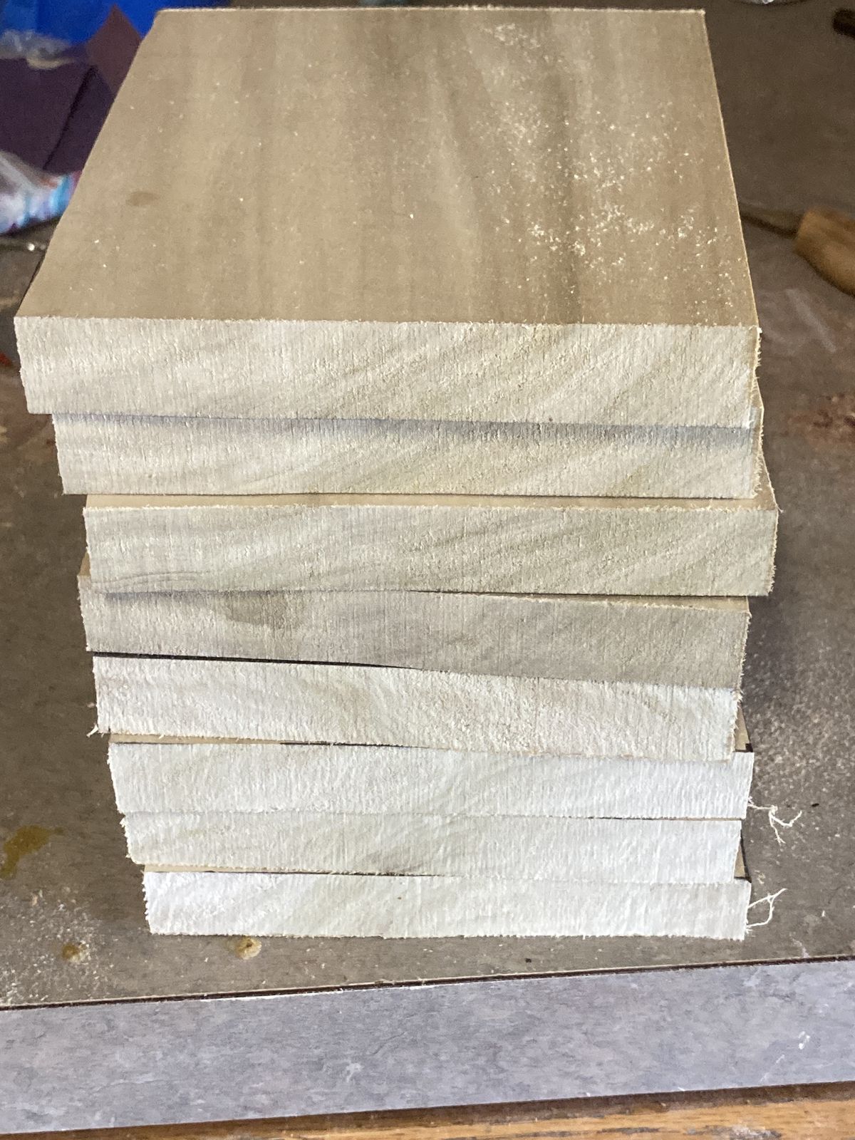

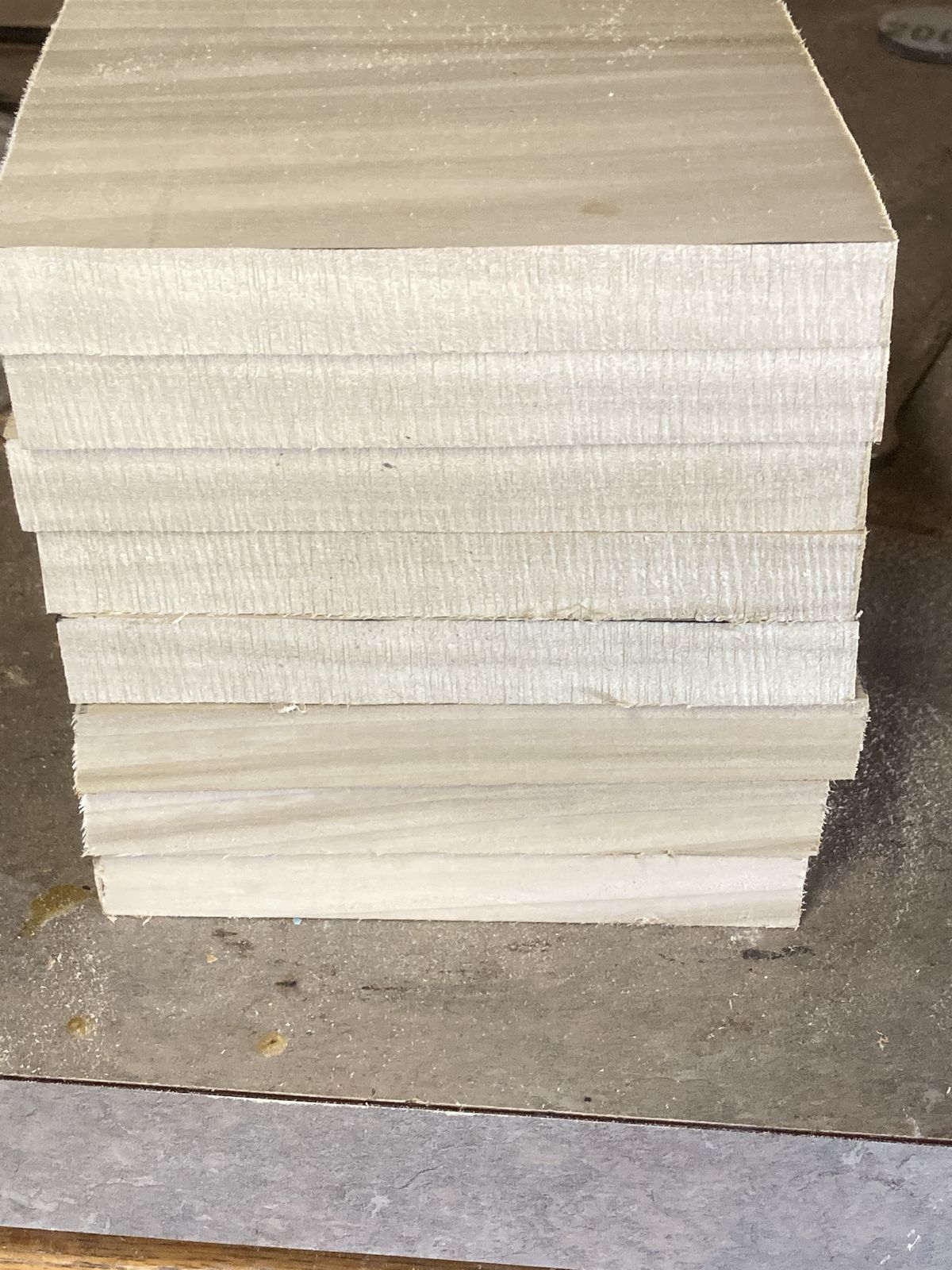

September 27, 20206 yr Author comment_243719 Heres a couple shots of the scrap pieces.... Edited September 27, 20206 yr by AndrewB Report

September 28, 20206 yr comment_243737 7 hours ago, AndrewB said: Heres a couple shots of the scrap pieces.... Maybe glue a bunch together and make a pencil cup/holder Report

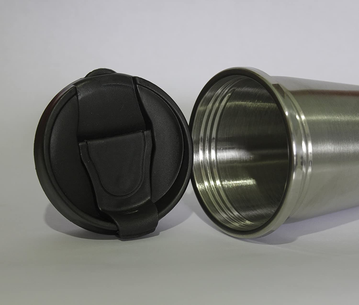

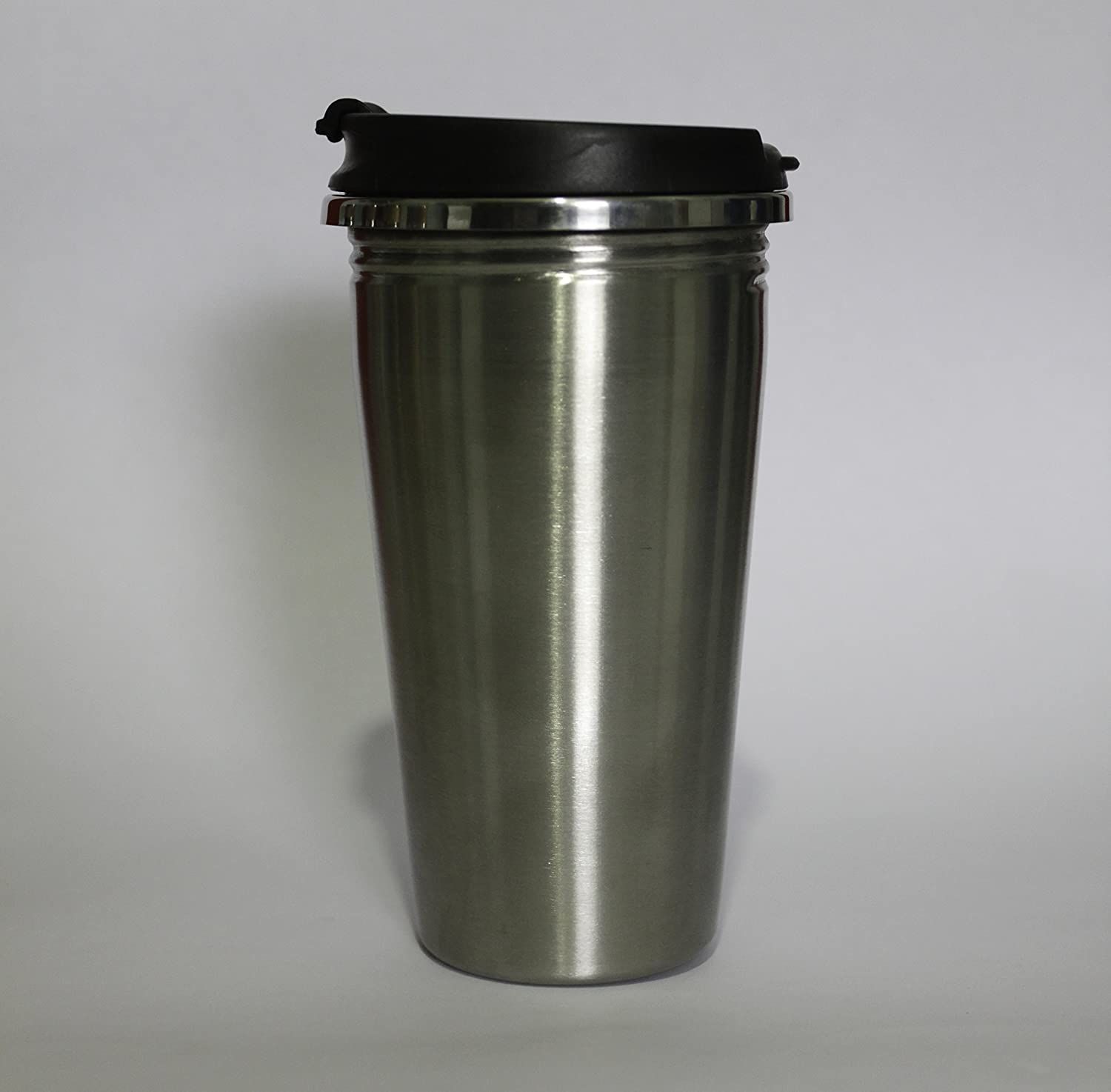

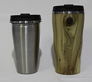

September 29, 20206 yr Author comment_243868 So with both poplar bowls about finished I was looking around on youtube yesterday watched a couple videos on people doing mugs. I was thinking about giving a try on making a mug with the left over poplar. I wouldn't be able to order the insert until Thursday.... How ever this is what I was contemplating trying. I have plenty of epoxy not planning on using the 5 minute stuff if I don't have the right epoxy I'll have to go back and get some clear epoxy for it. Either way this is what I was considering after looking around. Pulled these pictures off amazon. Report
September 29, 20206 yr comment_243870 May be a little too tall for hollowing with the tools you have Report
September 29, 20206 yr Author comment_243878 hmmm I guess I'll figure something out you might be right on that one. Report

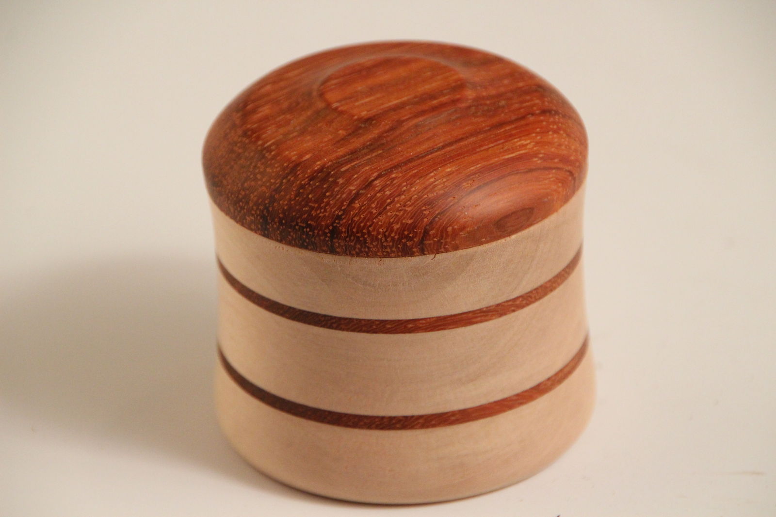

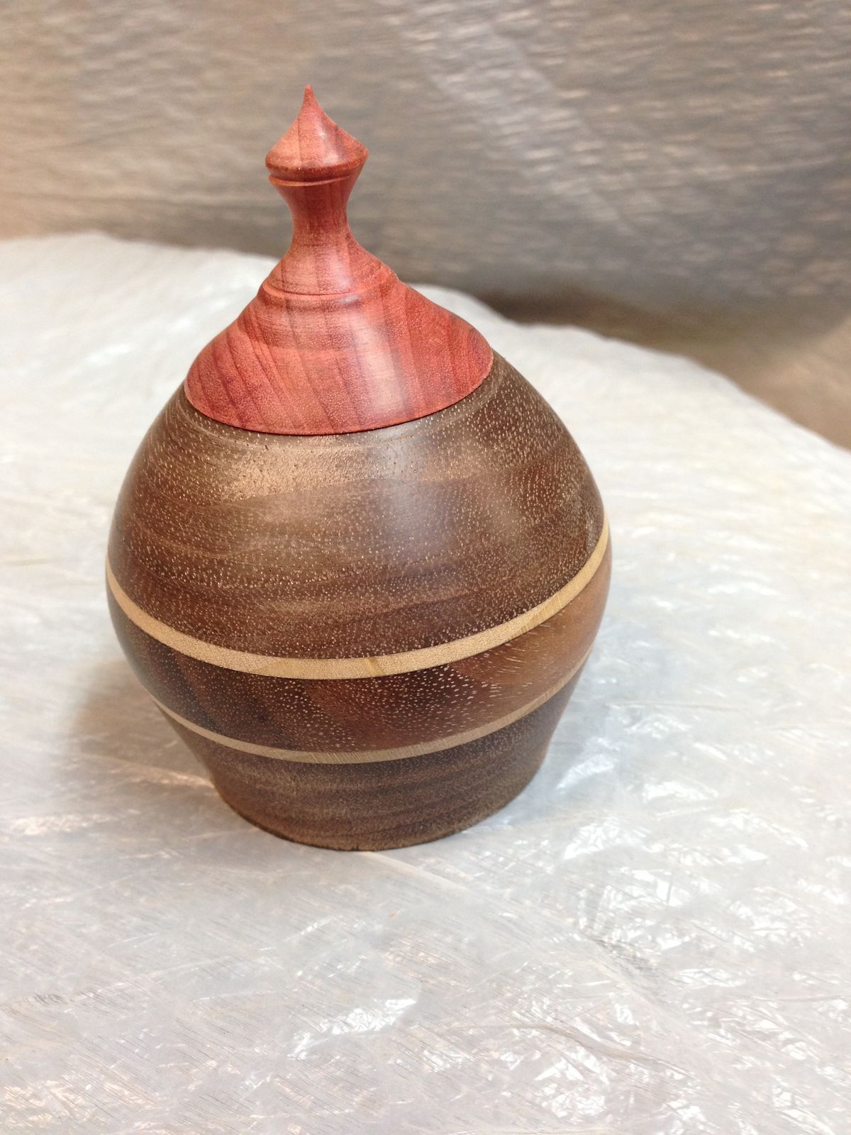

October 1, 20206 yr comment_243980 Boxes are easy to turn and work best if turned end grain. What this does is reduce problems from tops sticking due to shrinkage. Usually a scraper (or carbide ) works well on inside of boxes. Tops can be same wood or a contrasting wood. Blanks can be laminated layers of different woods. This was my first box . Lid too tight as I thought they had to pop....wrong. pecan with walnut top This one the wife claimed . Only 2x3. Bloodwood, walnut and pecan This one is in my store but I just have not had great sales of boxes. This is paduk and maple. Here are a couple basic links without getting longwinded. Wood Whisper Turned Box Carl Jacobson Lidded Box Report
