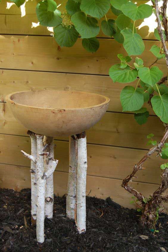

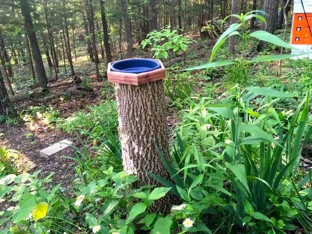

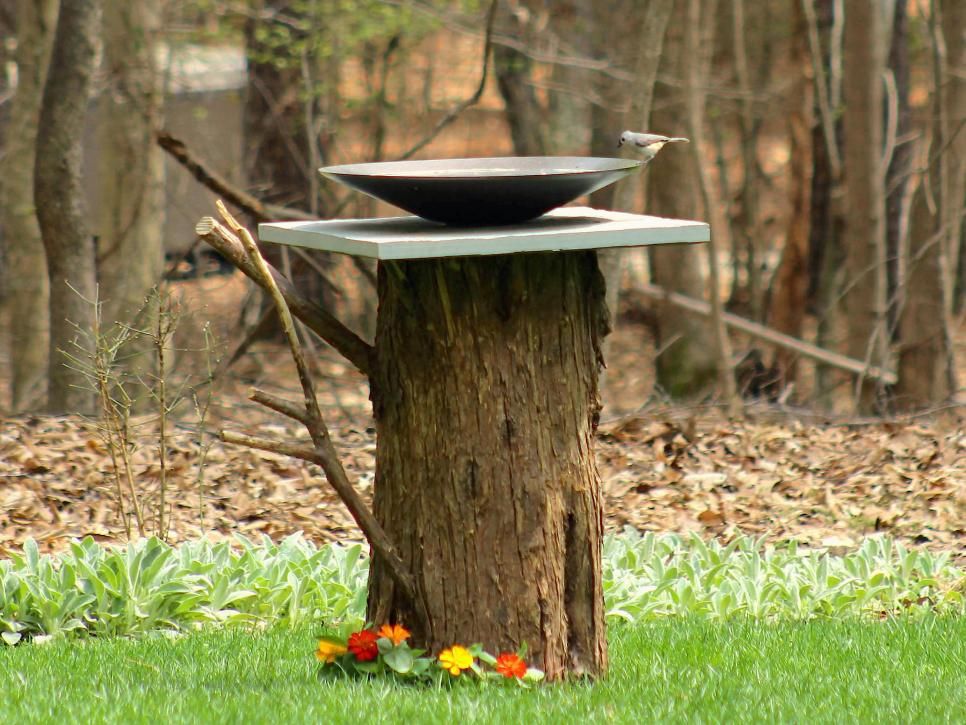

September 20, 20206 yr comment_243004 Hey Al, thinking out of the box here, I am thinking plywood may have a rough time outside, maybe. You I am sure probably have a plan for protecting the ply from sprinklers, rain, etc. But I was wondering, what about a solid wood log base? Here are a couple ideas, not sure what the motif of your garden is, perhaps a log may not work, but it would last a loooong time! You could also take a log and shave it down to the the shape you want. Not too mention the time it would take, no finish, only one or two cuts to size, and yer done! Report

September 20, 20206 yr Author comment_243068 @John Morris The log does sound like a good idea, but I am trying to satisfy a request by my daughter. I'll propose the suggestion. It may be to her liking. Report
