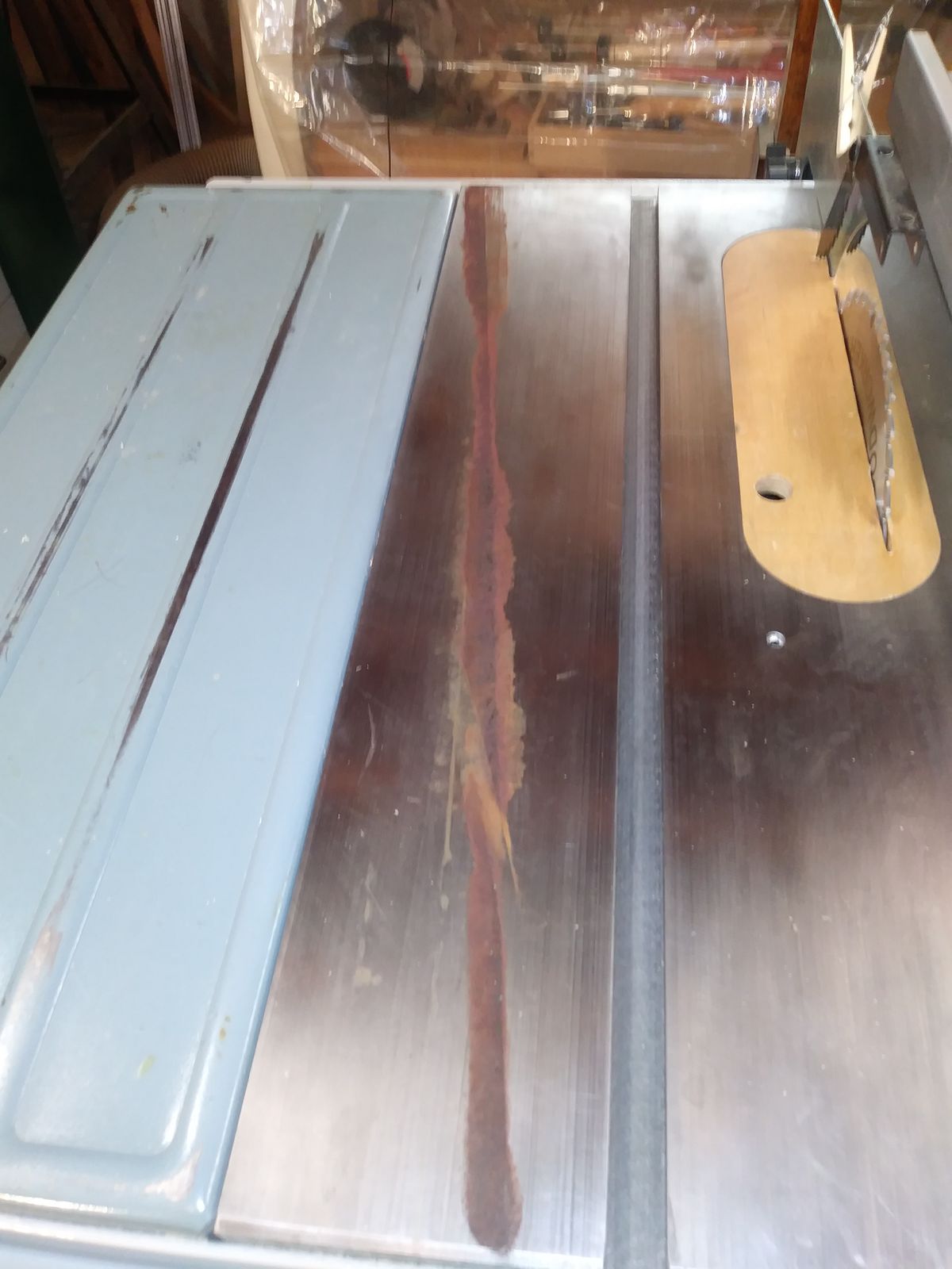

Thought everyone might be interested in this.  Last night, I laminated two pieces of pine to make a thicker piece.  I put a piece of waxed paper on the top of my table saw, and proceeded to glue up the pieces.  I have done this before with no problem, but with 20/20 hindsight, this is the first time I have done this with the wood resting directly on the waxed paper, which was on the table top.  No air gap.  This is what I saw when I went down to my shop this morning.

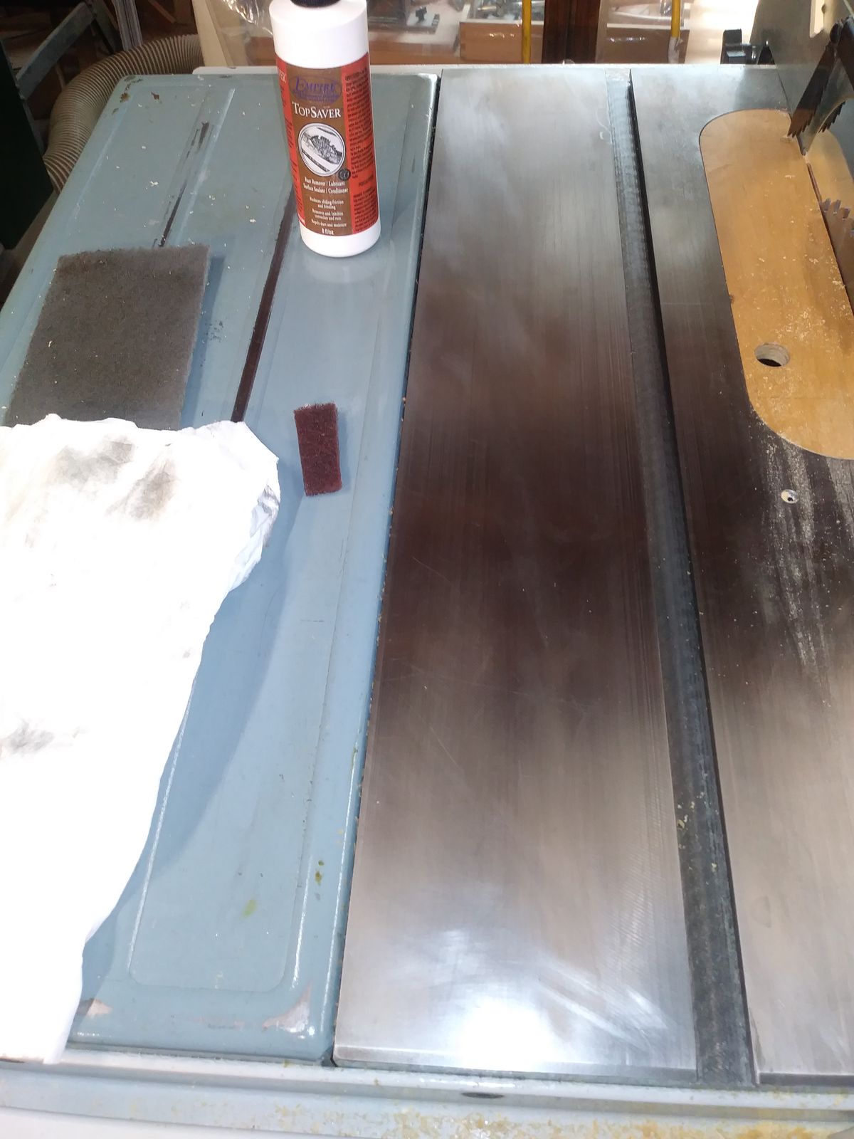

Ok, so I got out my Top Saver, abrasive pads, and the polishing cloth, along with a large can of elbow grease, and went to work.  After an hour, in the middle of which was a conversation with my daughter, this is what I accomplished.
I'm pretty satisfied with the result.  For me, the takeaways from this are:  Under the right conditions, glue will soak through waxed paper.  Buy one of those silicone mats for saw table tops for when I use the saw as a gluing bench.  Be stingy with the Top Saver, because it works, and may not be possible to find any more.
@PostalTom I'm sure we've all had this happen at one time or other.Nice job getting it cleaned off. Just wondering if you wax your table top or use any other method to help prevent rust ? I use a product called Slip-it . It helps to make the surface slippery and helps prevent rust.  Waxing lasts longer than the slip it, but applying the slip it is just a matter of spraying it on and then thoroughly wiping the surface. Waxing is a bit more labor intensive.

Actually @Al B, I don't have the bottle of Top Saver in front of me, but I think it says pretty much the same thing about a quick spray and then buffing out after the cleanup of stains and rust has been accomplished.  When I first saw the problem, I felt the mark, and it was rough and crusty.  My thought was Oh "shucks", the table top is now pitted where the mark is.  After getting it to the point shown in the second picture, I can't feel anything except a smooth top.  I think the Top Saver, from the times I have used it in the past, did leave a protective barrier to actual damage from the rust.  Maybe what I initially felt wasn't "rust crust" at all, but instead, the result of a chemical reaction between the glue, waxed paper, and resins and other compounds in the pine.  Any industrial chemists here, feel free to weigh in.
