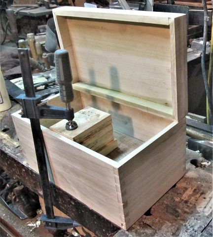

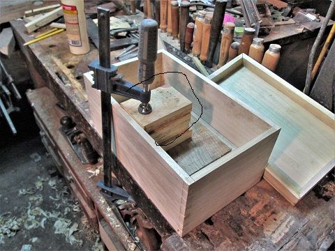

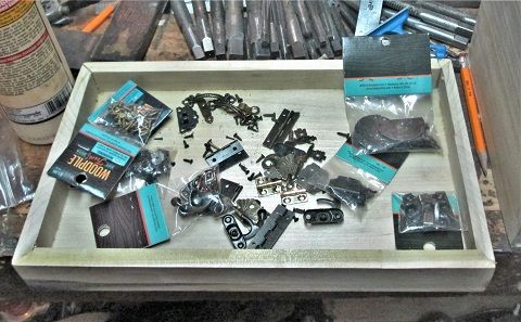

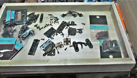

September 26, 20206 yr Author Popular Post comment_243617 Ok...a little catching up....Lid came out from the army of clamps...same with the rack glue-up....Lid and box needed to be "adjusted" so the lid would fit the box...and...the box would fit the lid.. Fairly close? Then the racks were glued inside the box....needed a way to clamp them down... Stack up enough scraps, and use the side of the bench....Had to do this twice....once for the main assembly..and then again for the single 2 x 2.... have a large baggie filled with Hobby Lobby hardware parts....dumped it out into the lid... Then sorted through the mess, looking for just the right parts... Like hinges, a latch...maybe some handles? I do have another label holder I can install....Hmmm have Laundry Detail in a little bit....may see about adding some hardware.... Stay tuned Report

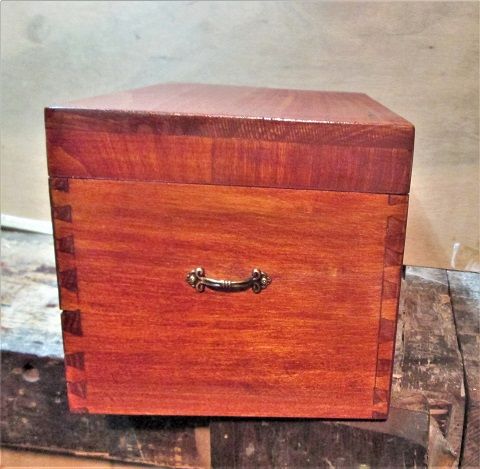

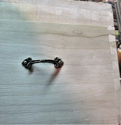

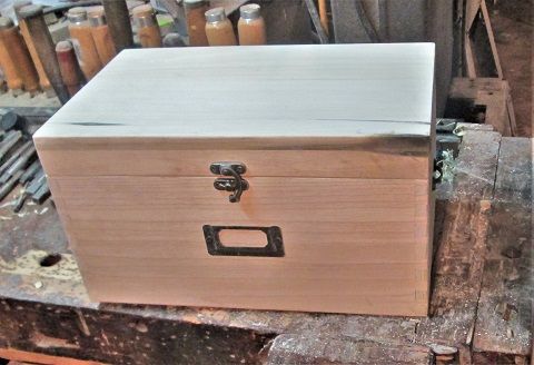

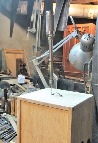

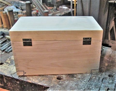

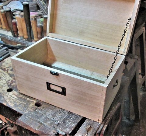

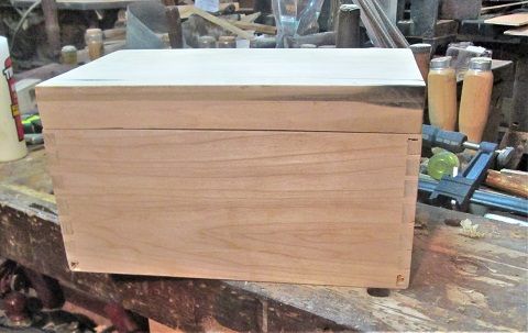

September 26, 20206 yr Author Popular Post comment_243636 Laundry Detail is done...And while the washer was running...I got "done".. . Fancy schmancy Screwdriver to install most of the hardware...hinges... A handle on each end... Needed a drill for the larger pilot holes.. A Latch, and a Name plate holder. As for those square holes? The 2 black circles show where the holes USED to be...Poplar scrap was trimmed for fit, glued in place, planed and sanded flush.. Was having "issues" with a chain...the first one I cut...went and hid...so, I cut a second chain. Sanded the entire box down.. Time for a PIP....until I can add a top coat.. Front view...notice the square plugs? End view. Note the grain direction on the end of the lid... And a view of the top of the lid....open up the lid.. And look inside.... Let this dry overnight, and then see about a top coat, or two.... Stay tuned.. Report

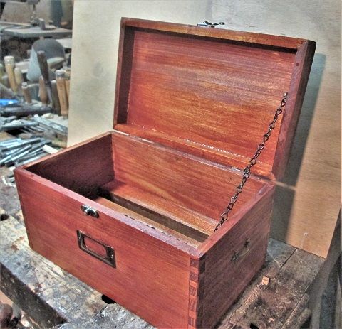

September 27, 20206 yr Popular Post comment_243646 1 hour ago, steven newman said: Let this dry overnight, and then see about a top coat, or two.... Stay tuned.. I see you did the inside, NICE!!! Report
September 27, 20206 yr comment_243691 I see. A new box after every yard sale excursion, right? Very nice box, Steve. Report
