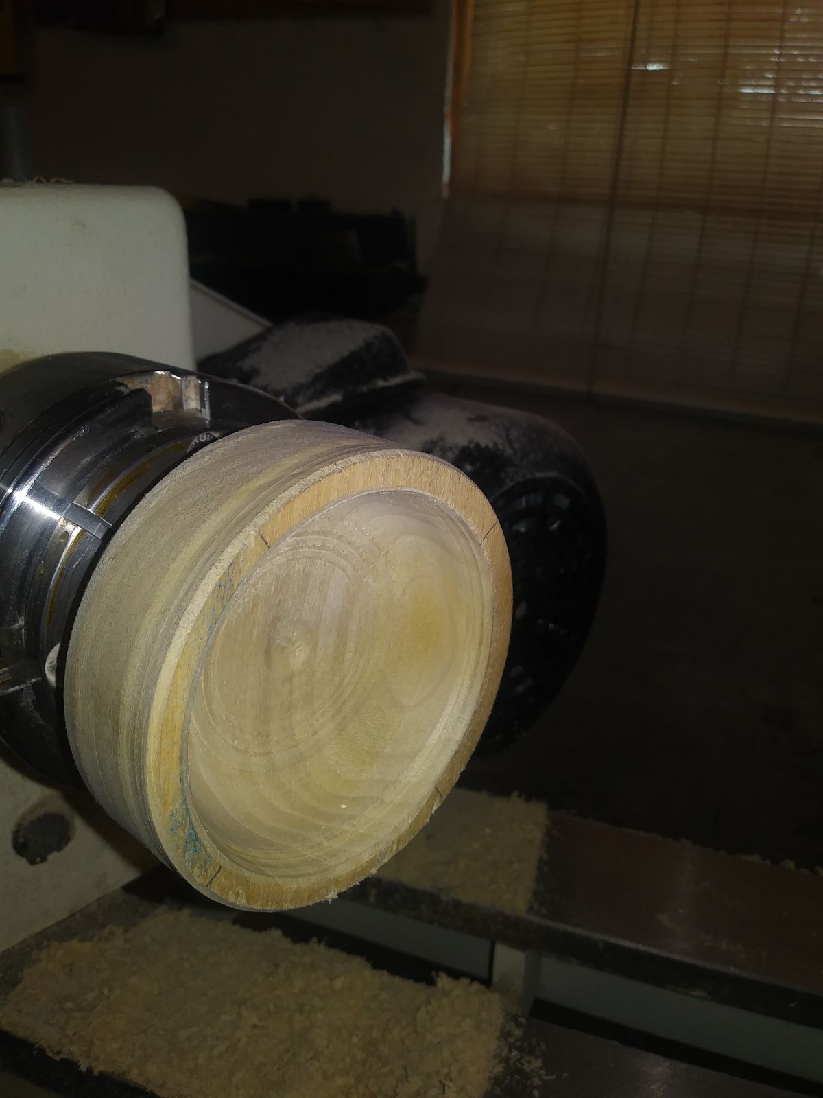

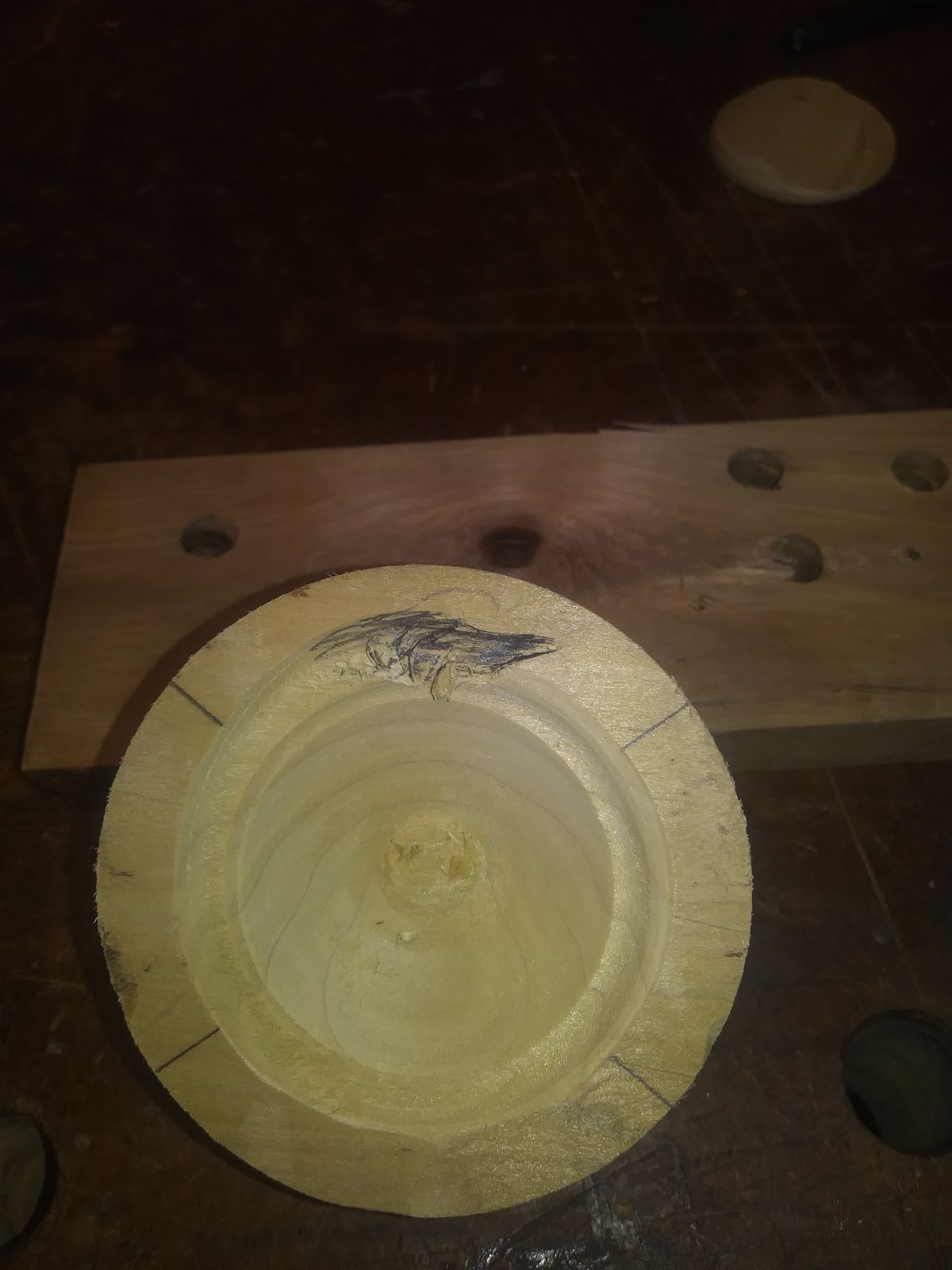

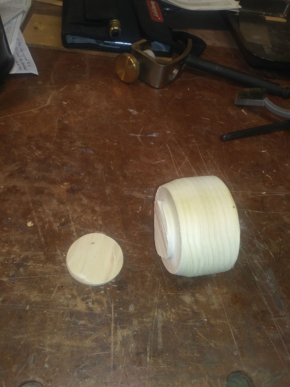

August 16, 20206 yr comment_239312 So, I bought a new 1/2" bowl gouge from Carter and Son Toolworks. This is a beautiful tool, as you can see below. No intended disloyalty to EWT, I just think I should be able to use both traditional and carbide turning tools. I found an old piece of poplar and proceeded to begin turning a small bowl, more of a cup actually, just to get used to the use and feel of the new gouge. Went OK at first. Roughing out the piece went fine, and the forming of the tenon was OK. When I reversed the work piece, installed it in my chuck, and started hollowing out the inside, that also went OK, at first. (The suspence builds!). All of a sudden, CATCH!!. But I couldn't see the catch, because it took me a while to find the part of the bowl that was supposed to still be connected to the tenon, which was still in my chuck. When I located the bowl, this is what the catch looked like. I colored in the catch for visibility in the picture. This is what I was left with. I think part of my problem was that I got too comfortable with the gouge, too quickly and got too aggressive with it. Another thing I think was in play was that the poplar work piece was maybe too old and dry and had developed some hairline cracks. I had noticed something like that earlier as I was prepping the piece to go on my lathe, but I dismissed them as not enough to worry about. Think maybe that was a bad assumption? So tomorrow, I might fish out another piece of something, and try it again. Wish me luck. Report

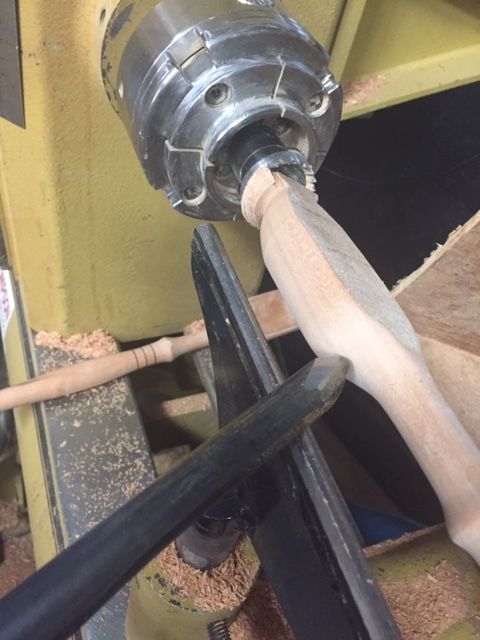

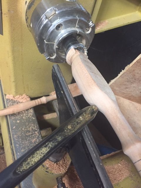

August 17, 20206 yr comment_239500 Got a lot of stuff but I just made a couple pics of open and closed flute first. First one is closed flute with the flutes facing the right. At the right is open flute with flutes facing the ceiling. Now for rubbing the bevel and catches with again Tim Yoder. look at about 5:30 on video, by the way all his catch videos are very interesting. Catches #2 Now for a great teacher Stuart Batty and his Seven Fundamentals of Woodturning . This is on Vimeo and there are more than seven but watch them all , they are all short. Seven Fundamentals of Woodturning with Stuart Batty Report

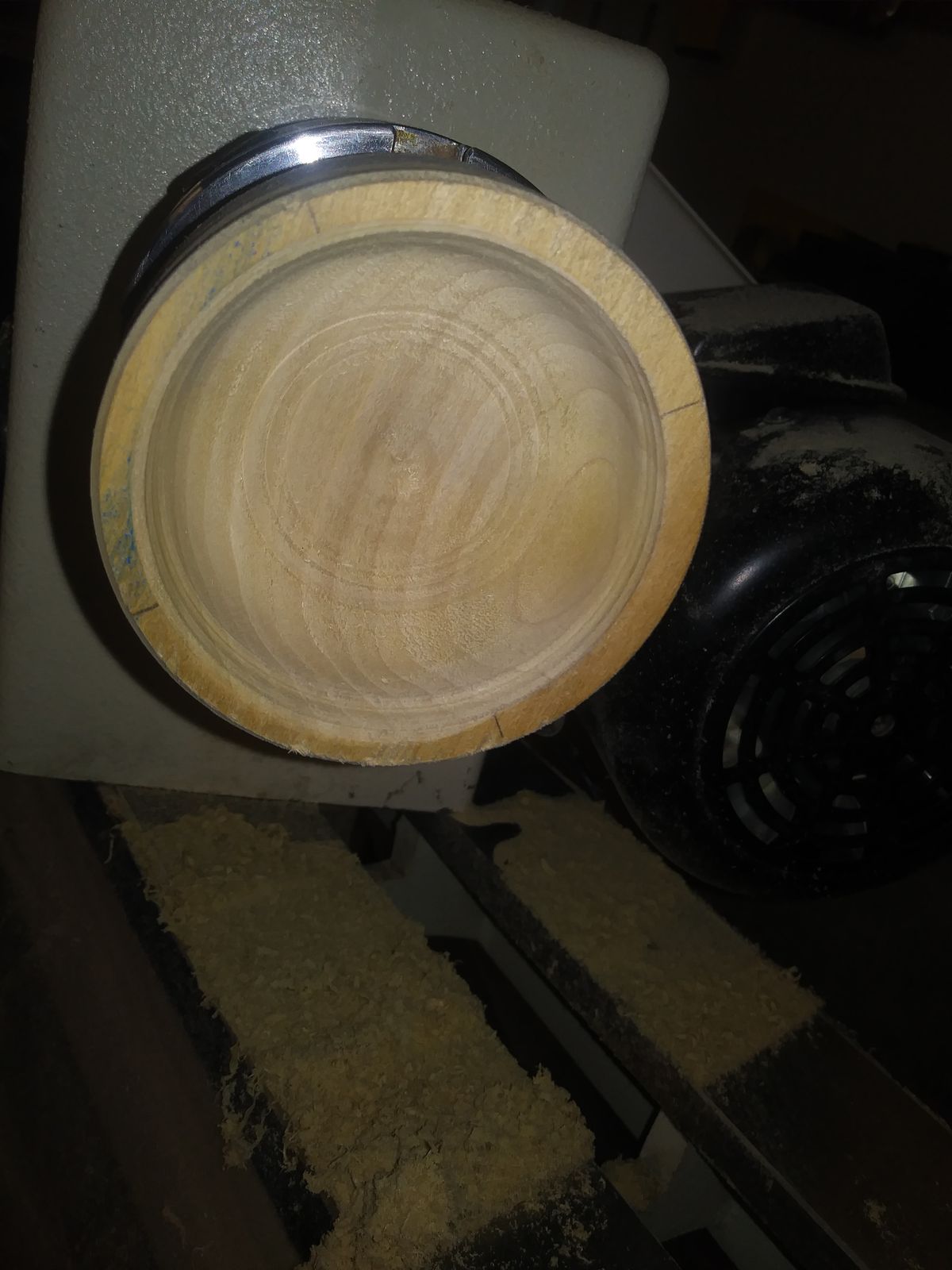

August 21, 20206 yr Author comment_239887 I thought I would post these before I screwed it up again. I watched that Tim Yoder video, and also one from worththeeffort wood working. That one was over an hour long, but he kept emphasizing the important parts and demonstrating them over and over again. It was the one on turning your first bowl. For someone with the patience to watch the whole thing, it also had some good information. This is just a practice bowl, but I am happy with my progress, compared to the first one I tried with the new gouge. This one also with the new gouge. Except for the tenon. I had to go back to a parting tool to do that. I still have to get a different live center to allow more room for that end. Still have the cup center that came with the lathe. Now for the pics. Thanks for the help and suggestions from everyone. It really made a difference. Edited August 21, 20206 yr by PostalTom Added the thanks. Report
