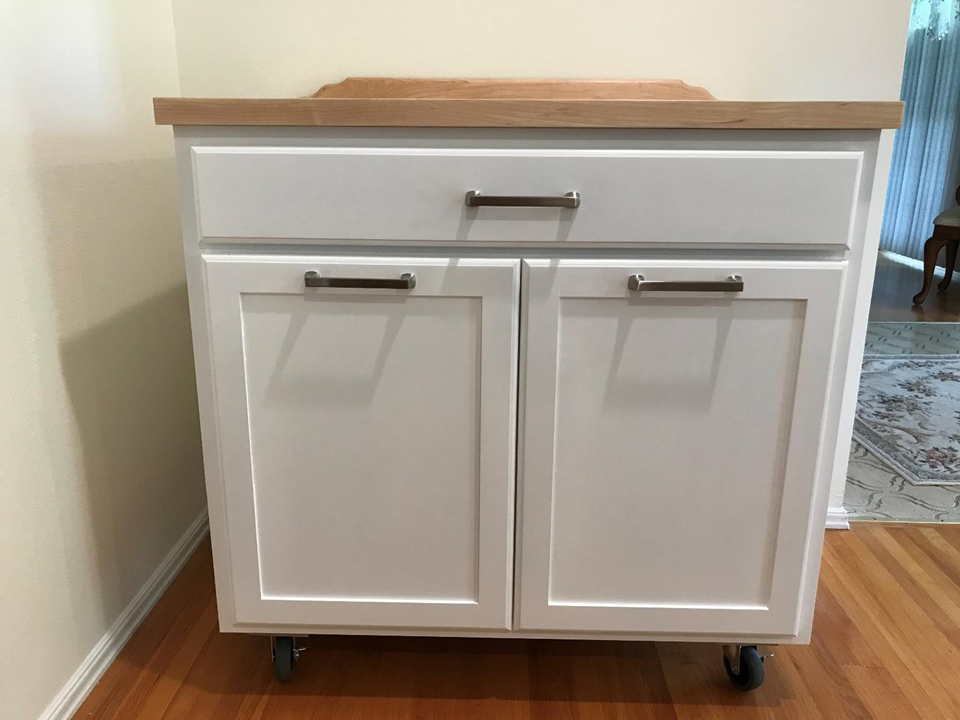

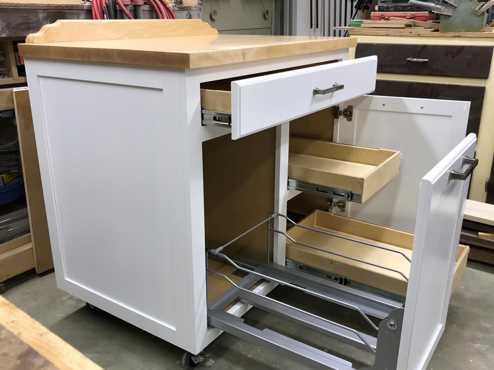

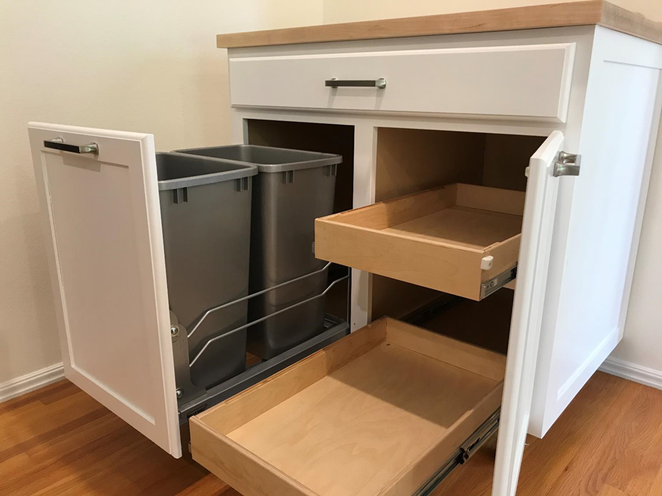

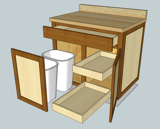

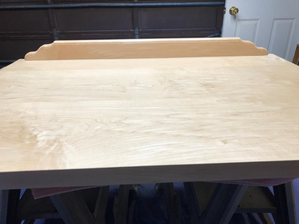

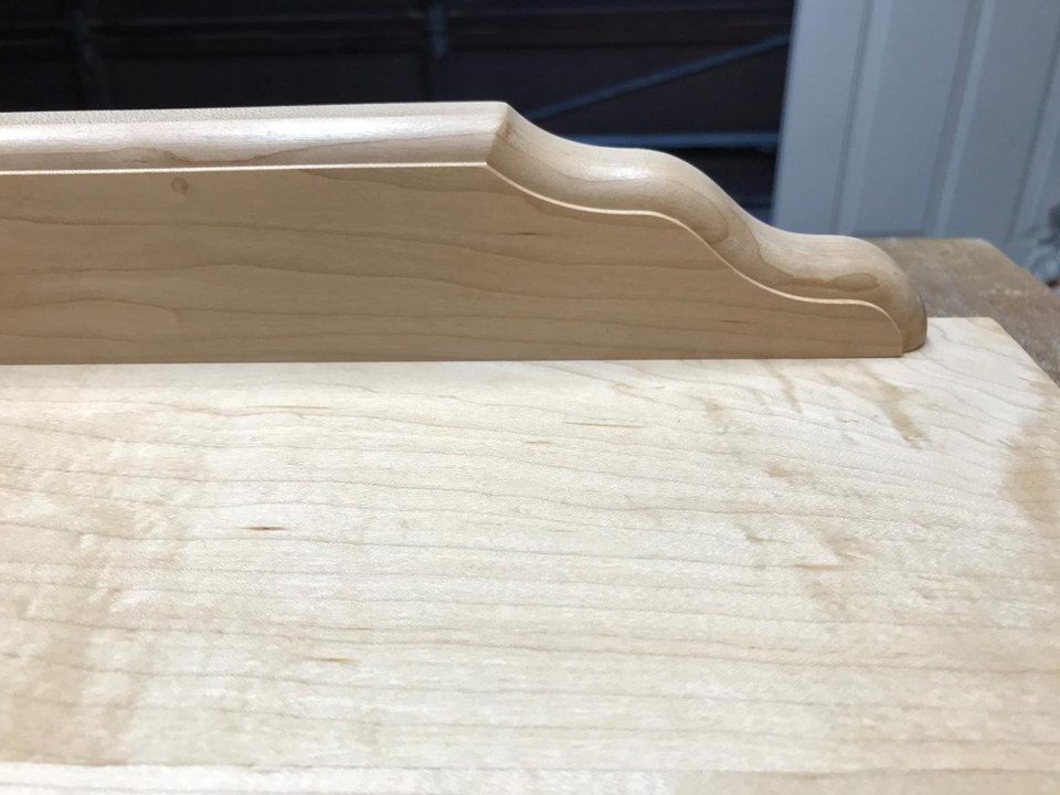

My oldest son asked me to build him an additional base kitchen cabinet.  After talking with him and his wife, they decided that it had it be portable.  The final cabinet size is 24” deep x 36” wide x 36” tall.  The cabinet box is made from UV white birch ply and the drawer front, door frames, end-panel frames and face frame are made from poplar wood.  The door and end-panel center panels are made with MDF.  The three drawers are made from ½” Baltic birch ply and have dovetail joinery.  The pull-out soft close trash drawer mechanism is from Rev-A-drawer.  The drawers were sprayed with 1-1/2# cut shellac, the countertop was sprayed with Sherwin Williams Sher-wood Hi-Bild pre-cat lacquer, and the outer surfaces were painted with Sherwin Williams Sher-wood Kem Aqua plus white.  Thanks for looking.

Beautiful!!!:TwoThumbsUp:
Sweet! Love the full extension drawer slides.
Nice Sketchup work, too!
Edited by lew
You know, there be some pretty good work done here!
Fantastic.
The cabinet was installed this afternoon.   I have a happy customer.  The check is in the mail. Ha, Ha.
Thank you for your kind words.
Danl
Pretty sweet Danl!
