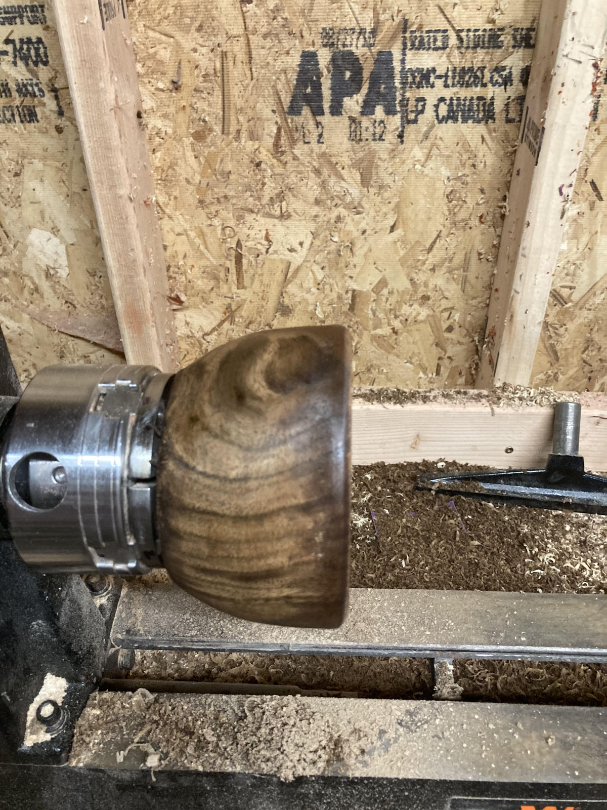

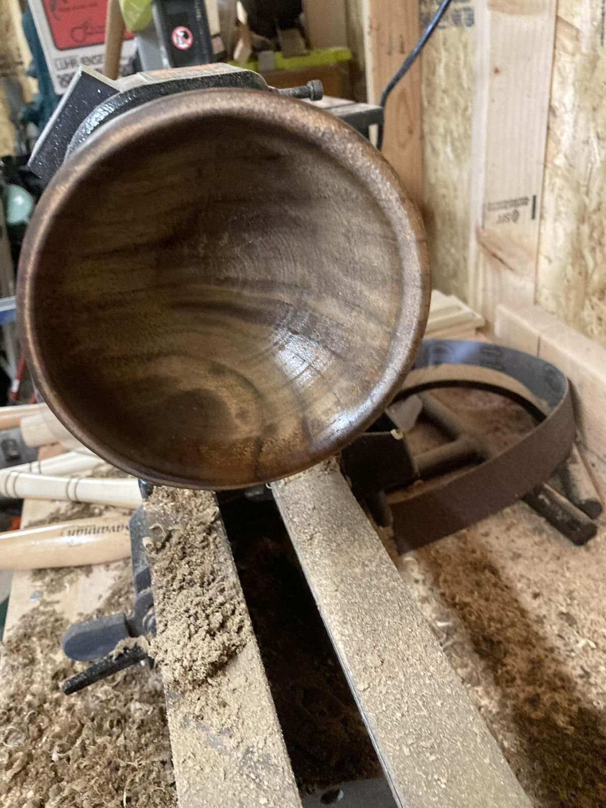

I got frustrated with a project I started yesterday due to wobble.  I mean I've still got wobble in the blanks but its not as bad.  I cut a mortise into the bowl bottom to give that a shot this time it was no where near perfect how ever it works.  Hollowing internally does not seem to get as much wobble but when it does the chisel will bite into the wood.  Also tied out cutting into the middle with the forstner bit as well to get a depth gauge and I think I'm finding that a better way to do do things so I'm just not hollowing until it blows through the bottom.  Pen stuff should HOPEFULLY arrive at some point today.  This project is the Walnut Claro.  I'm almost now starting to wonder if the wobble is being caused from myself changing the belt and dropping the speed to 0 to 1000 RPM.  But this one seems to be going smoothly at least so far.
For an un balanced wobbler this one came out pretty good I think anyways.  Needs a bit more finishing work but yep I'll be calling this one good.
@AndrewB you have made a lot of progress. Looking better every day. Much better forms now. Just need to work on your tools control. By the way do me a favor and call then "gouges". Chisels are for flatwork.
Oh and needs more sanding ;)
Old habits are hard to break I guess.
