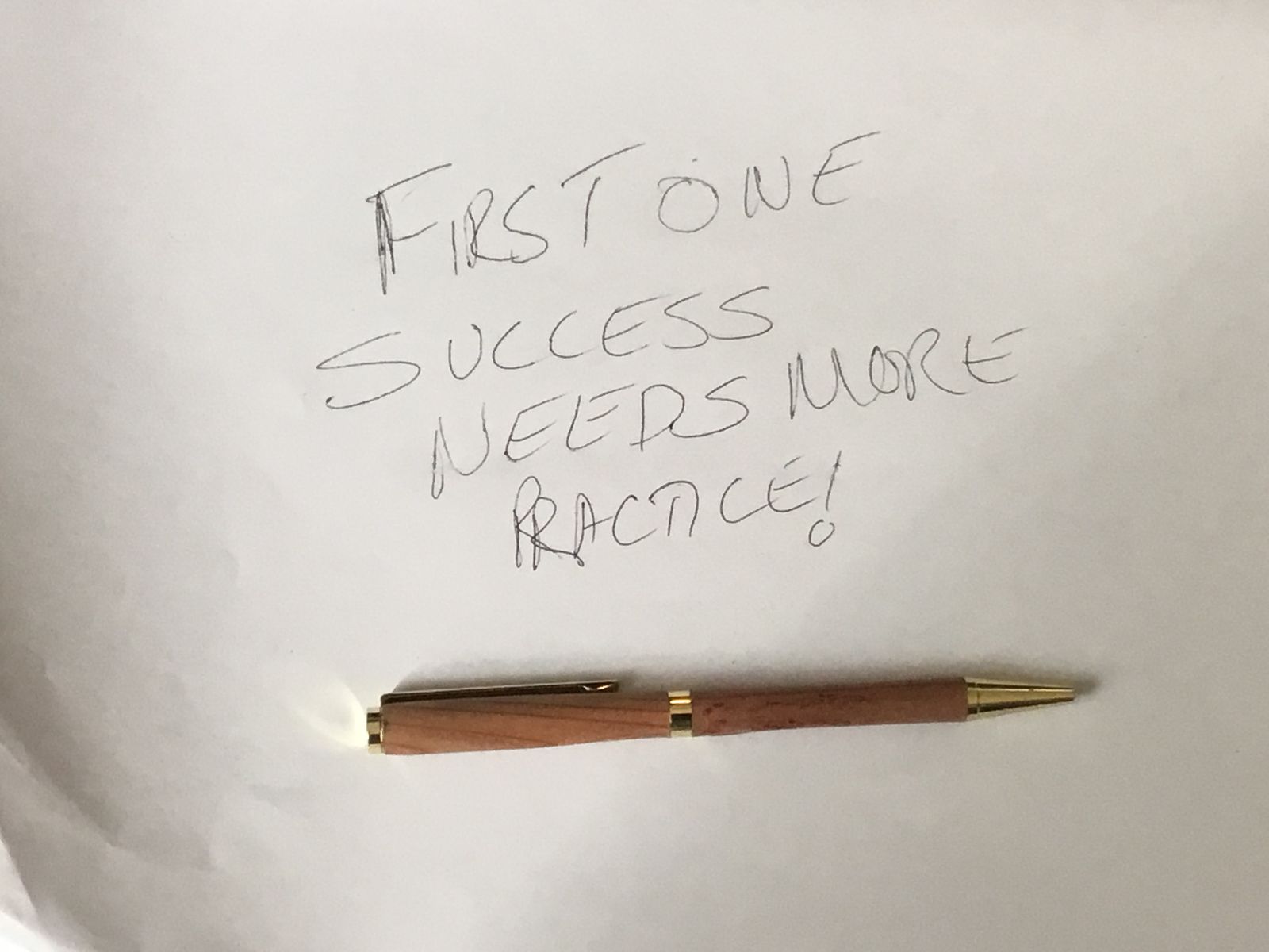

Either way with all of the information I've gathered about pen turning, watching quite a few youtube videos on basics and assembly, I think I'm at the point where I can get a functional pen made.  I was out in the shed this morning I got the pen barrels turned out sanded and 1st coat of stain on in less than an hour and a half.  Which is pretty good considering.  I'm doing this one as a test run since I'm out of brass inserts and parts which are on order but wont be here for a week or so.  I think my main goal is to stick with this for now until I can accomplish the task of getting this right.
What’s the old saying 3rd times a charm??  Well after turning this morning sanding and polishing and assembling the pen has a couple of small cracks in it.  Not to big of a deal but the simple fact that the pen is functioning is quite rewarding.  I still need to work on getting things evened out better the pen is made up of two different pieces from two different blanks.
A good working first pen. :TwoThumbsUp: In picture below I pointed out a common occurrence in people's early attempts.   This is more for others that might look to this thread for tips.  I point this out because if you take a look at the cross section of a pen you will see the wood is very thin.  Thin is not your friend here.  So if it is thin already and the shape gets thinner in the middle the risk of pen failure is greater.
Keep this pen, don't give away.  In fact keep it in the shop.  A visual reminder and a quick reference for you.  Helps in the beginning.  As far as mismatched pens, so what?   I am not past putting say purpleheart on the top and walnut on the bottom.  Or laminating a piece, even a Celtic Cross for those who really want to have that wow factor.
As I said NEEDS PRACTICE.
