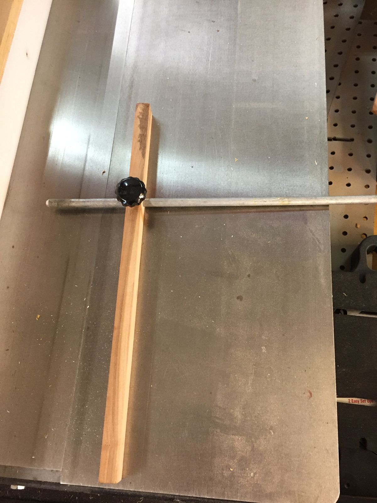

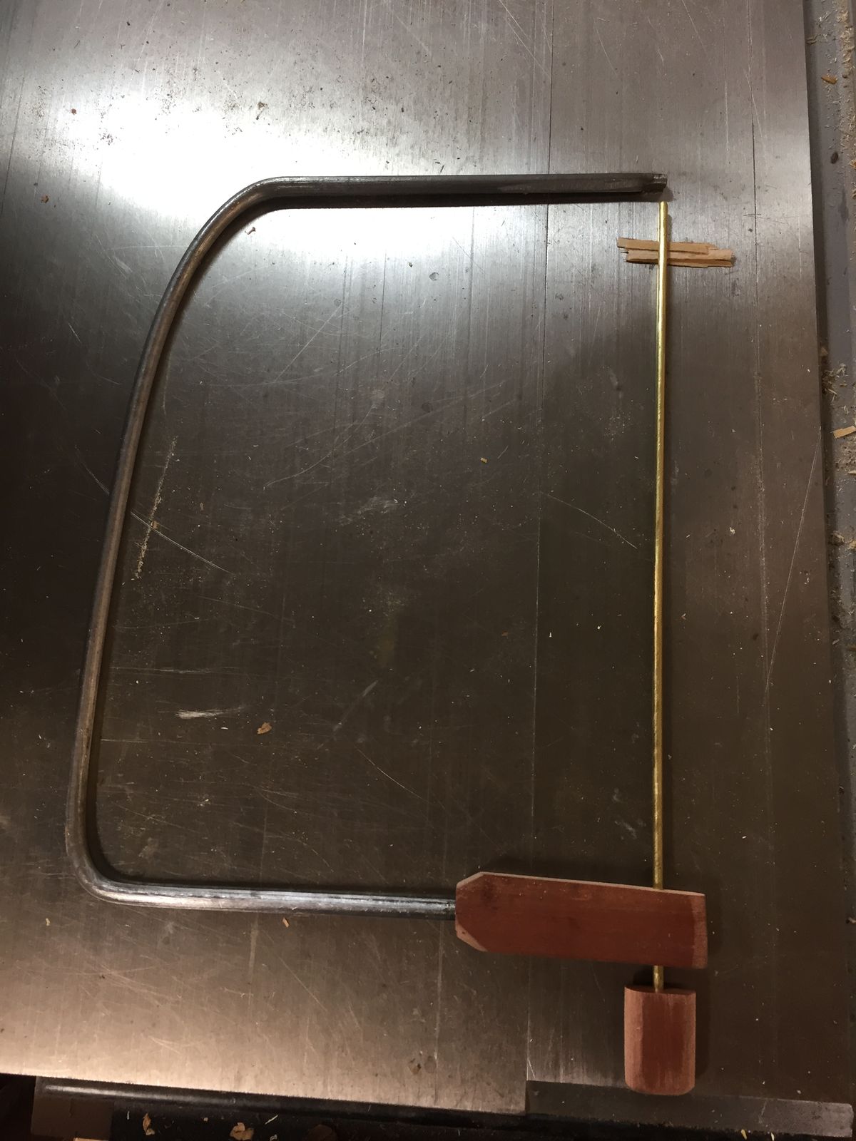

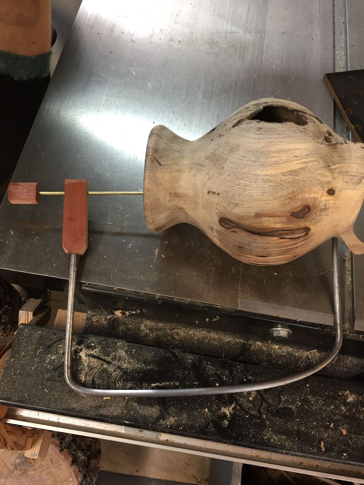

July 26, 20206 yr comment_236628 Saw these on a demo and almost ordered one for 55 but on second thought. the c shape one allows to check bottom thickness with workpiece in the chuck due to the thin bottom of the C. Easy to make. This is next one is a simple Seth gauge and may make another with brass rod Report
July 26, 20206 yr comment_236629 Interesting concept with the design I'm guessing this particular one is for finishing? Report
July 26, 20206 yr Author comment_236634 The C is a copy of the Hollow-Pro Caliper at Craft Supplies. That thing is 57 for small and 67 for large an I almost ordered it. @AndrewB This is to measure the thickness of the bottom of a bowl. What I liked was that it was thin enough to touch the bottom of the bowl in the chuck. The distance between the wood at top and the top of the C is the thickness of the bowl bottom. Report
