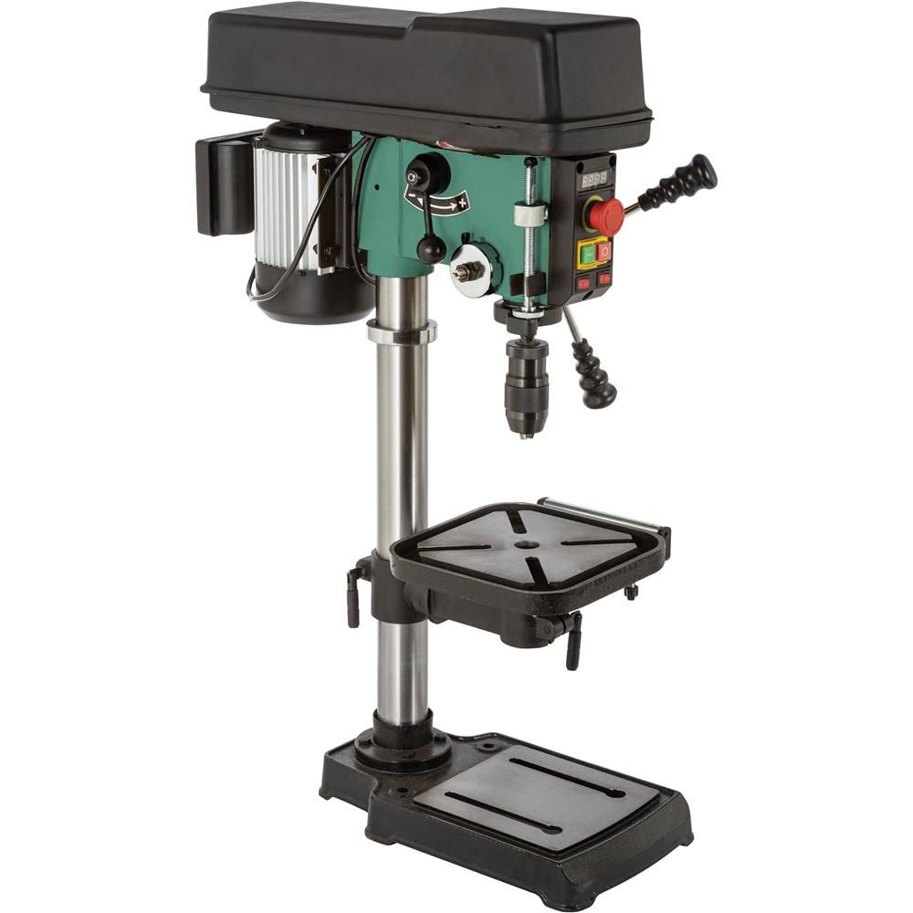

Grizzly 12 inch Drill Press Variable Speed

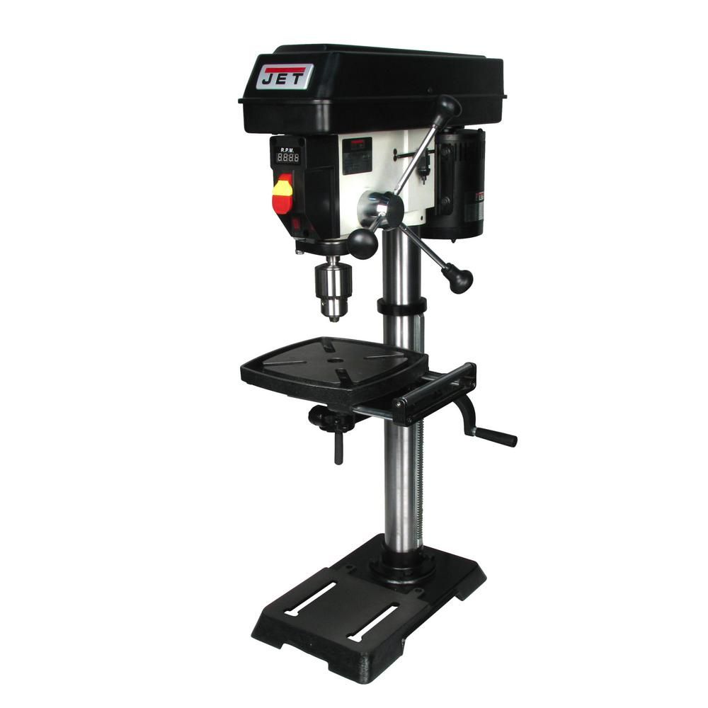

JET 12 inch Drill Press Variable Speed

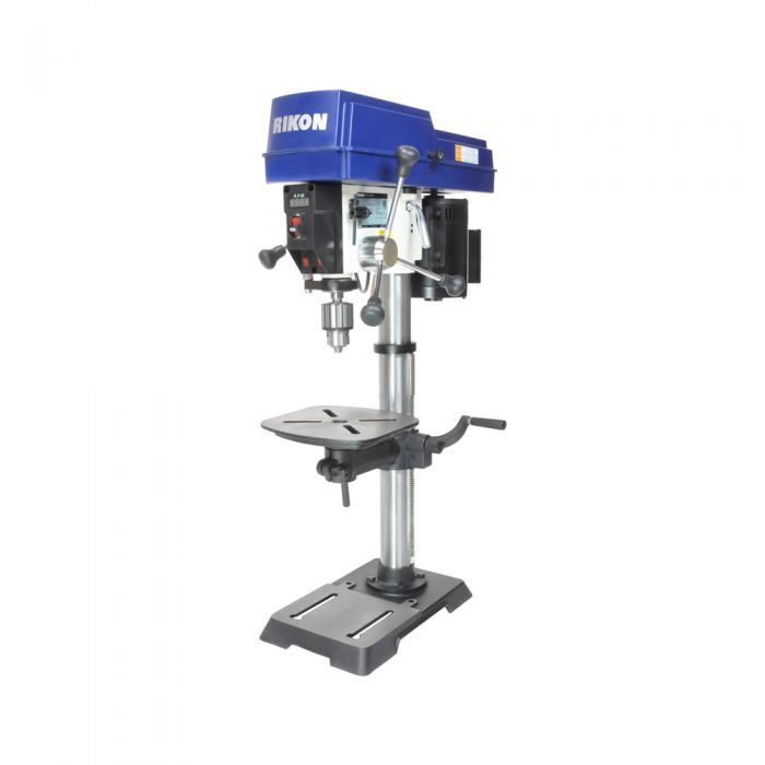

RIKON 12 inch Drill Press variable speed

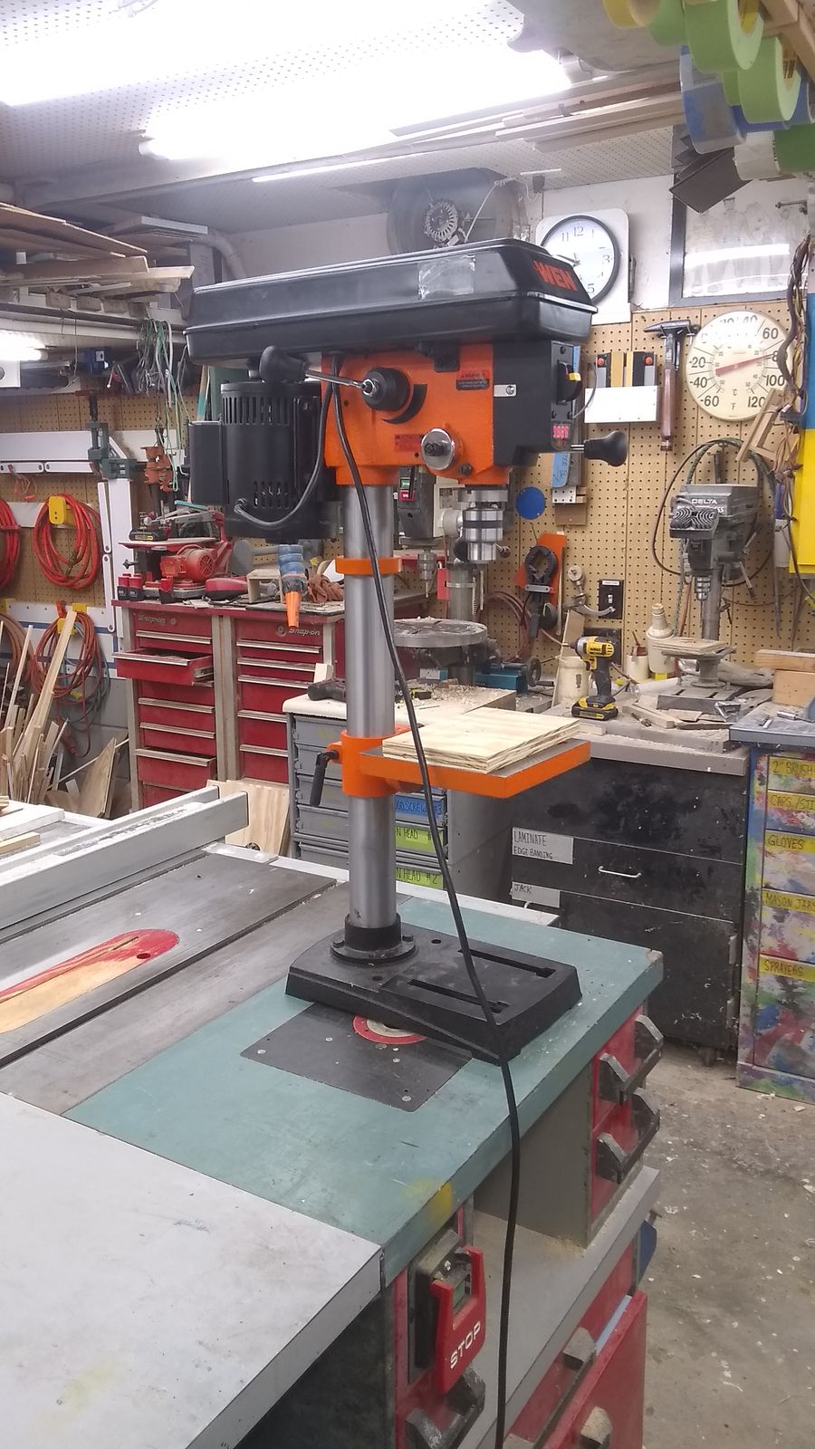

On 8/4/2020 at 11:47 AM, Gunny said:
Have acquired this recently. WEN 10 inch Variable Speed.
Works well drilling at lowest speed for metal.
Nice,.how does that compare to the Delta in the background ? :)
The Delta is only 8 inch, little guy.  But is set at its lowest speed of 620.  The lowest speed of the WEN is listed at 580, but it shows 520 on its tachometer.  WEN has a bigger motor, and is bigger throat so allows more work to be done the other one cannot.  So far for the few projects I have done it has been reliable and handled each well.
The Delta remains in the shop, still in use.  Put in a 1/8 drill bit, set speed at 1100 and use for pilot holes.  Now getting them all set up properly, yeah..... still working on that.  As it is raining this afternoon I will be in shop looking at how to make those 3 line up and work together.
