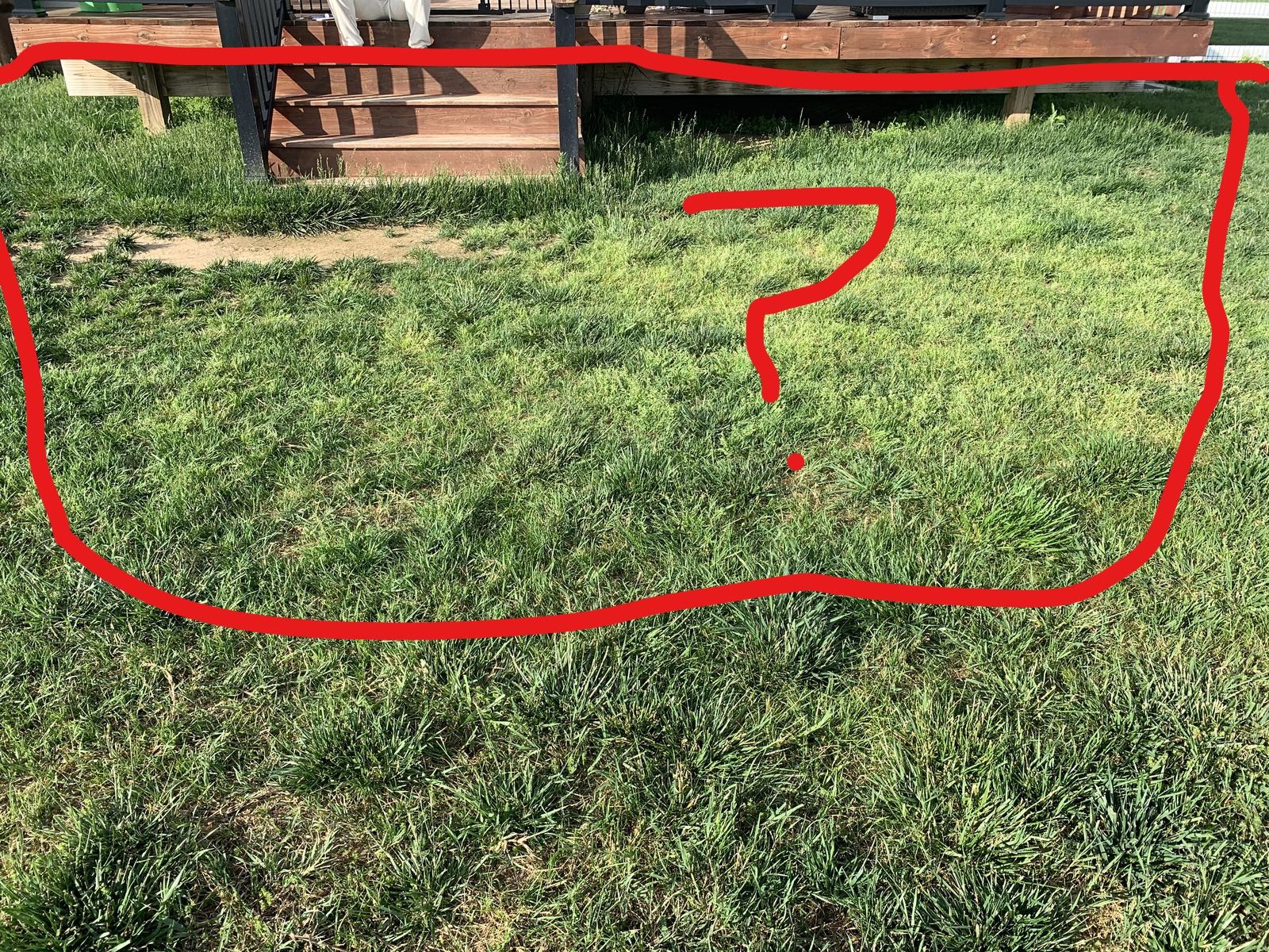

This is what I’m working with...
In the picture below I circled where I am guessing you wish to add more deck?  Few questions on what you are thinking.  Give us more a what your minds eye sees.
1. Add will be same level as existing deck?
2. Add will be a lower level?
3. What did they use under the existing deck for stringers and sheathing?
Gunny, I want to add a lower level deck, probably 12-18” off the ground. My thought was to run a ledger board off the footed post for the original deck, run the rim joists out to a footed beam at the front with the joists running out from the original deck.

Well, change of plans, cant build out too far off the front due to the drain tiles for septic so now I am thinking of going off the corner (right front corner looking at pic above) and going out and around that way.

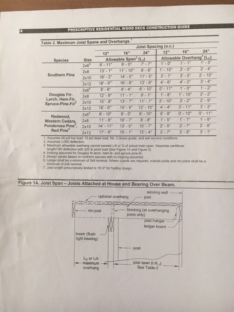

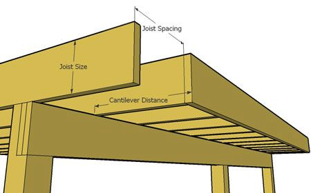

Maybe not.  A deck can be "cantilevered' over the beam too.  You may want to look into that option.
IIRC, the cantilever distance is L/4, where L is the total length of the joist - as of 5 years ago anyway.
Just to clarify - this would depend on the size of the joists as well as the spacing.  (Edit wasn't available!)  Additional information attached although there may be an update.
