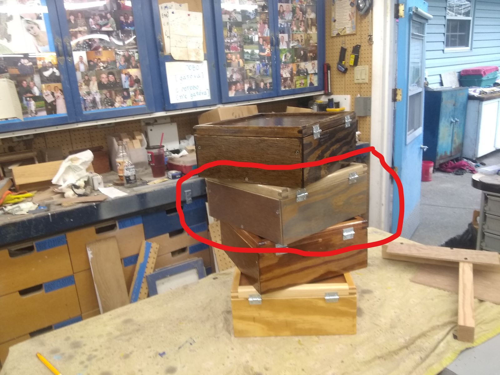

I tried the miniwax grey recently, not impressed.  Very light grey and in some cases depending on the wood hardly any color change.  Here is a storage box I made with that color.  The plywood took it okay but the top clear pine frame you can hardly see any color change.  These are coated with clear gloss poly.

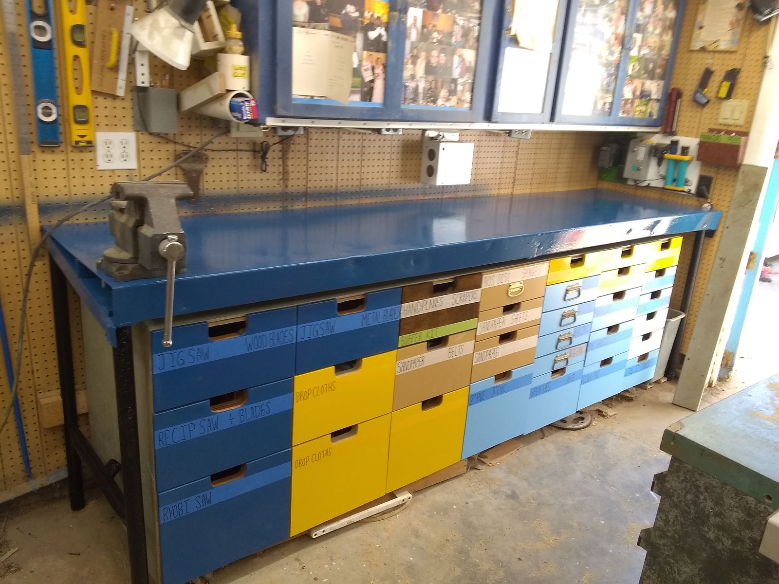

If you look at this it is not a light problem.  The poly has yellowed as it has aged.  Normal for poly.  This particular cabinet is finished with Rustoleum Aluminum colored paint.  I like it for the look nothing more.  But it is flat and has to have some covering to be able to wipe down and not leave streaks.

These were new last summer, have to see how they hold up over time.  They have 3 coats of brushed on Helmsman Gloss Urethane.  As @Gerald said they may not last for more than 1 year.  Part of this design is that the legs come off to accommodate refinishing.

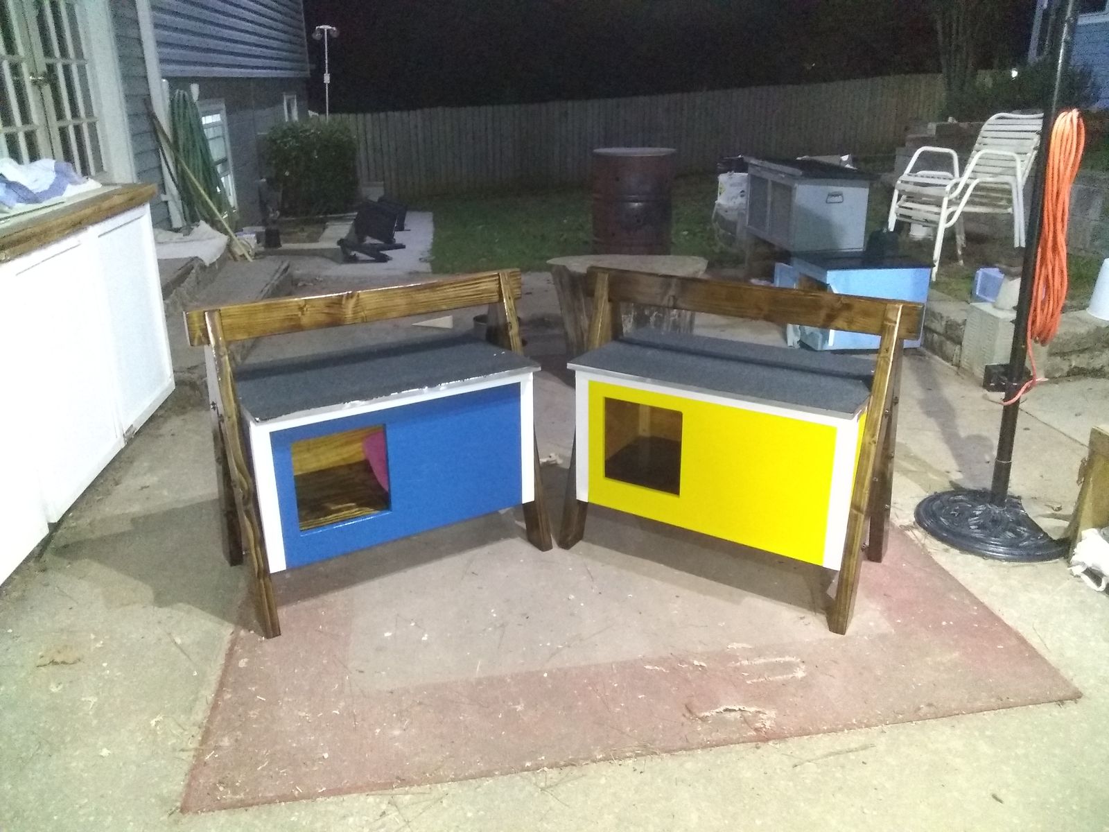

Yes oil base will hold up better. In my experience anyway. All the cat house / saw horses I made are oil based paint and then Urethane.
