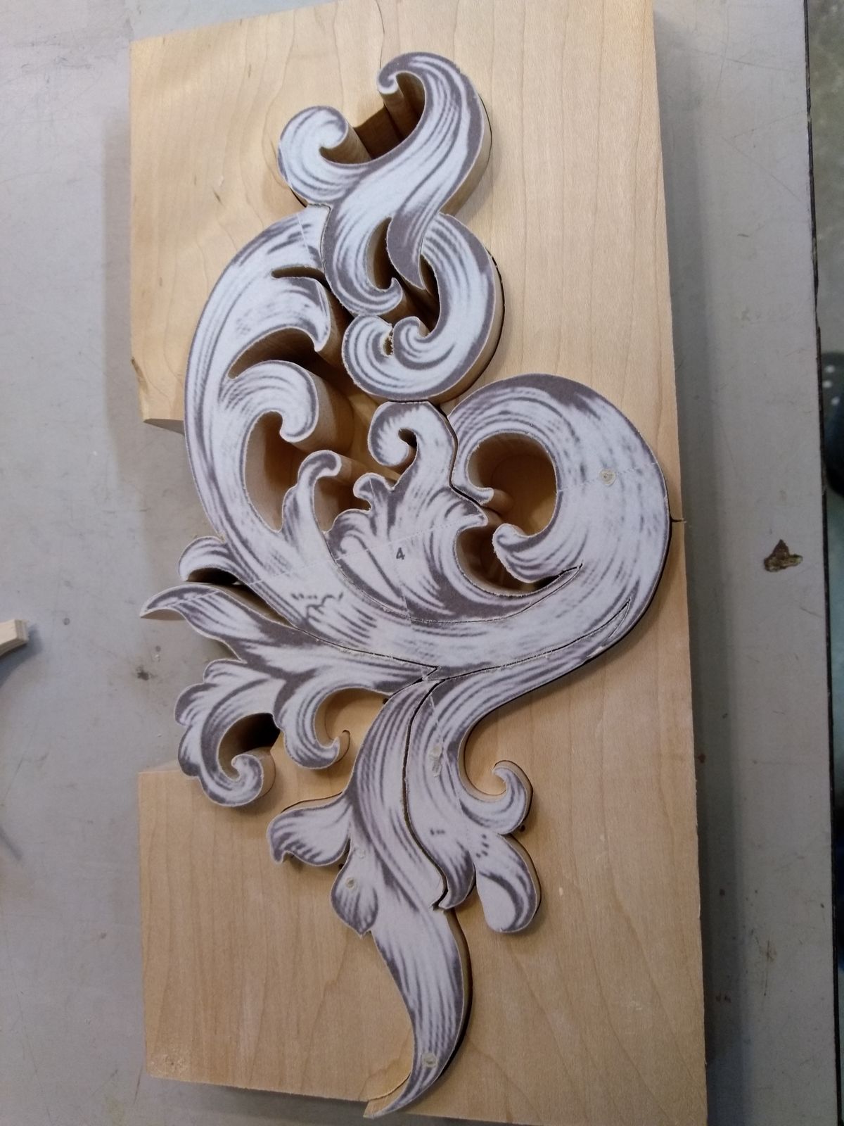

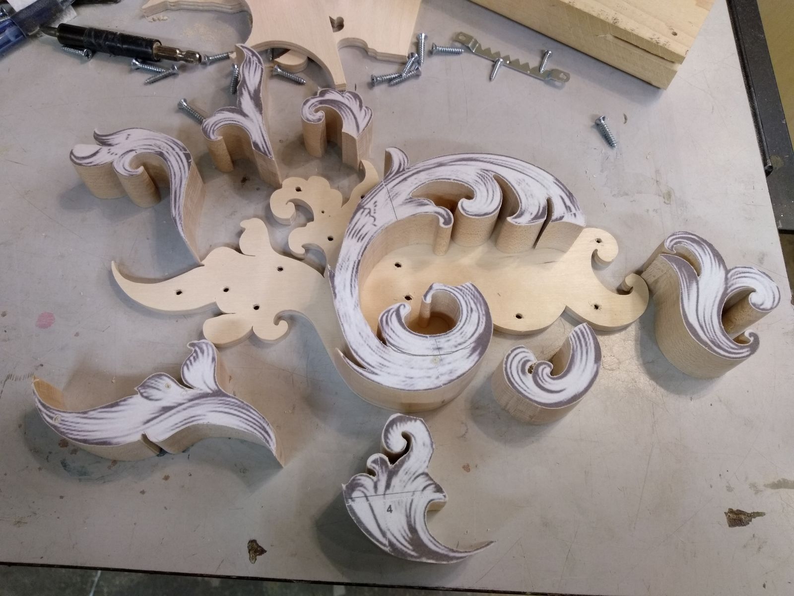

Artie it didn't take 6 months, just one day.IMG_20200424_155959328.jpg.29af083cb51ad6a3130ba479f99dc1e9.jpgIMG_20200424_163954751.jpg.9d1328cd6293fc9c359a635b0bf26dad.jpg
 I think this would be better to start with since it don't have a rose but if anyone wants to start with the rose, its ready also.
 I will also send a picture so a person can tell where the low and high areas.
Another tip... The pilot holes are mated up with the screws and if a person cuts the torque way down then you won't be busting the wood, BUT, turn up the torque and sit there and keep squeezing the trigger you can bust out every hole...The screws should be put in just enough to pull up the backer board. And remember the screws are for alignment of the pieces for when you are all finished with the carving and a finish if that is preferred, glue will be added then the screws are to make it all snug while the glue sets.
