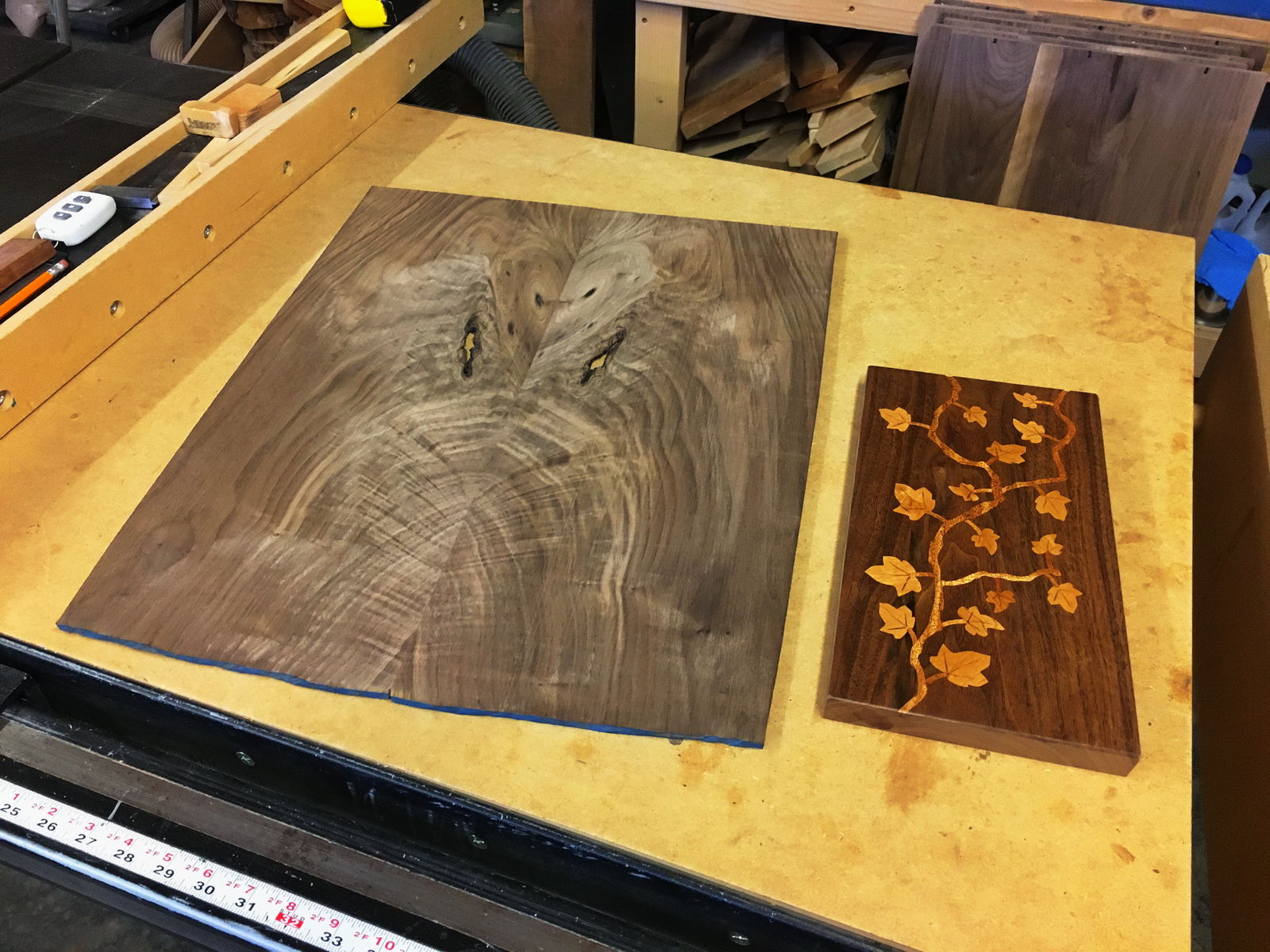

April 14, 20206 yr comment_225075 Practice inlay piece to test technique for a larger project. This is Walnut, African Mahogany, and Cherry. It’s 12” x 6”. Pockets and inlay pieces were drawn freehand in Fusion 360, cut on the CNC, then each piece hand filed and fitted. Leaf veins were cut by hand, as well. Finish is 2 lb. cut Shellac and applied with French polish method. Veins are highlighted with Mohawk Van Dyke Brown glazing stain. Finish took about 20 minutes from bare wood. Enjoy! David Report

April 14, 20206 yr Author comment_225128 Thought I'd show you the target project board and the practice piece together - David Report
May 27, 20206 yr comment_230248 Well the practice piece was awesome and I’m loving that book match walnut piece. Report
