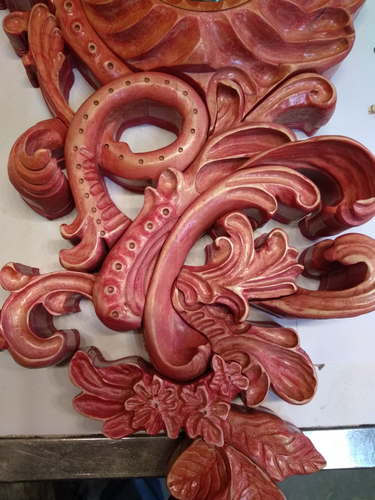

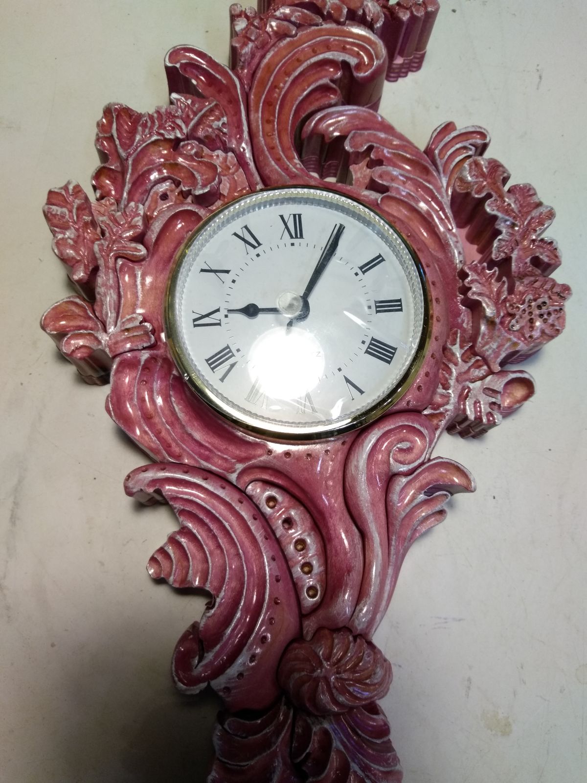

April 11, 20206 yr comment_224818 Not all the things I build are colored in the same manner. How I want it to look tells me what to do..This last clock I filled up a large pan and submerged all the pieces for a while. And to get a different texture on different places I just set the pieces out without drying off any of the stain. Then after they dried I used some 220 and sanded off the top edges to make it look like it had been dusted for many years. And I think this picture was when I first started sanding off the edges so the end piece got even more finish removed. Then on some pieces after a coat of clear has dried I go back with an air brush or my finger and tint the edges with a different color or with many different colors. So not every one needs an air brush or a joiner if they think their table saw will do the same thing?? Not every body skins a rabbit the same way. Edited April 11, 20206 yr by Smallpatch Report

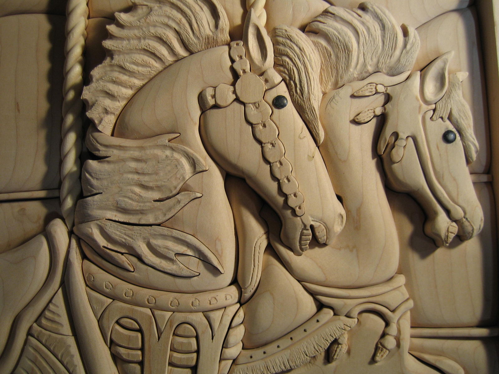

April 12, 20206 yr comment_224879 Great on the band saw.. It will save lots of hours of labor...Most women female ladies knows about labor. I would think a waitress in a restaurant probably works harder than any three men... I will suggest after you cut the pieces out of your picture to mark the back sides of all the pieces.. It will save grinding away on the wrong side of a piece only to find you were grinding the back side instead of the right side....The very good reason I now mark the back sides...With the picture shaded you can see almost all the pieces are a different height and the ones that don't pertain to the horses have been shortened the most. I start with the maple being just over an inch thick and some pieces have been shortened to maybe 3/8's of an inch tall. Get wild in the variations in heights. I have found its better go grind both pieces that touch each other farther down and it makes it harder to see the picture is actually individual pieces. After I get all pieces ground some what I take a picture of it and post it so I can see where more work needs to be done...Like on the ginger bread around the horses it seems like I missed lots of areas...I had to bring up some horses pictures to actually see what it was I was trying to do... Only cut the top side off the wood with the band saw. This way all the bottoms will still be on the bottom and will mate up with each other. Yes there will be lots of band saw marks to sand off but that's how to keep all the pieces matched up with each other. I use a 1" x 42" belt-disk sander for about half of all the shaping of the pieces. And if you only have one of those then the 36 grit is used more than a fine grade belt. I have two so the other belt is an 80 grit. I also use an electric hand held sander, the old type, and I turn it up side down laying on a rubber pad and holding it with one hand upside down I sand most all the pieces smooth. I doubt if anyone is smart enough to do this but me...but it sure saves lots of elbow grease...I also use a 9" oscillating drum sander to do the start of the shaping along with the 1 x 42" belt. The more ultra small areas I use my Dremel but no Dremel bits..Wood Carvers Supply, Inc in Florida has all the very long lasting bits I use every day and they are hard to wear out..And no need to order a set of any of the bits for some of the set you will never use so a waste of money. I can give you some numbers of the bits I like to use but do look up their site and look over their stuff. I started doing this carving thing in 2016 and swore up and down I would never do anything flat anymore...I have built flat things since I was in high school, 50 to 54 and the longer it went the more boring it became..Lots of years experience but some kind of carving is what I like. Do be careful with the band saw for slicing off small parts is also time to be using push sticks and things to keep the piece to be cut against the fence all the time. Just because its small don't over look the danger. And remember throw away the top side of each piece being cut down. It only takes from 20 to 50 lbs of pressure for an air brush. An older compressor that has a separate motor with a belt between the motor and the pump is the longest lasting and the quietest sound you can get. There are lots of older 20 gallon tank and pumps out there.. And you need to invest in an air regulator and water trap to go in line before it gets to the air brush.. . The air brush will do wonders with you painting ability. Oh and don't forget if you have a Hobby Lobby you can get the coupon that will give you 40% off of any one item per day. If you don't have one close you could order on line but do check around for good prices. Do you have the ability to edge glue pieces of wood together for bigger projects. If so I can show you how I put the frames around the horses and the rooster and a few other things I made. Later Report
