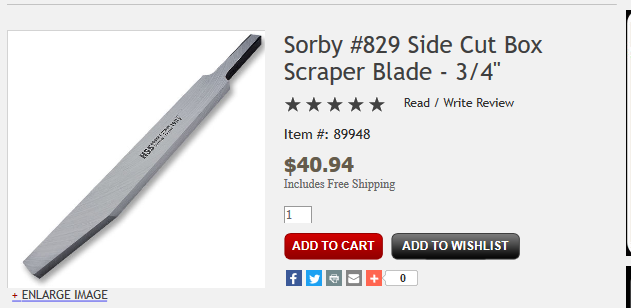

I thought that the 3rd tool down was for forming the spigot(tenon) on the bottom of a bowl, in preparation for gripping the bowl with a chuck?
Yes you could use it to make tenons, but way oversize for just that . A bedan or spindle gouge would be work easily. That long flat on the left side is used to scrape the inside of boxes and would not be needed for a tenon.290532691_FireShotCapture002-BuySorby8293_4-InchSideCutBoxScraperBlade-www.hartvilletool_com.png.3c3deb11775d3ab996285db533de3069.png
Thanks Gerald, I learned something today
