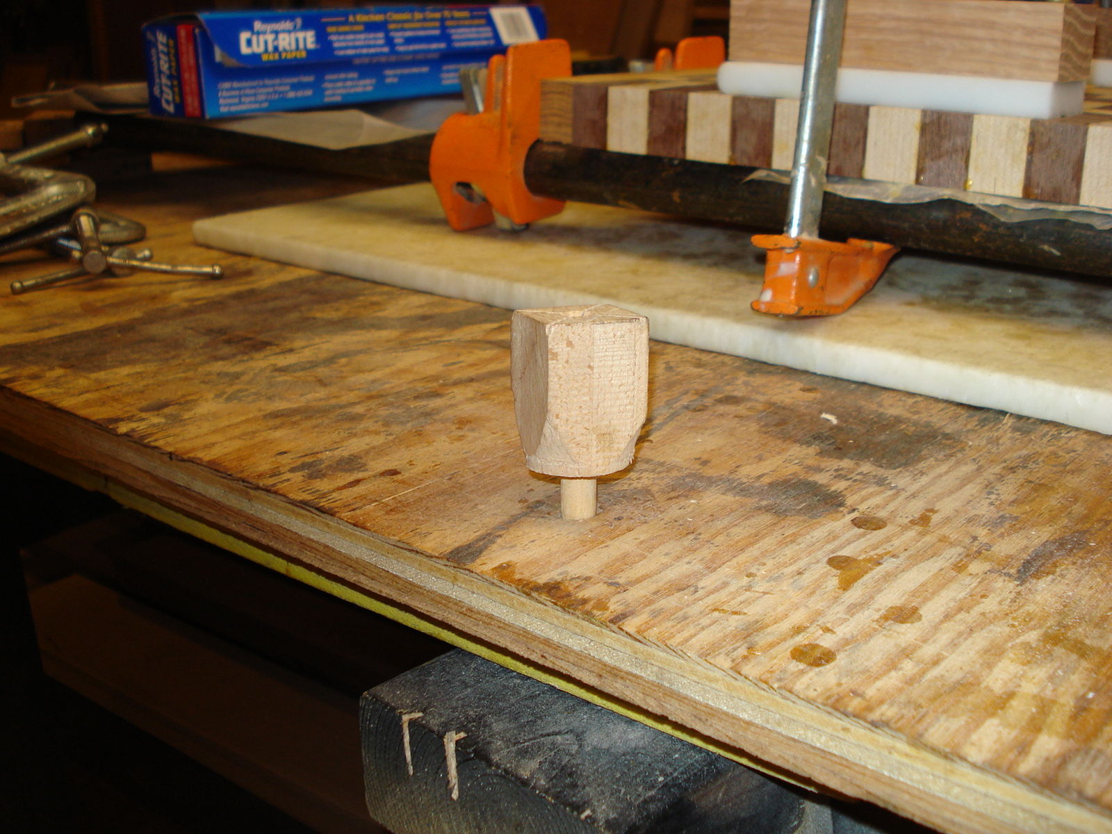

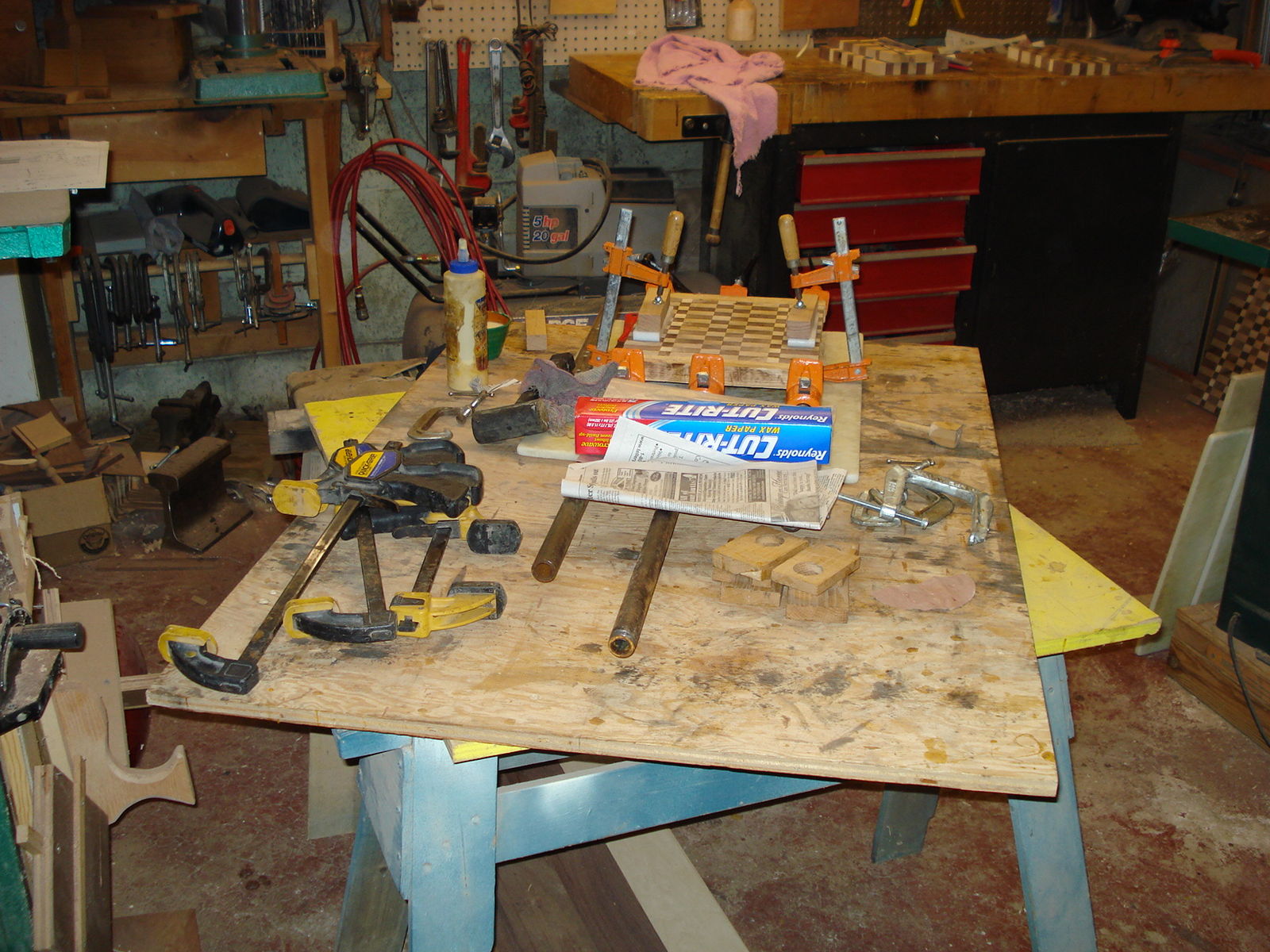

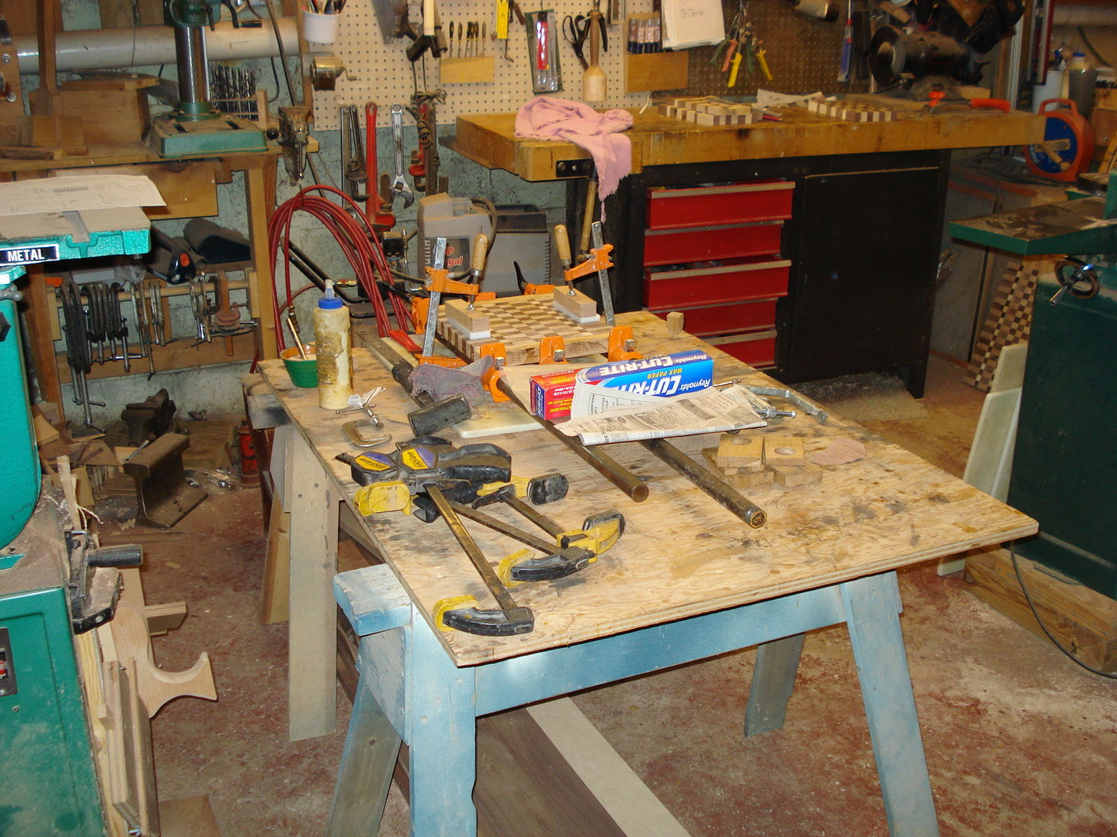

This is mine- although I would like to make it with an interior door- it's a "lazy susan" type of top so I can easily swivel the project instead of walking halfway around the shop to get to another vantage point. It sets on 2 saw horses.
I added a peg locking system to keep it stationary, if needed.
About the only thing that I need to clean off are glue drops and a paint scraper takes care of that.

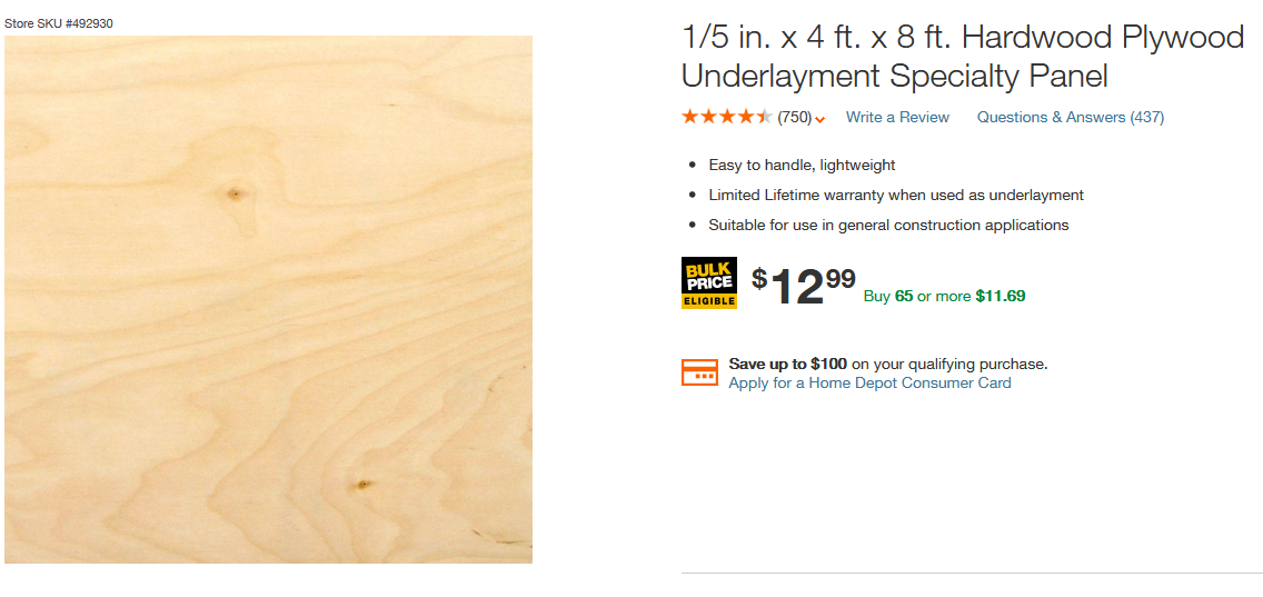

Home Depot carries hardwood underlayment that you may want to look at.

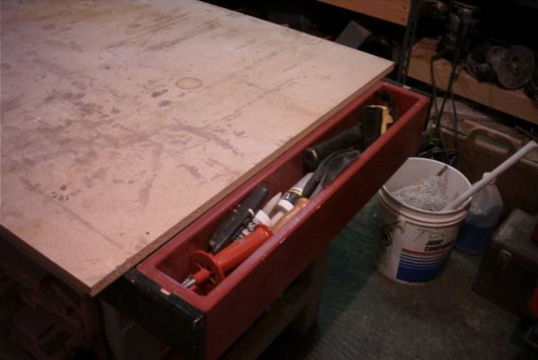

My first benchtop was a pocket door on sawhorses.  The same pocket door now rests on a wheeled table base, but is still my main work surface after about 16 years.  Sanded, filled some holes, repainted.  For almost a year I had a foam cover; I also tried brown paper, plastic table cloths.  My intention was always that the pocket door itself was sacrificial, but it has never worn to the point of replacement, so it has the place of pride as the oldest thing in the shop.
