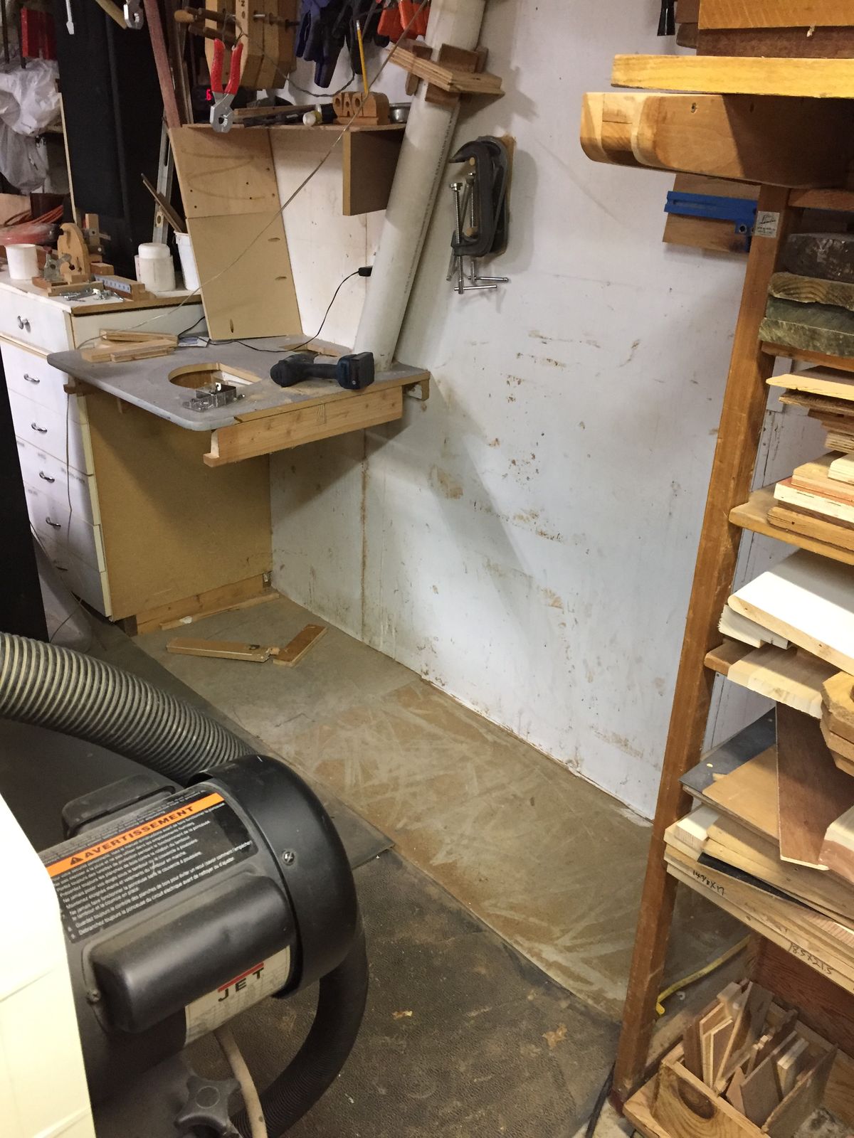

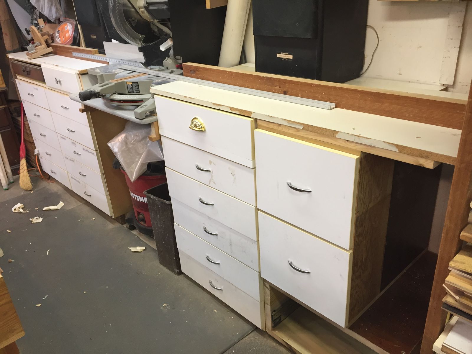

This is what happened yesterday. Removed old drawers next to CMS. That was a job. Did not remember putting that many screws in the CMS shelf.
This is what came out.

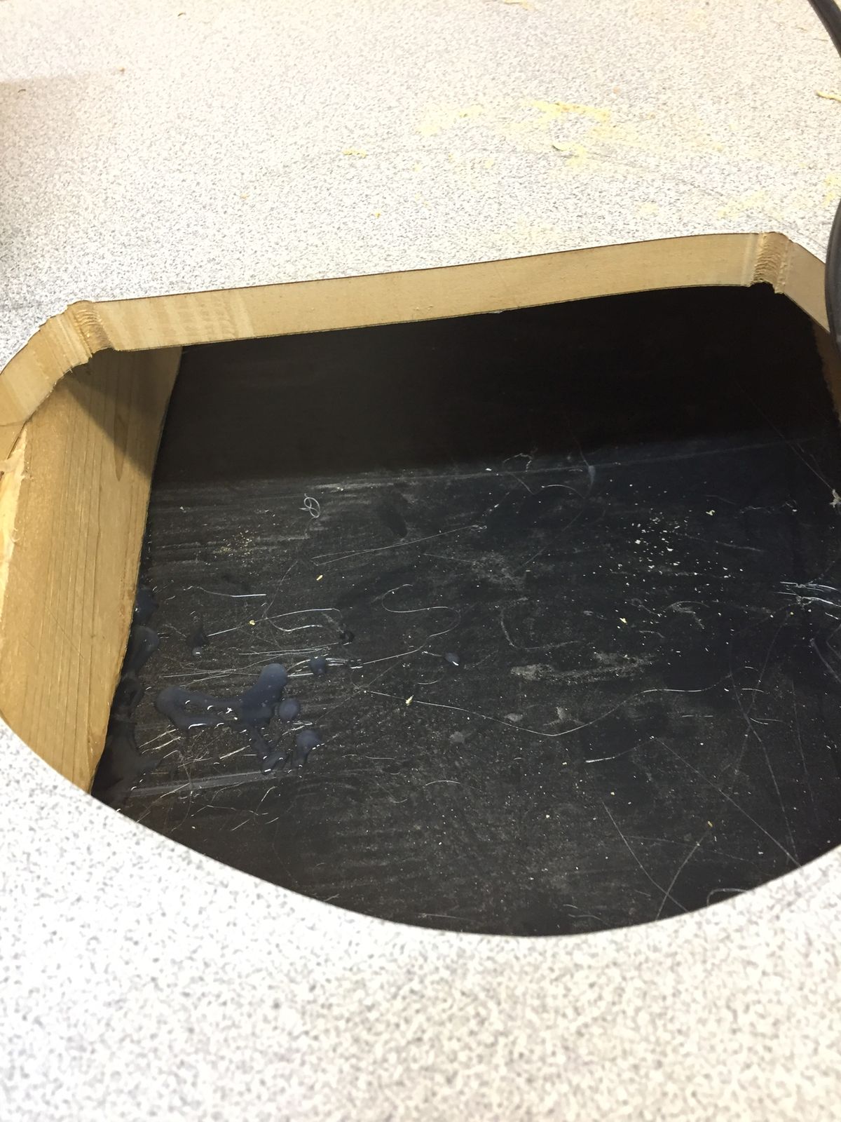

This is the hole now to be filled and to rebuild the CMS shelf and dust collection.

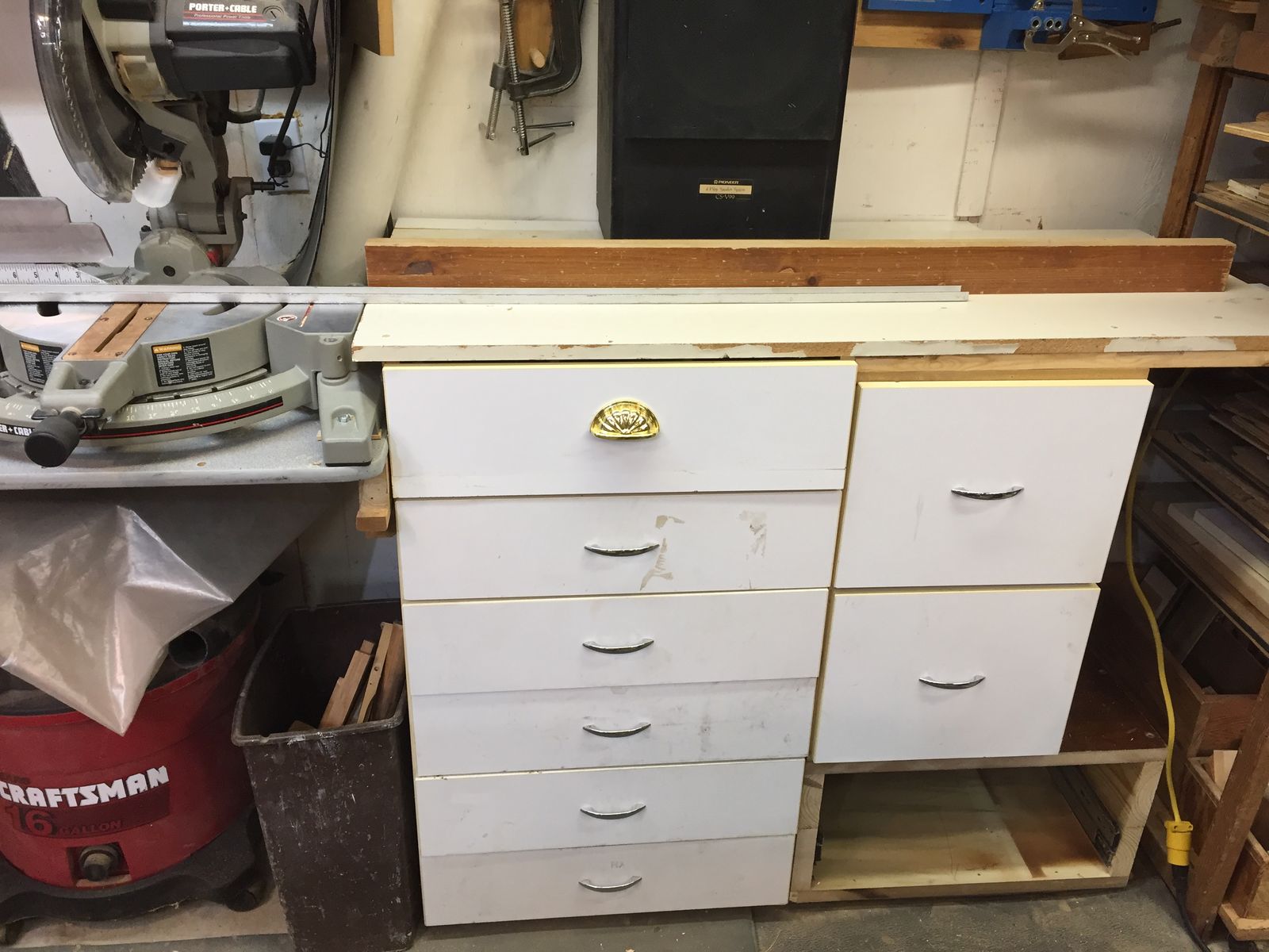

Today’s results . Got the drawer unit in place and the extra drawer installed. Started working on the DC under the CMS and made some pretty good progress there.
Tomorrow hope to finish CMS setup and get started on the drawers in last section.

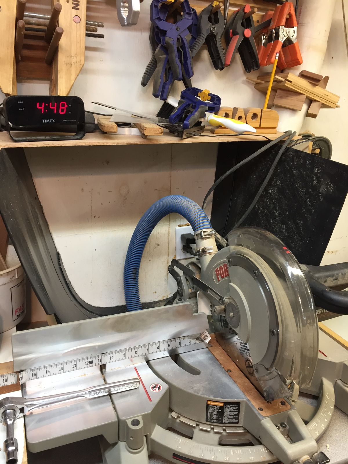

Today got the DC work done and reinstalled the CMS. Got the drawer face on that top drawer. Now on to the last section. Searching for materials to build that with.

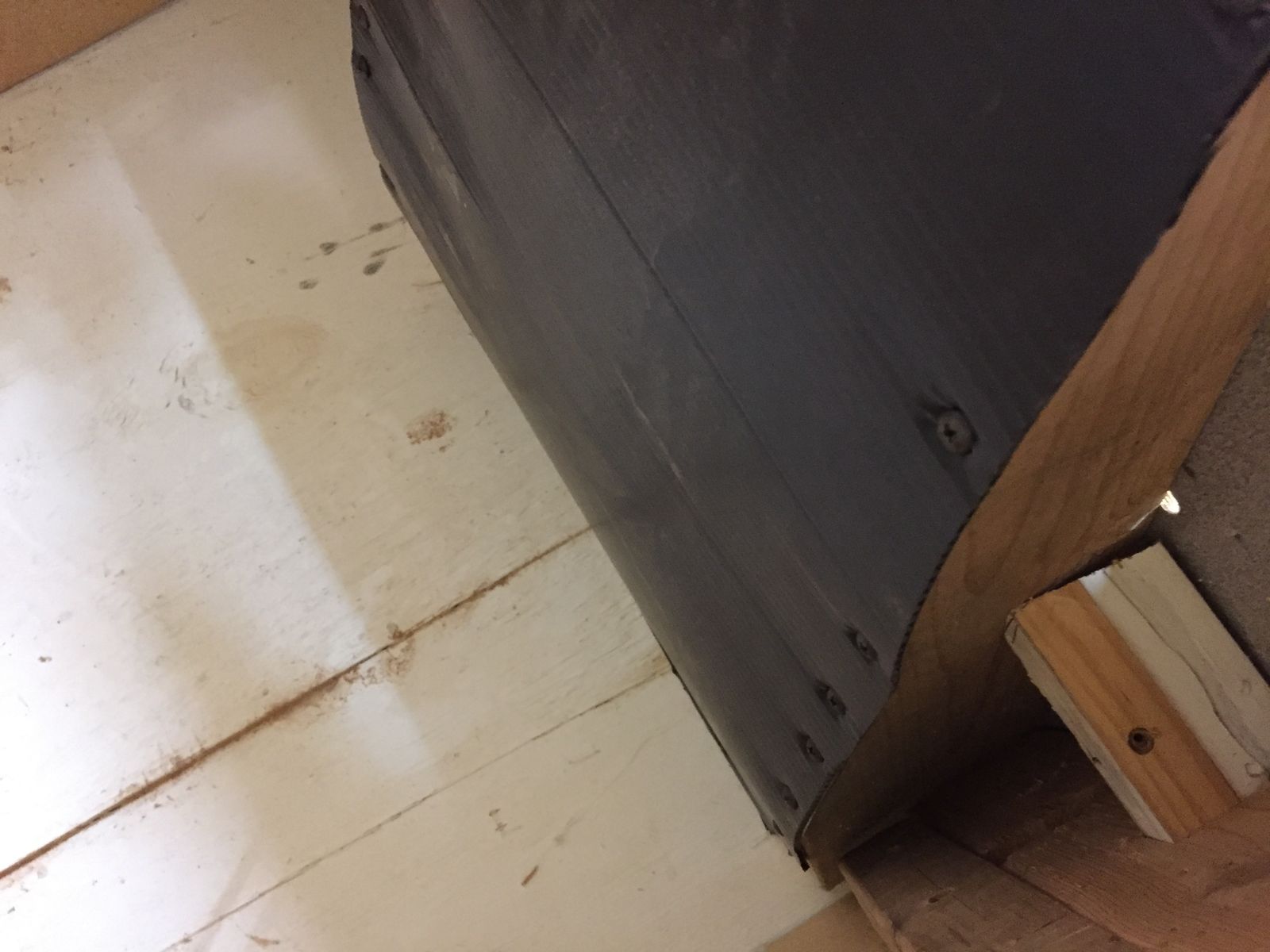

This is the dust collection box from underneath. I used corrugated plastic to cover the bottom after cutting the frame to slope to the back. Used hot glue to seal and stick the plastic to wood.
This is looking down down into the box under the saw.
Aw is installed and you can see the plastic I put behind it to guide dust to the box.

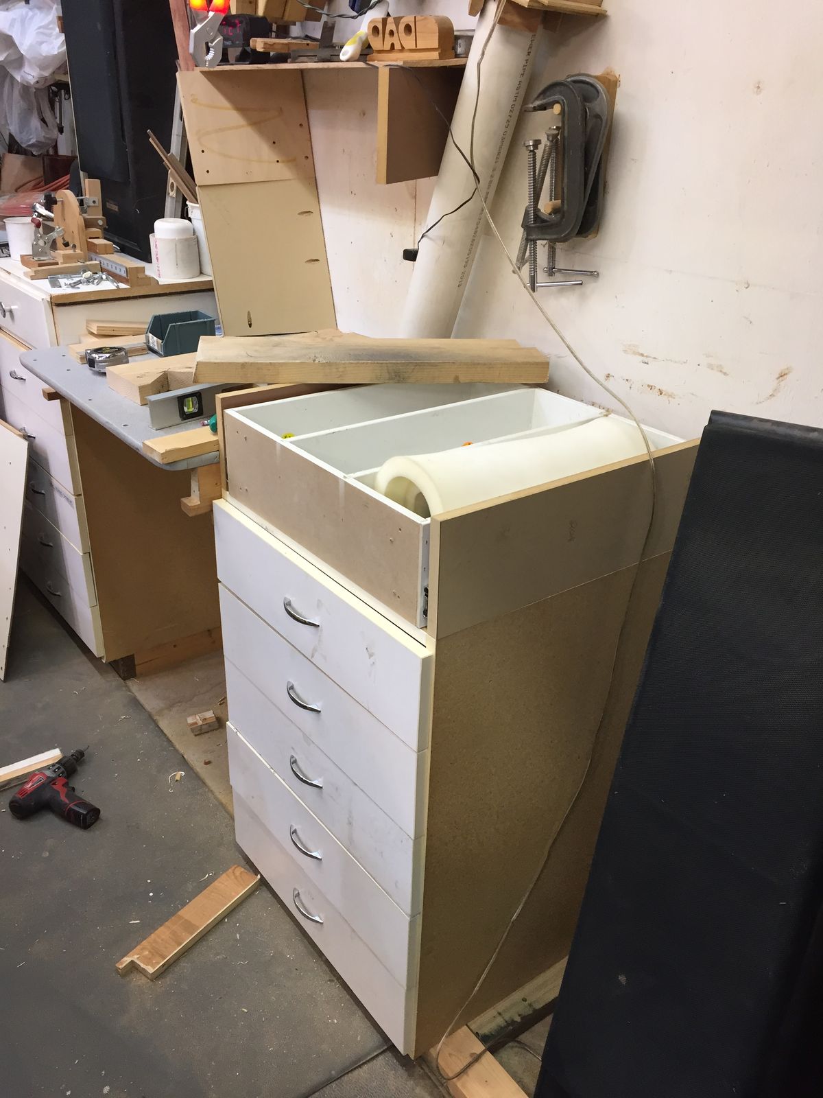

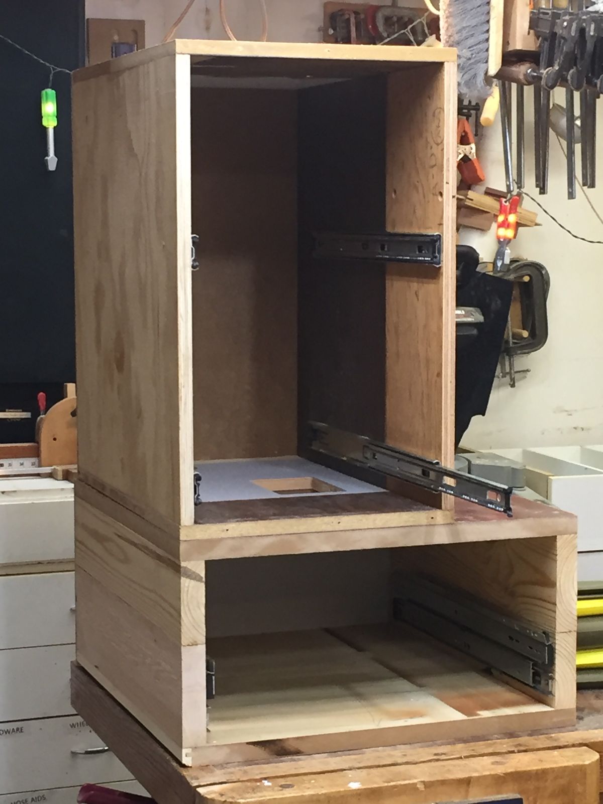

Today got everything put together except two more drawers I will have to make. E682A116-7A91-4C8C-B3B2-6D66C9D32FC0.jpeg.8cac5534616812b6cd8201feba4c4c95.jpeg

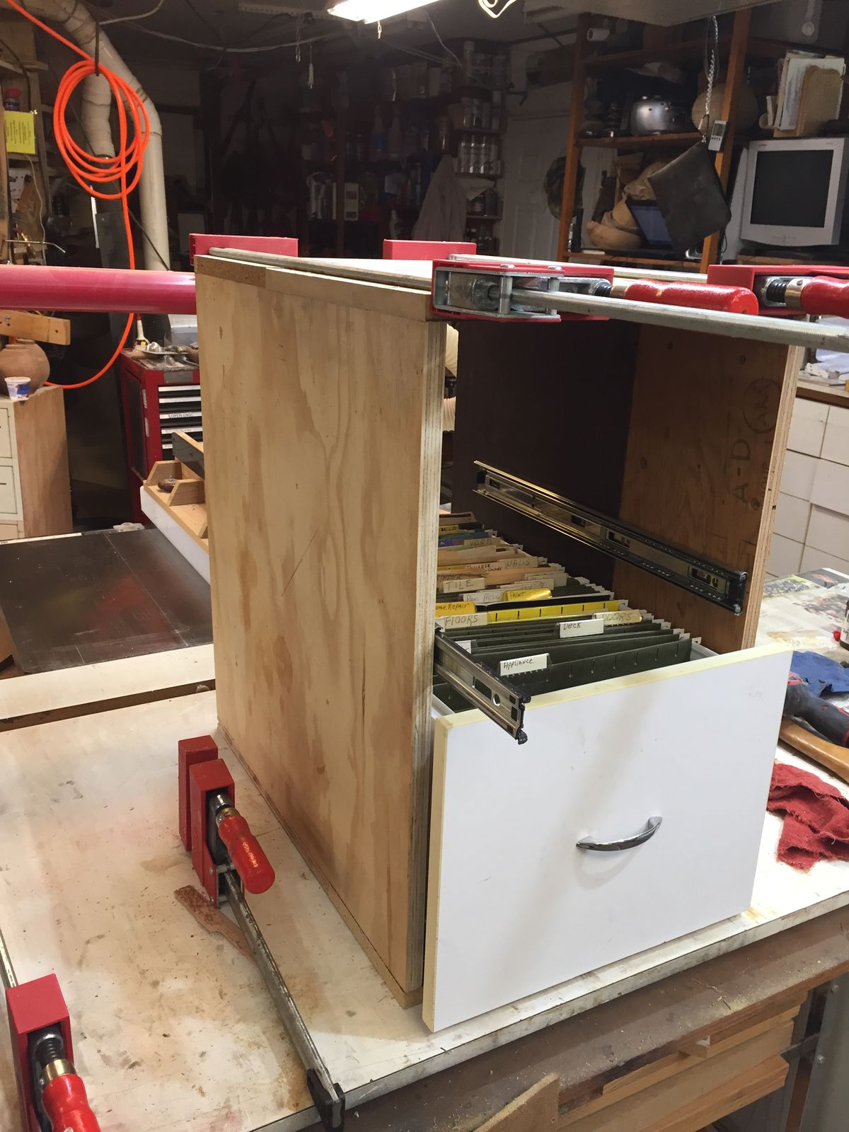

This is the box box for the file drawers.
These are are the two drawer boxes I finished today. That bottom is a bit thick since I used an old recycle desktop and some 2x stock I had.
This is the installed position.

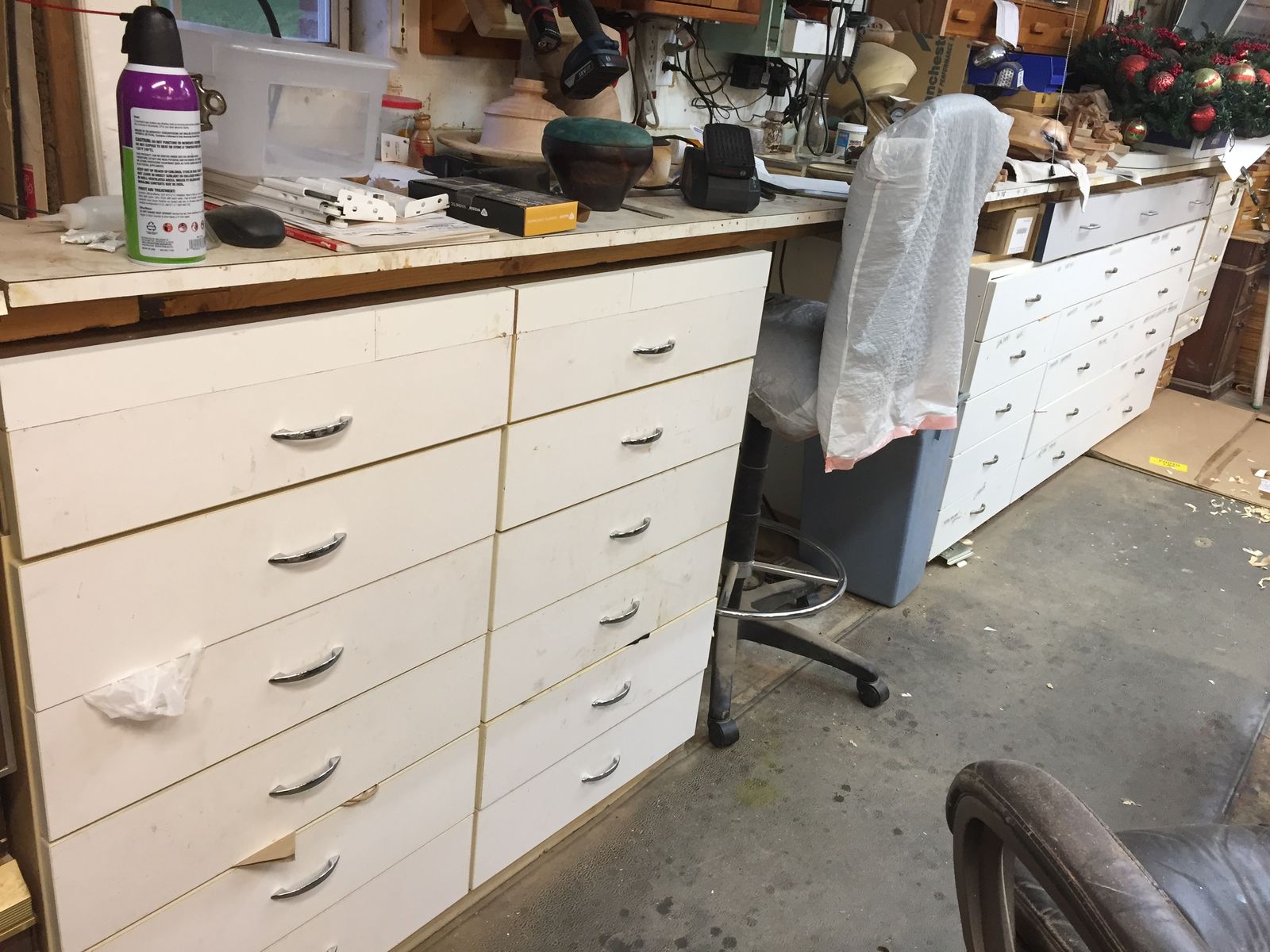

This is is a pic of the drawer units on the back wall.
At the front are drawers I installed first and on past those my burning and carving station and the rest of the drawers.
