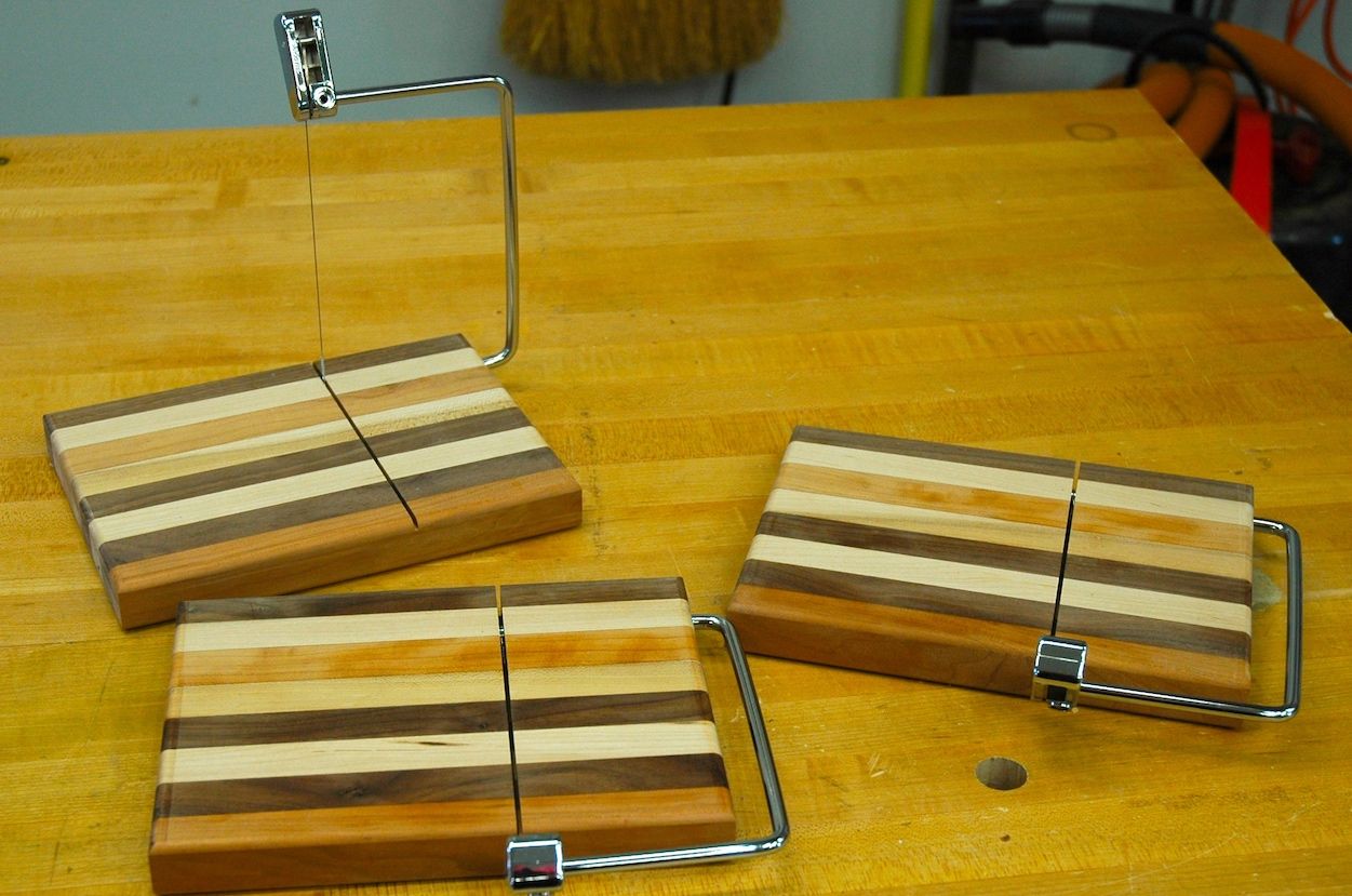

February 22, 20206 yr Popular Post comment_219459 I had asked about cheeseboard hardware over a year ago....and I just now got around to making some. This started out as making one for us, but it's as easy to make several as one once you get started. So, I have these extras that will go to a local thrift store, the sales there support their food bank. Here's my question: I would like to type up a little note about the care of the board...maybe something more than "do not put in dishwasher", I'd like ti include info like "renew with mineral oil" and other care tips with which I'm unfamiliar. I know several of you sell stuff like this and cutting boards....do you include such a paper and what does it say? If I'm asking you to reveal one of your trade secrets I apologize . This little job occupied my time while I'm finishing my desk and waiting between coats for the varnish to cure. Edited February 22, 20206 yr by Fred W. Hargis Jr Report

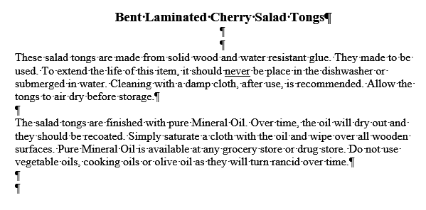

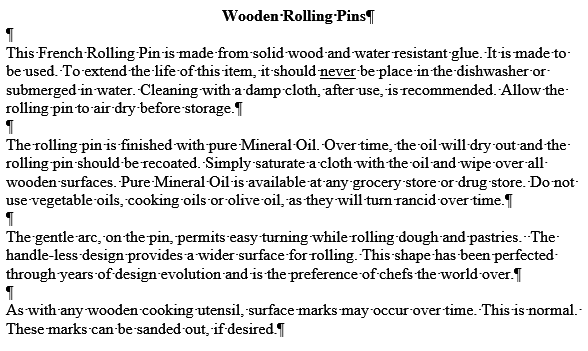

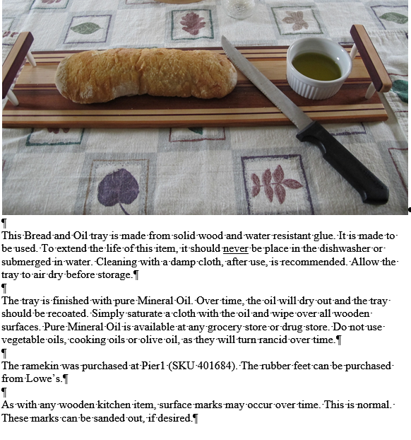

February 22, 20206 yr Popular Post comment_219475 These are some I use. They are similar but specialized for the item Report

February 22, 20206 yr Author Popular Post comment_219482 The hardware is made (marketed) by a company called Prodyne. I bought them from a specialty store out of Sheboygan WI. called CheeseSlicing, LLC. Imagine such a company surviving in WI! Anyway, they have all manner of well, cheese slicing stuff and hardware to make things like these boards. Prices are very good ($4.95 each for pack of 5), and she (Lisa Christian) is very nice to deal with. I ordered mine and she sent the wrong ones. But she noticed it before they got here and sent a second order with the correct ones immediately....asking only that I return the wrong ones at her expense. Report

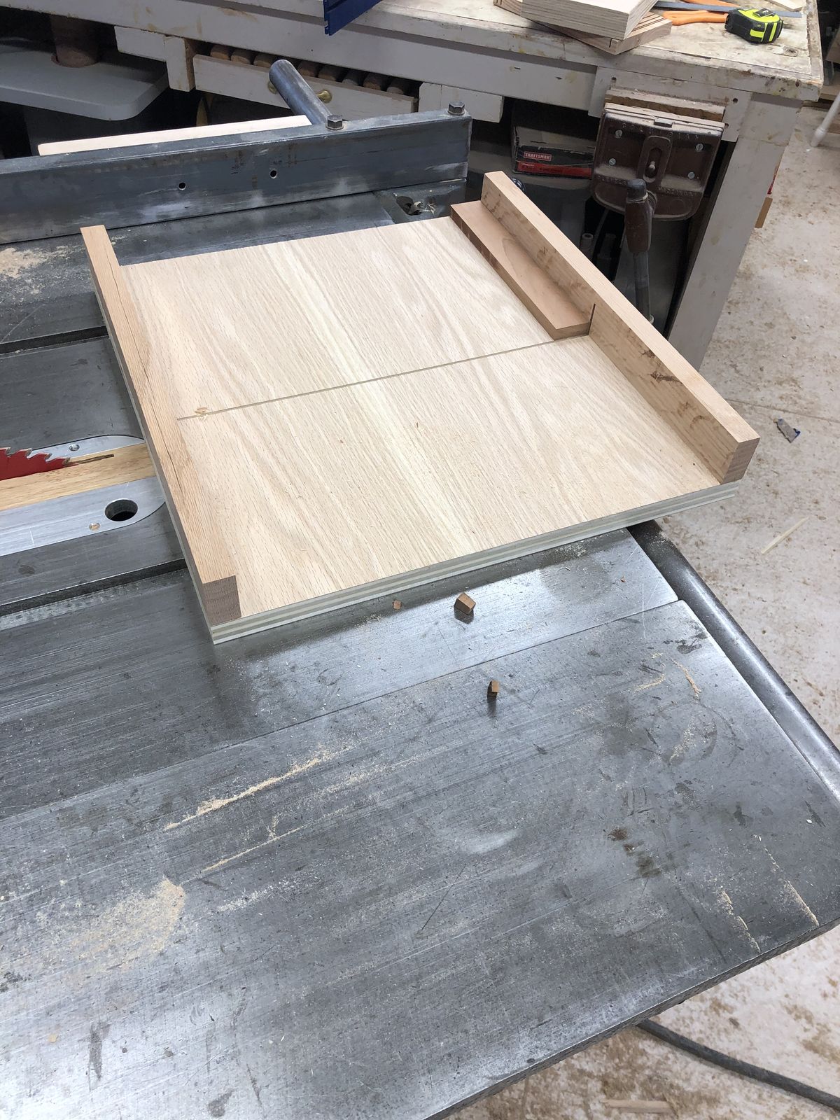

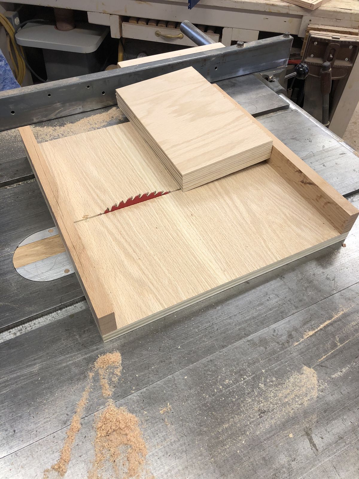

February 25, 20206 yr comment_219789 Fred and I have been messaging back and forth about how he cut the groove. Being a bit lazy, I decided to make a jig to mass produce them. Since the groove is tapered, I did a little math and added a 7/16” riser on the front of a the sled. Works perfectly on my makeshift plywood wannabe cutting board. When I get my hardware I’ll cut the real thing. Report
