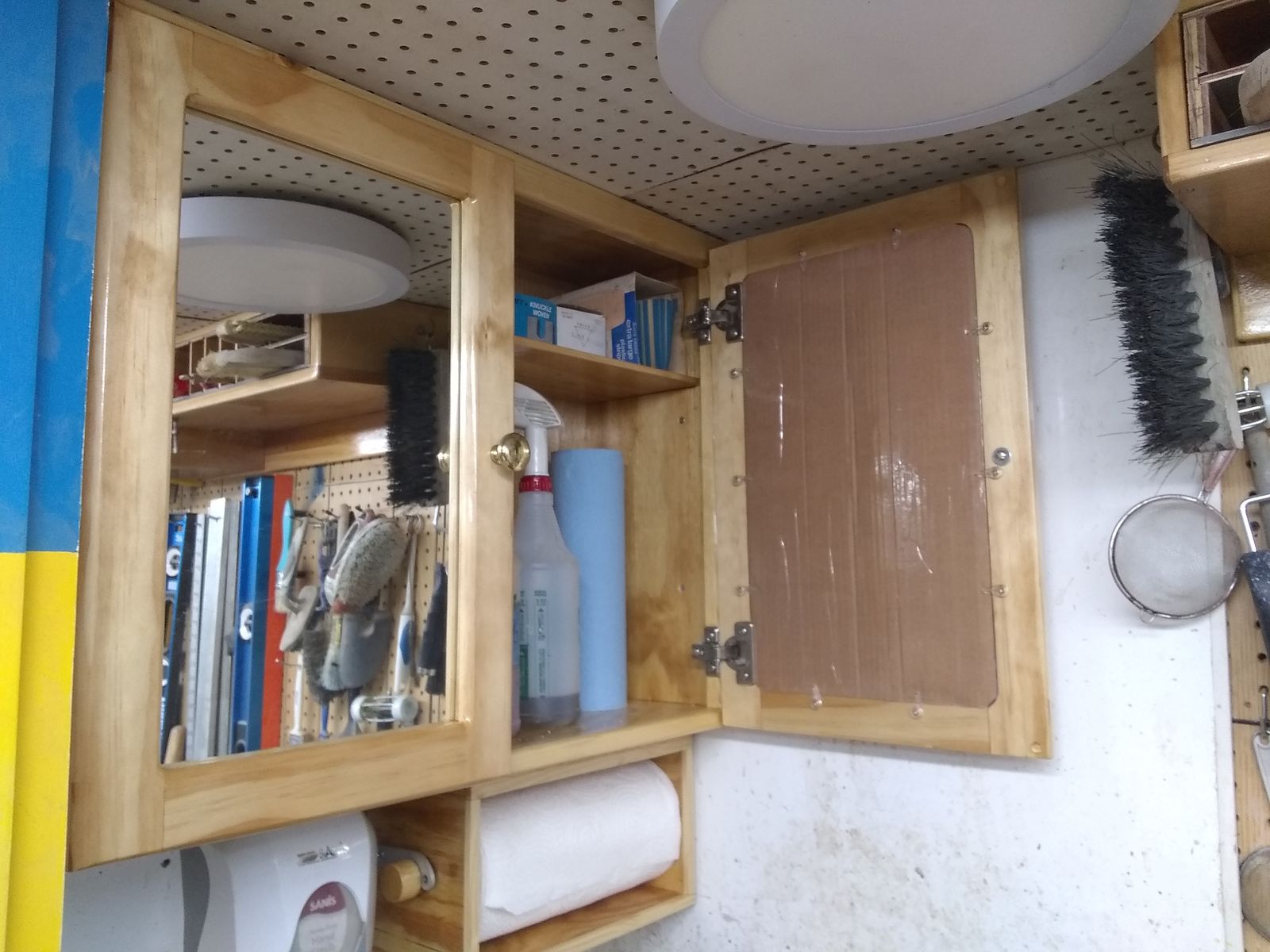

January 30, 20206 yr comment_217057 Hi all, been awhile since I posted - hope all is well with everyone. I have a question about a cabinet I built back in 2013 - here it is At the time the doors closed fine - but now they look like this - and no matter what I do with the hinges, I cannot get them to close properly. The entire cabinet is made of Baltic Birch, and sealed with several layers of poly. They dont seem to be warped (which I did not think baltic birch would do anyway). My novice opinion is that one of my levelers failed and the entire cabinet is wrenched, skewed, twisted - whatever the proper term would be. The cabinet is totally full with different books and other materials and I really hate to have to empty it unless I have too. So - what are your opinions? Thanks - it is weird how it is the top of one door and the bottom of the other door. Report

February 2, 20206 yr Author comment_217371 Thanks all - next time I head there to do some work gonna take a long straight edge to see if they are in fact warped - just seems strange to me they are in opposite directions - one on top - other on bottom. Seems more like somehow the cabinet got racked (JMHO) - but gonna check it out Thanks all! Report
