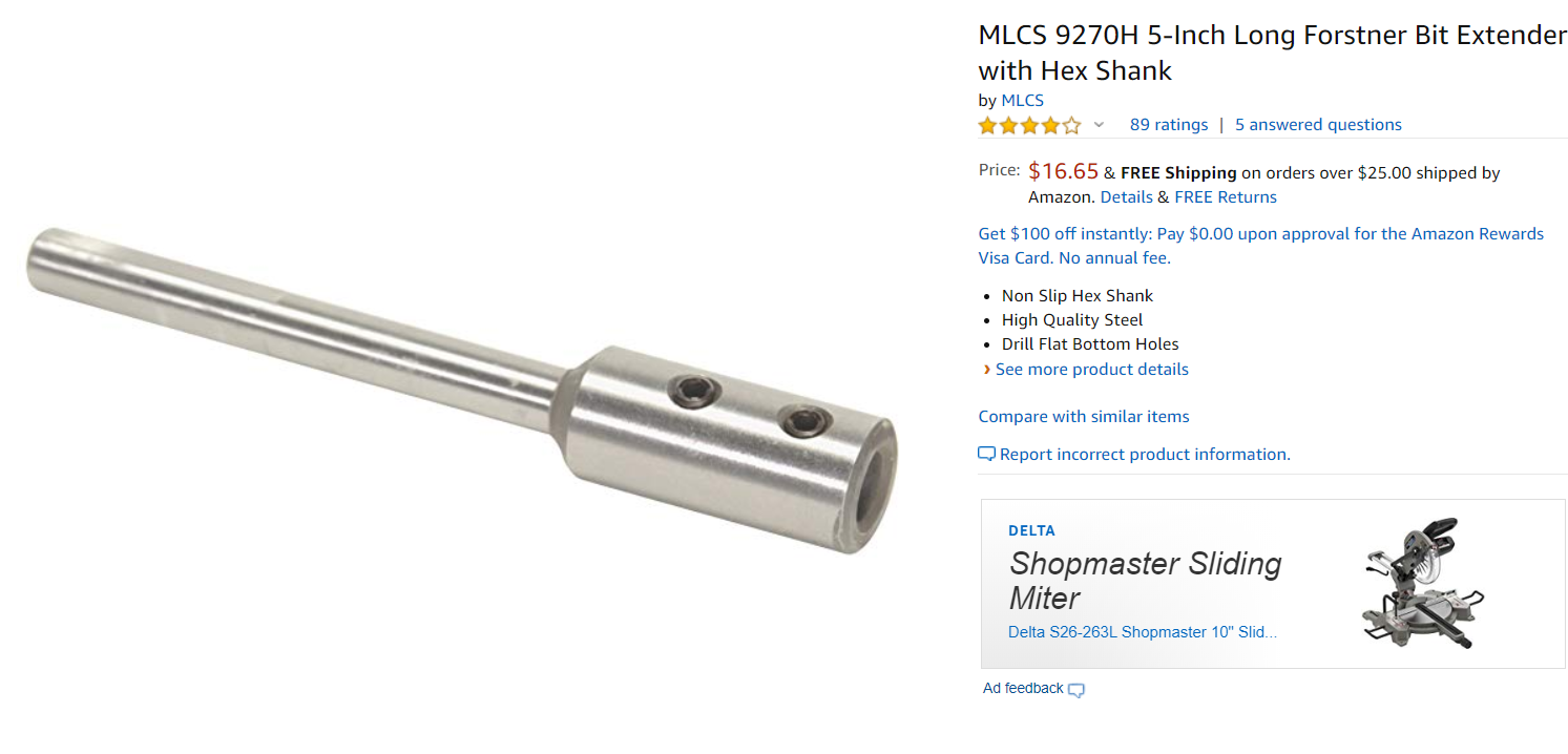

IF you are looking to extend the depth of the cut, perhaps you can purchase an extender.   Danl
Just a thought, I would buy just the diameters I need and then add to the set when a use for a new diameter arises. The extension that @Danl mentioned is they way to go for deeper boring.
from what i read some sets can not be extended like Irwin was one of the complaints in the reviews. thanks guys for taking the time to answer!!.

That's odd. Wonder why. The extension @Danl mentioned says it's specifically for Forstner bits.
It is a specific hole size for the shank of the bit but I don't know if all the bit shanks are supposed to be the same diameter.
Edited by HandyDan
I have a couple "orphans", not PCs like my set. They're the same shank size. But, that just might be the luck of the draw.
so you guys feel like Irwin set good if i get the adapter?? just making sure i understand correctly.
Irwins are good. Amazon sells an Irwin extension, too. From reading on Amazon, it seems Irwin shafts are hexagonal.
