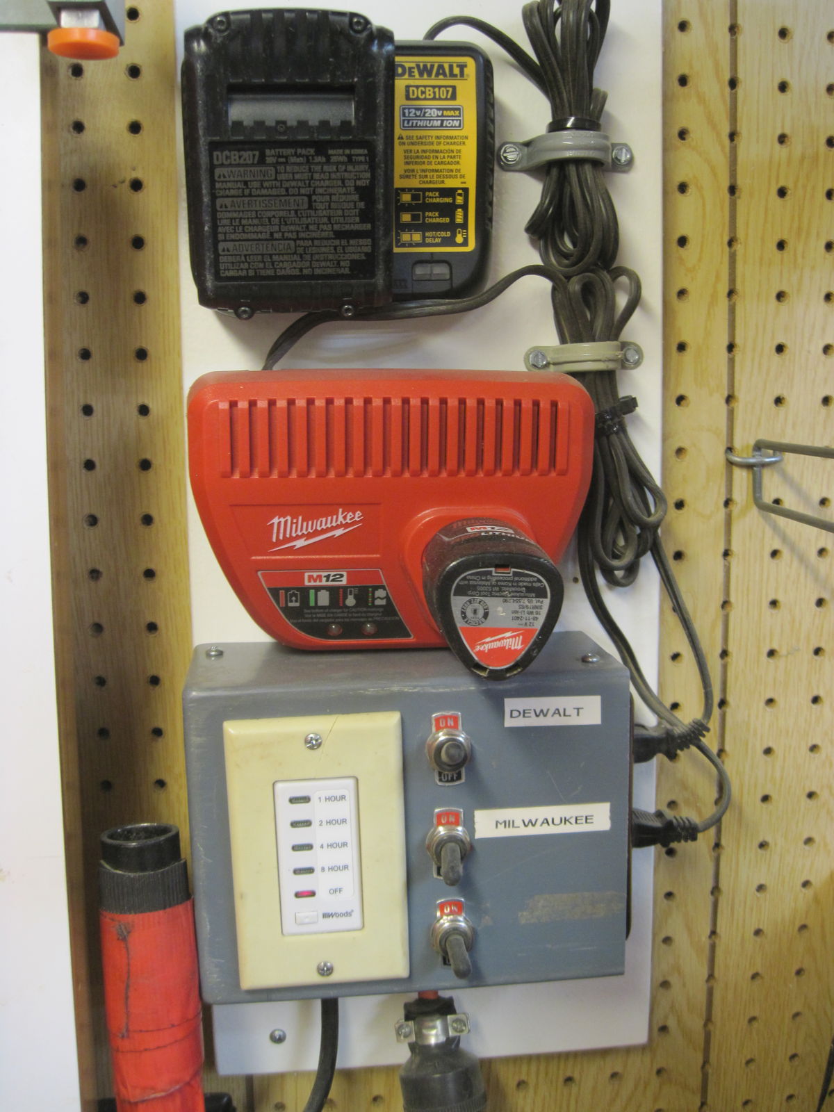

Never paid attention before though.  Now I don't plug mine into the wall. I have a timer with switches to each charger. So I hit the timer, toggle proper charger and walk away. Here at work don't have pictures.

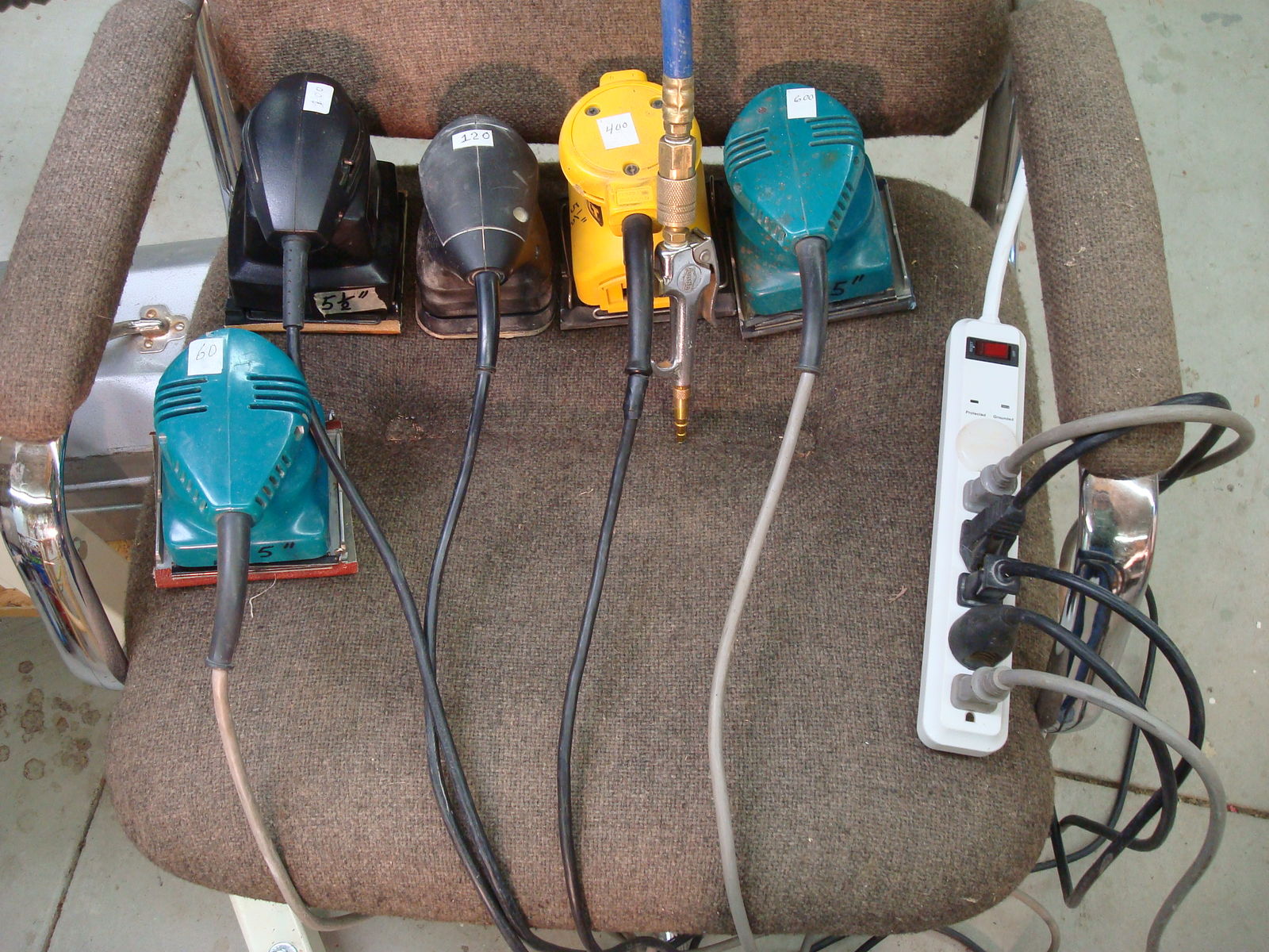

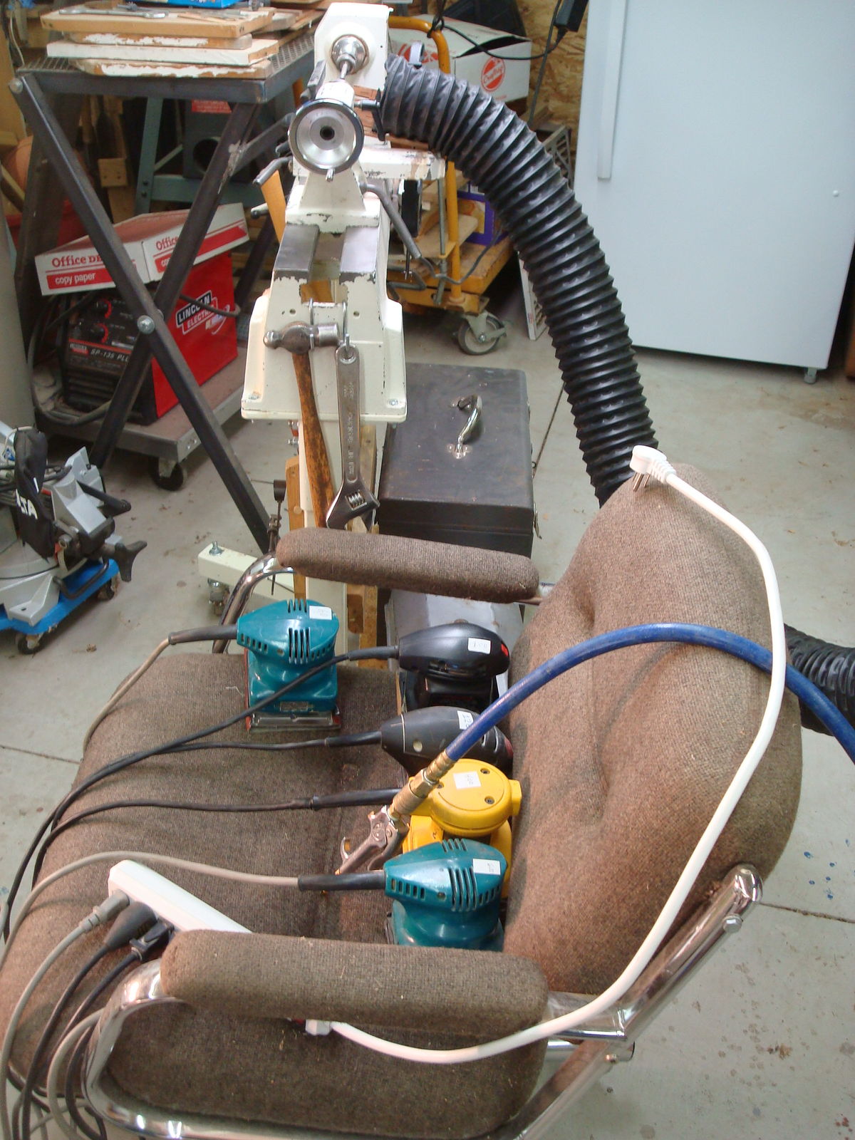

That makes me feel a little better. I also have 5 palm sanders plugged into a multi plug that has a lighted toggle switch. I flip the switch and then the sander I want to use. Then shut it off when done. I start out with the course and work my way up to the finer grit to finish. I have all sanders in a chair next to my lathe. I use then on pen blanks and I have had good luck so far. I have done 50 or so pens. I don't have to have to change sand paper all the time. I use my pressure blower after each grit and blow the pen blank and the sandpaper clean and move on. I will take a picture and post it. I have all 5 plugged in all the time but only use one at a time. I don't have enough hands for more.

Pictures

This is my charger set up with a timer.  This way when the timer goes off all the charger has no power so no topping off using up a charge the battery did not need.
