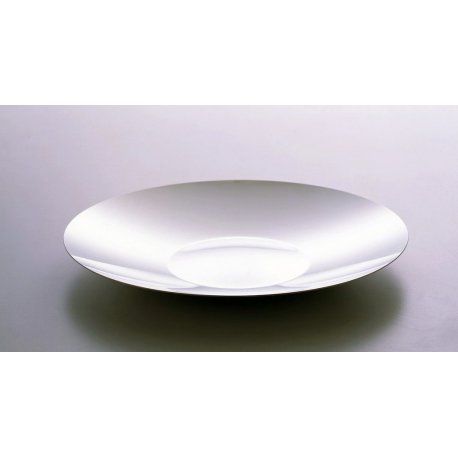

Gerald Posted December 24, 2019 Report Posted December 24, 2019 Not sure what you are trying to accomplish .For the kits sold to make this type bowl in many shapes you use a bottom bearing bit and a template. The template is mounted to the blank and then either a start hole is drilled or the blank can be lowered into the bit. Then it is just a matter of routing out the inside with the bearing riding on the template. DuckSoup 1 Quote
Gene Howe Posted December 24, 2019 Report Posted December 24, 2019 9 hours ago, Gerald said: Not sure what you are trying to accomplish .For the kits sold to make this type bowl in many shapes you use a bottom bearing bit and a template. The template is mounted to the blank and then either a start hole is drilled or the blank can be lowered into the bit. Then it is just a matter of routing out the inside with the bearing riding on the template. That's how my candy dishes are made. But, you only get straight sides. I think Jack wants a dish/shallow bowl effect. Quote
BillyJack Posted December 24, 2019 Author Report Posted December 24, 2019 (edited) 11 hours ago, Gerald said: Not sure what you are trying to accomplish .For the kits sold to make this type bowl in many shapes you use a bottom bearing bit and a template. The template is mounted to the blank and then either a start hole is drilled or the blank can be lowered into the bit. Then it is just a matter of routing out the inside with the bearing riding on the template. There ae no kits for this that I have every seen.. This jig was introduced on Woodnet by a guy who was going to get it patented. Don't think it ever happened. MAZORLOF or something was his name. Ths is a shallow key or change type bowl. It doesn't have a sharp radius from a router that you are thinking. Shallow as in the picture with no flats in the bottom... Edited December 24, 2019 by BillyJack Quote
BillyJack Posted December 24, 2019 Author Report Posted December 24, 2019 (edited) You can't use a lathe...look at the pictures in the big inning post... Edited December 24, 2019 by BillyJack Quote
