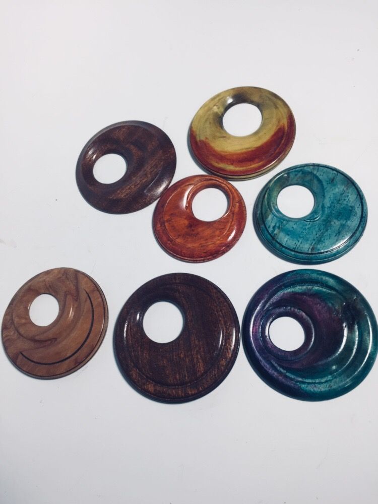

November 2, 20197 yr Popular Post comment_207319 Had been planning to do this since last Christmas and today I got into it big time. I got the Ron Browns Best Off Center Chuck for last Christmas and have only used a couple times. After using tape, CA decided hot glue was faster to glue blank to sacrificial face plate. Did several at once by turning the overall disc straight on lathe and then put on Off Center. Designs are as varied as you mind can make them . For these will use a loop in the leather necklace and also turn a couple beads for either side. May get pinch bails for solid pendants with art design and dyes later. Backs not not finished yet so there are some fuzzies. Report

November 6, 20197 yr Author Popular Post comment_207810 These are the first finished pendants. Now will be working on beads . I do not plan to add finish to them , just carnuba wax right now. What is the opinion on Slellawax? Report
November 6, 20197 yr comment_207813 I have had good success with it. But someone sent me a hard bar of Carnuba wax for pens and small stuff. That stuff is pretty good. Report

November 7, 20196 yr Author comment_207893 Dan that is just a burn in wire . There is just enough lip to catch I think on a couple I had to use a piece of sharpened Formica. Report
