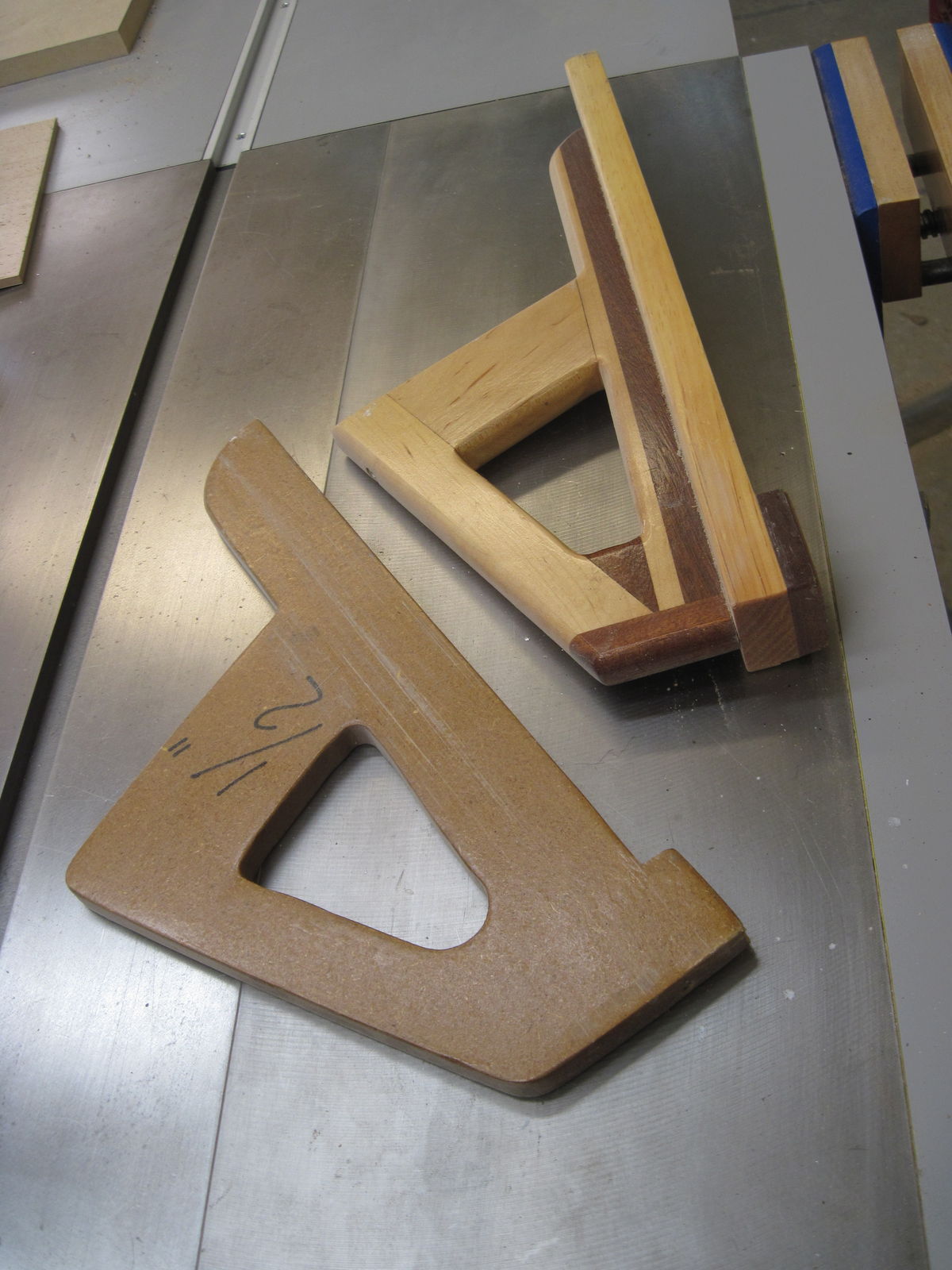

November 1, 20197 yr comment_207284 Nice you remembered buying them Artie! I have used one and they work good. Had a issue with holding it so made push sticks that accommodated my wrist. Report
