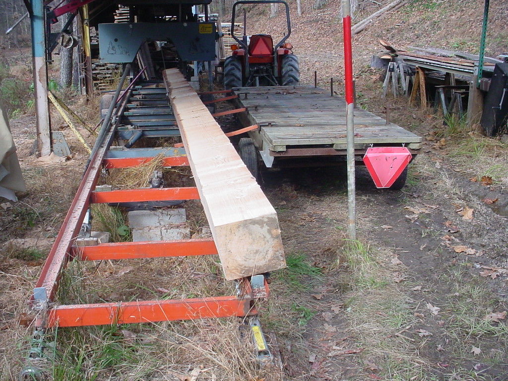

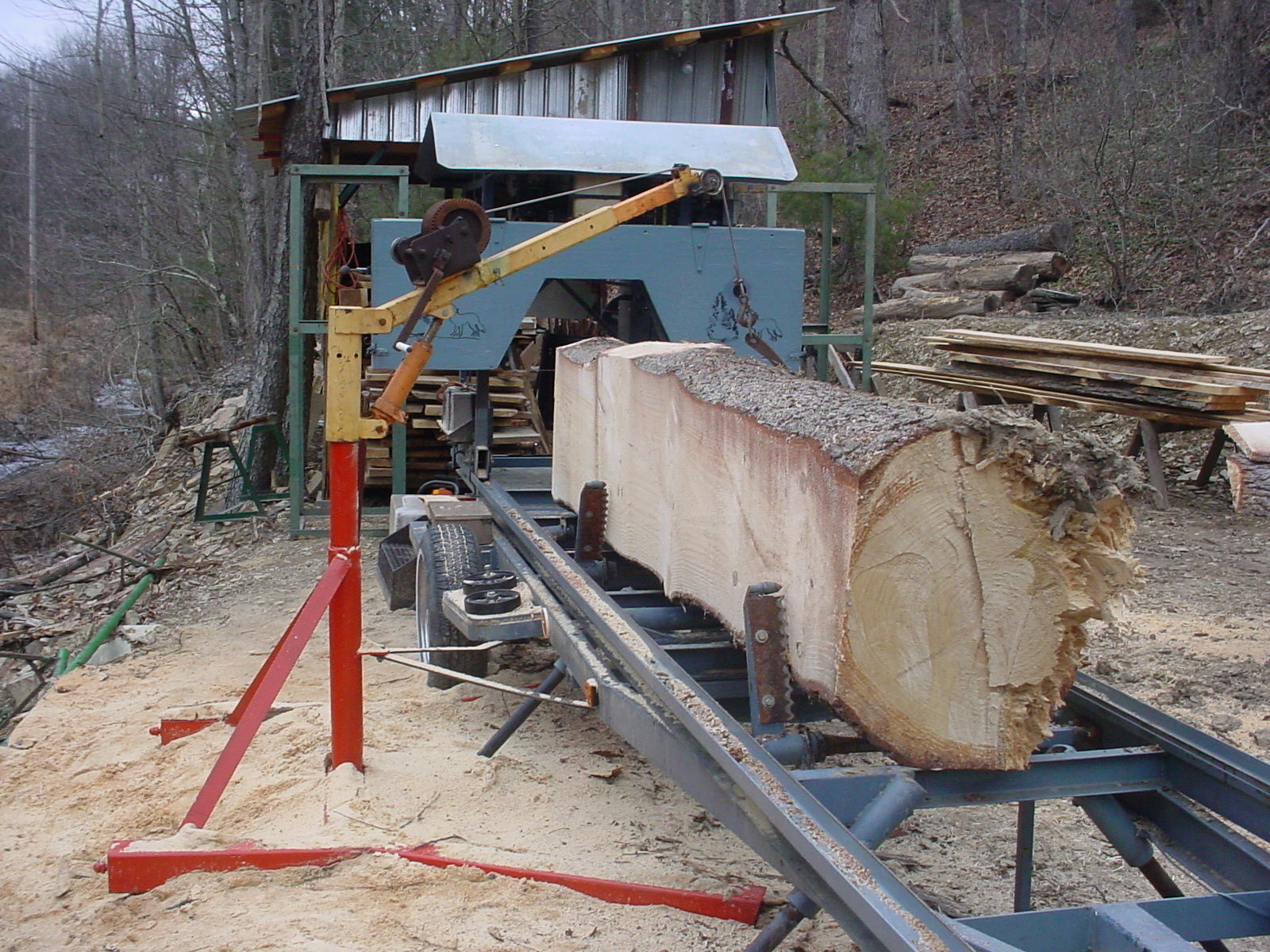

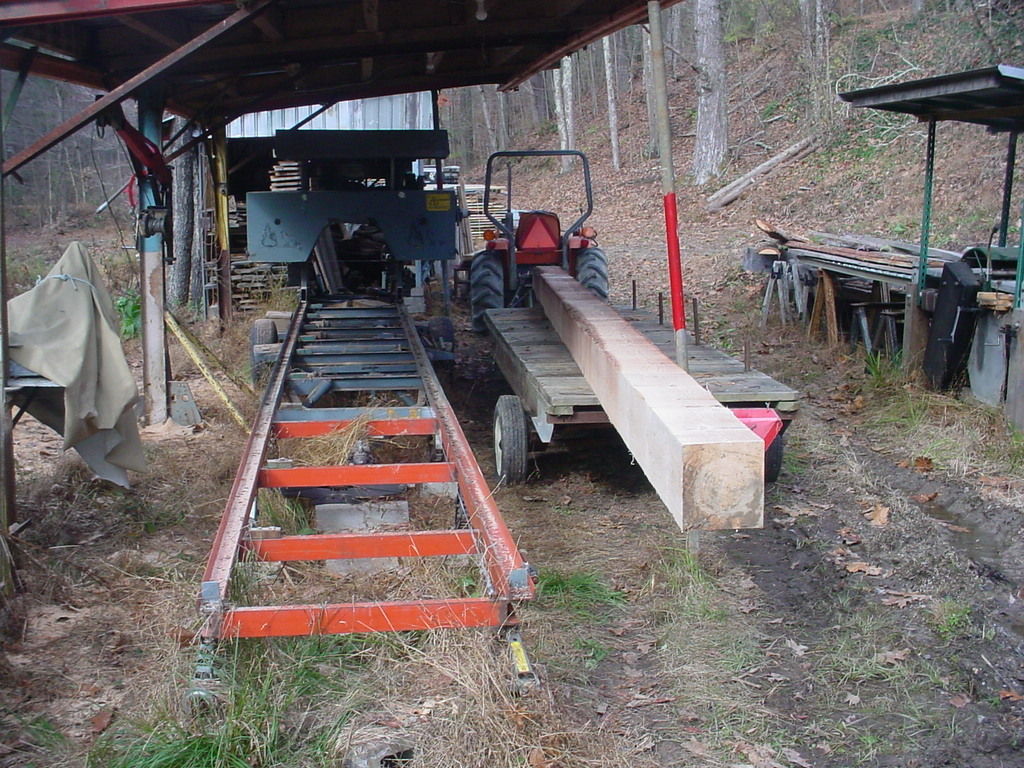

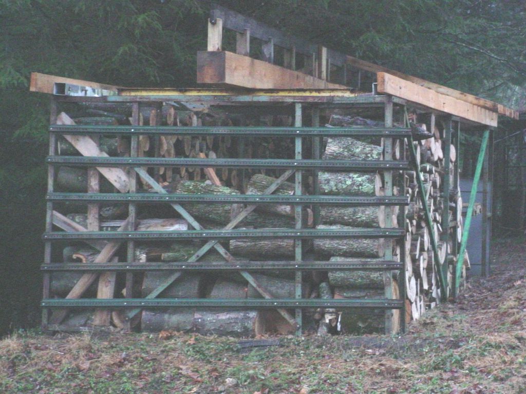

November 4, 20197 yr Author comment_207642 As someone on here says... I have the ways.... I made a rolling log deck. Report

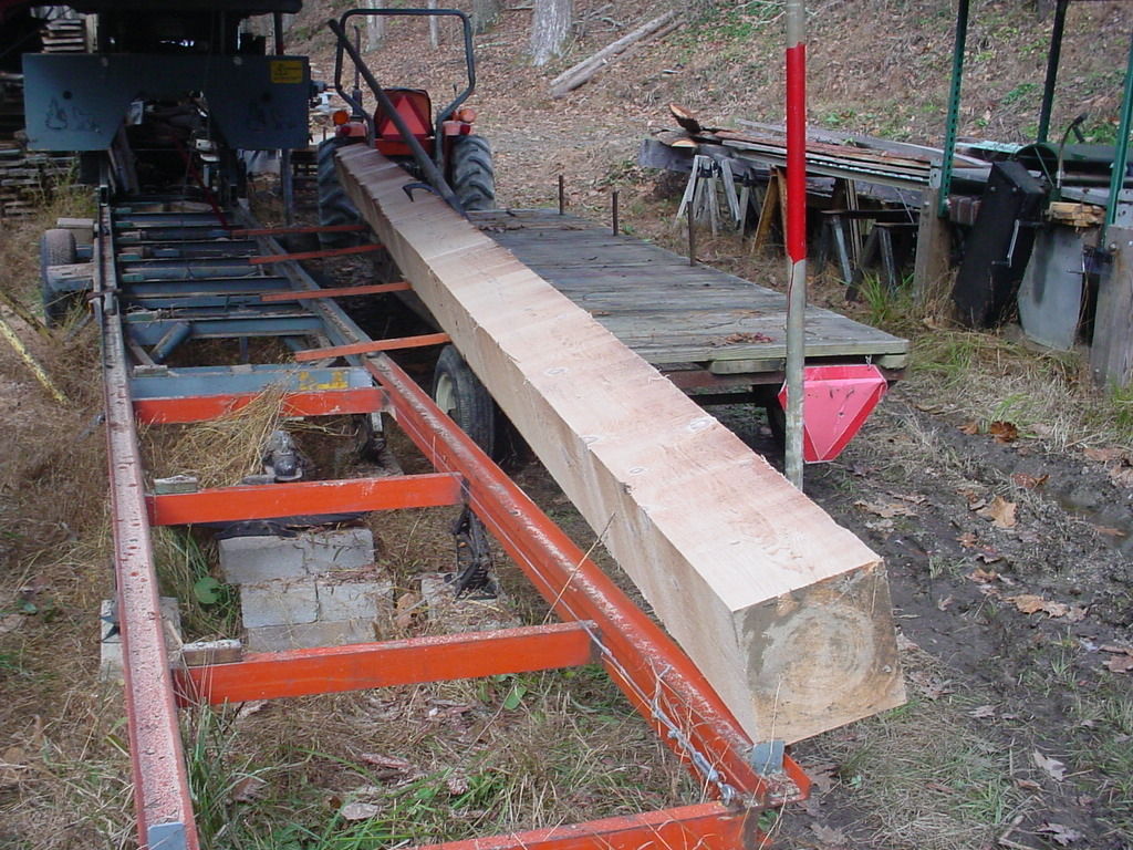

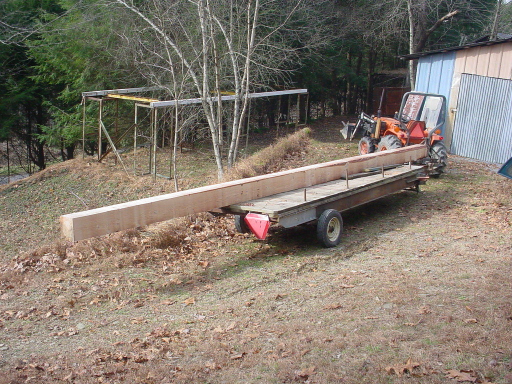

November 4, 20197 yr comment_207688 14 hours ago, Kevin Beitz said: Anyone want to help lift this one up? It's 25 feet 9 inches long. I'll be right over. Nice Build~!!!! Report
November 4, 20197 yr Author comment_207698 I got it loaded on the deck. Now I need to get up on the shed. Report

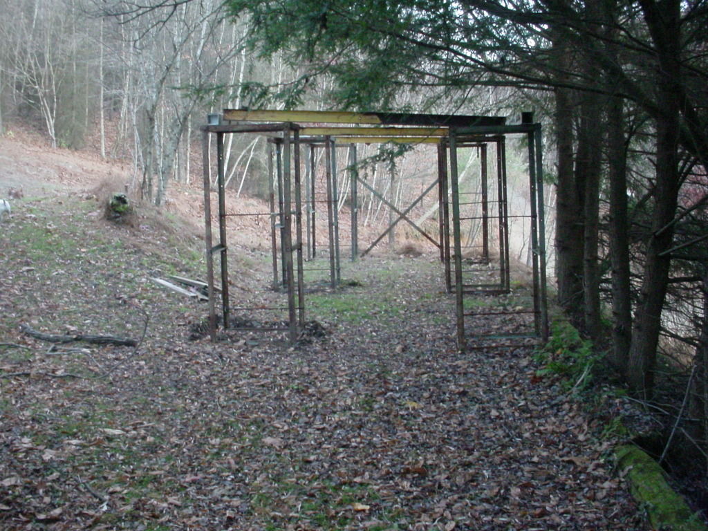

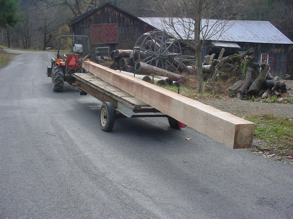

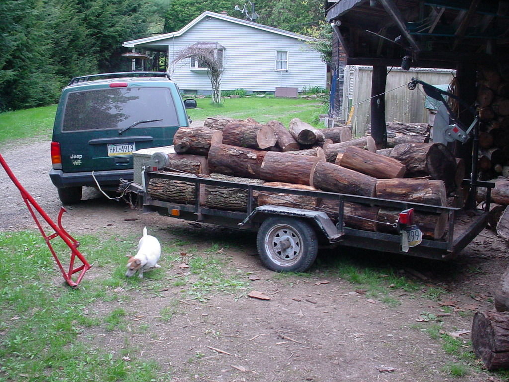

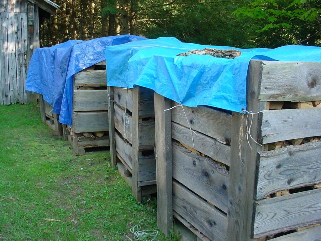

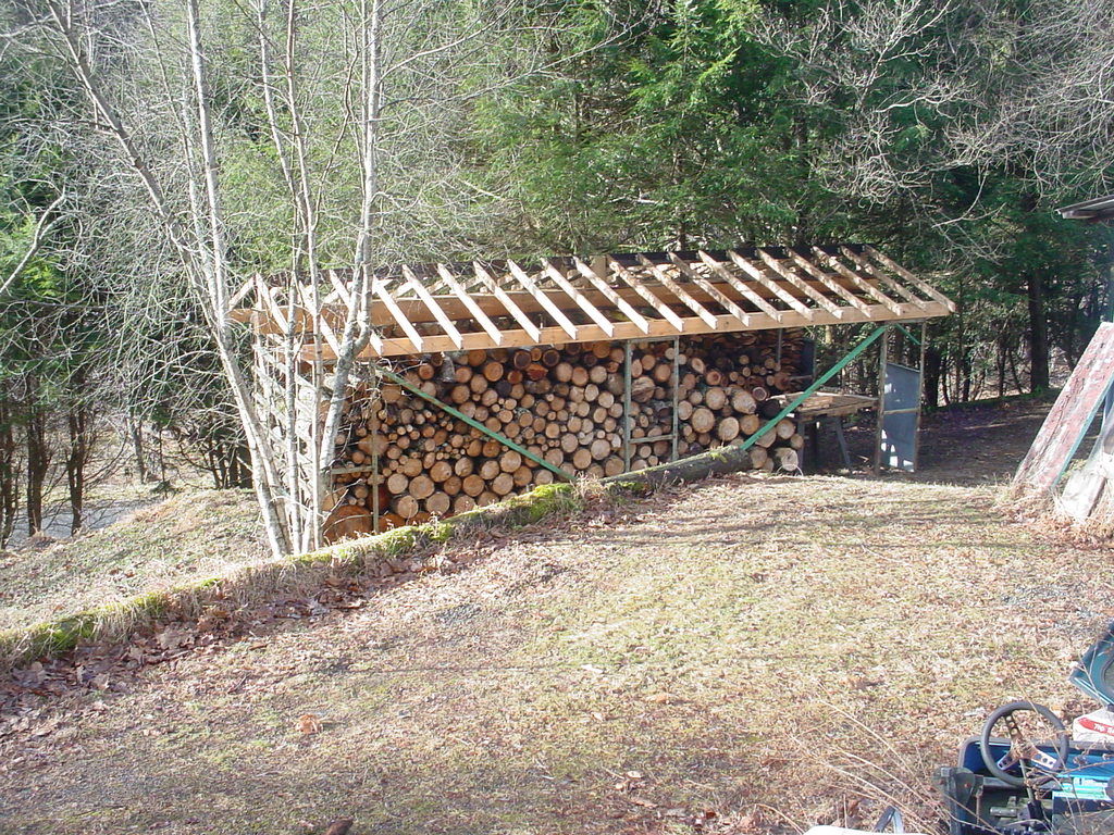

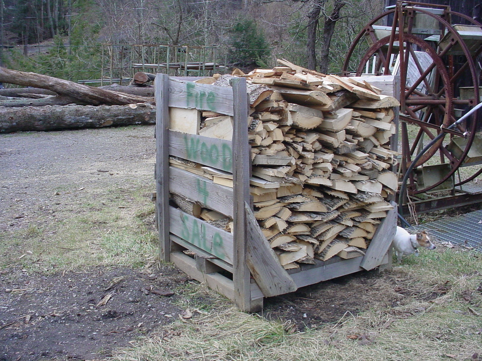

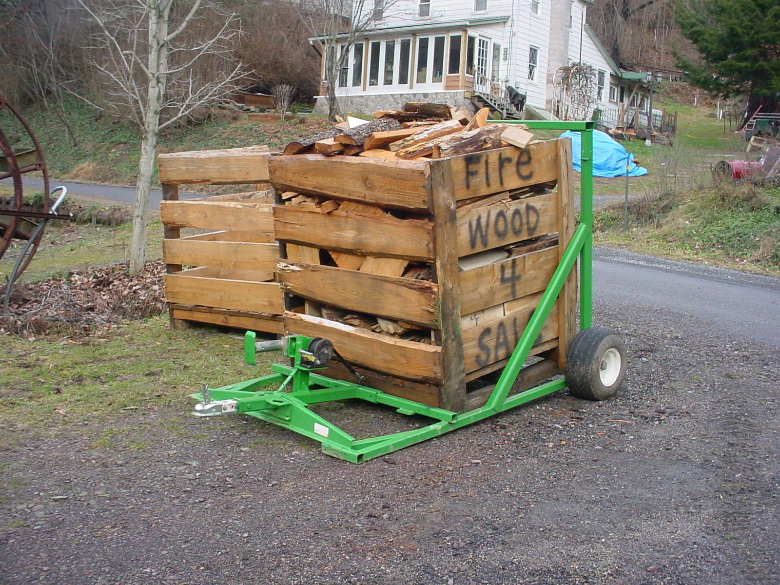

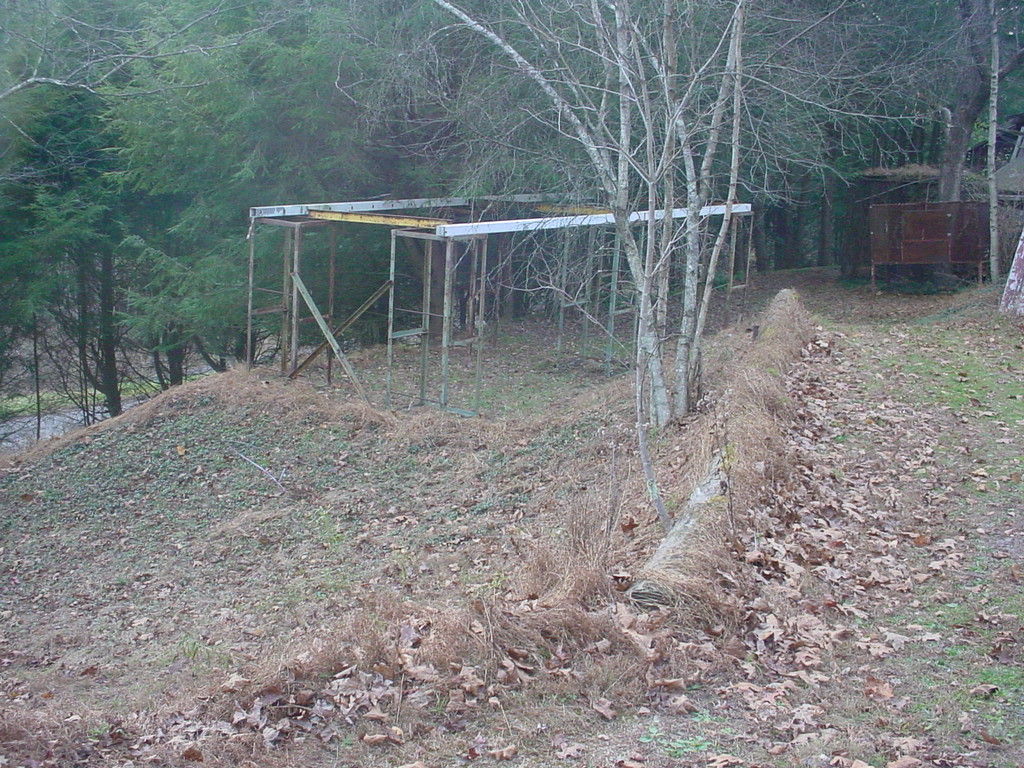

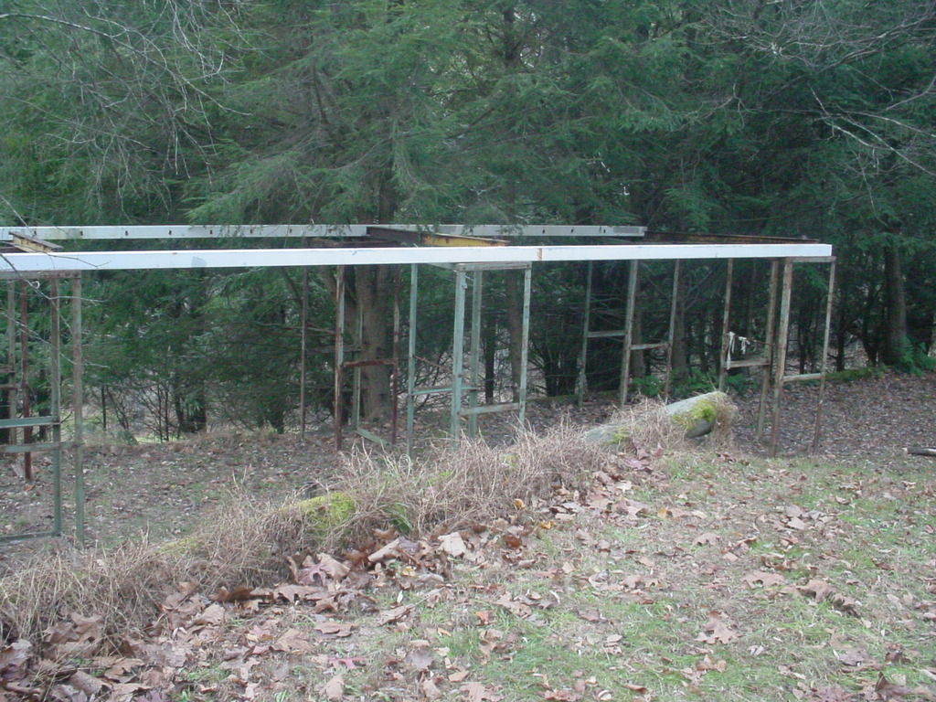

November 5, 20197 yr Author comment_207731 In our area all the ash trees are dying. I have ways to move wood so many people are just giving me free trees just for moving it. I already fill my large wood shed to the roof and I need another building to store the fire wood in. I have enough now for about 4-5 years. I can't pass up free wood. So far the building has cost me nothing but time. I do factory clean outs and the metal and bolts was free. Using fire wood sure save on the gas bill. All my eight scrap sawmill fire wood boxes are now full. I use that first because I need my empty boxes back at the mill. Each box holds 1/2 cord. I made a special trailer just to move the loaded boxes around... Edited November 5, 20197 yr by Kevin Beitz Report

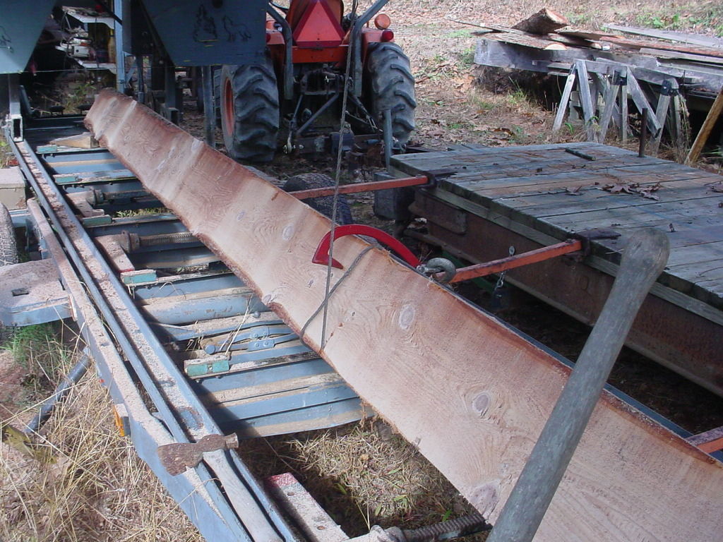

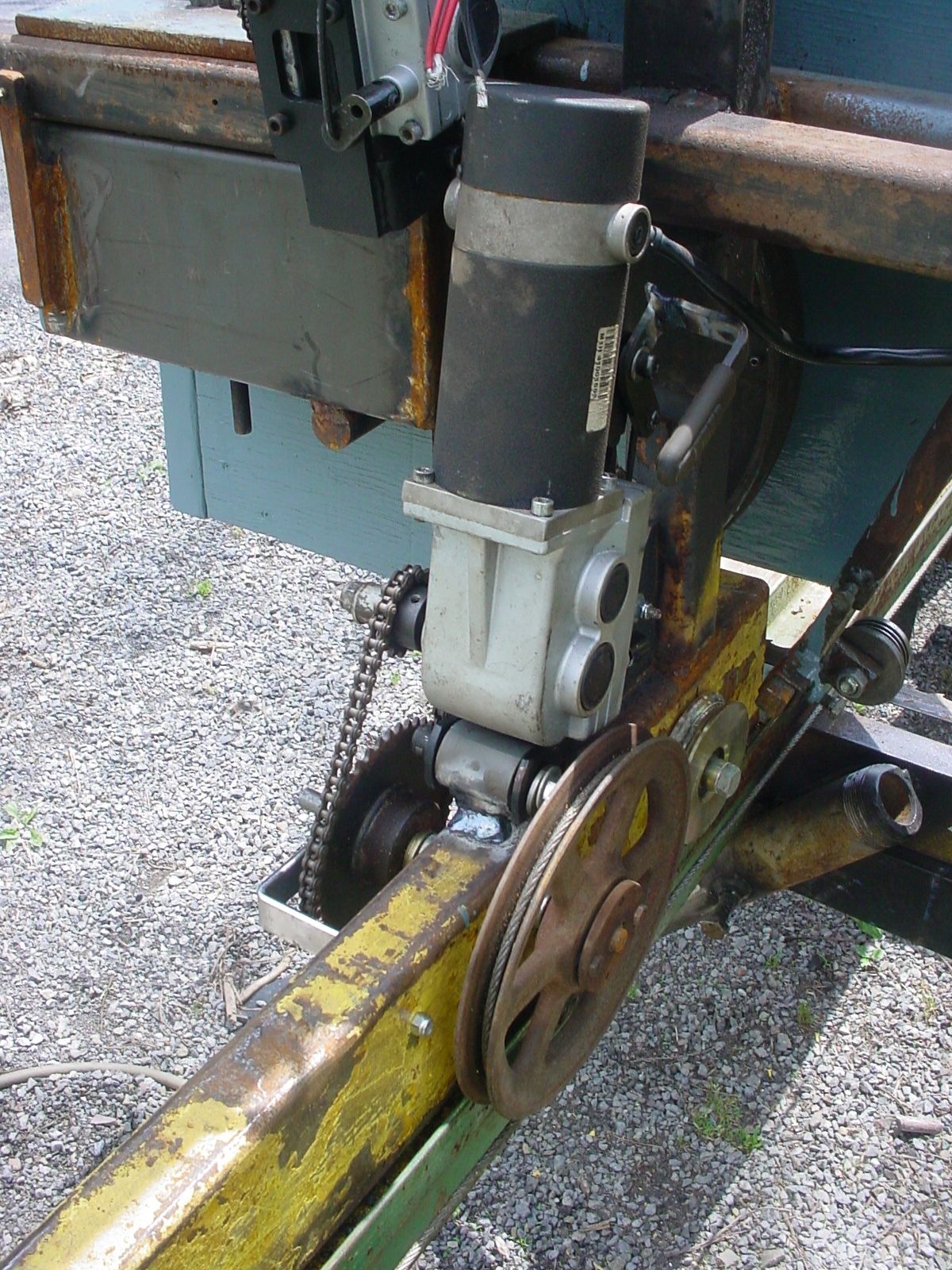

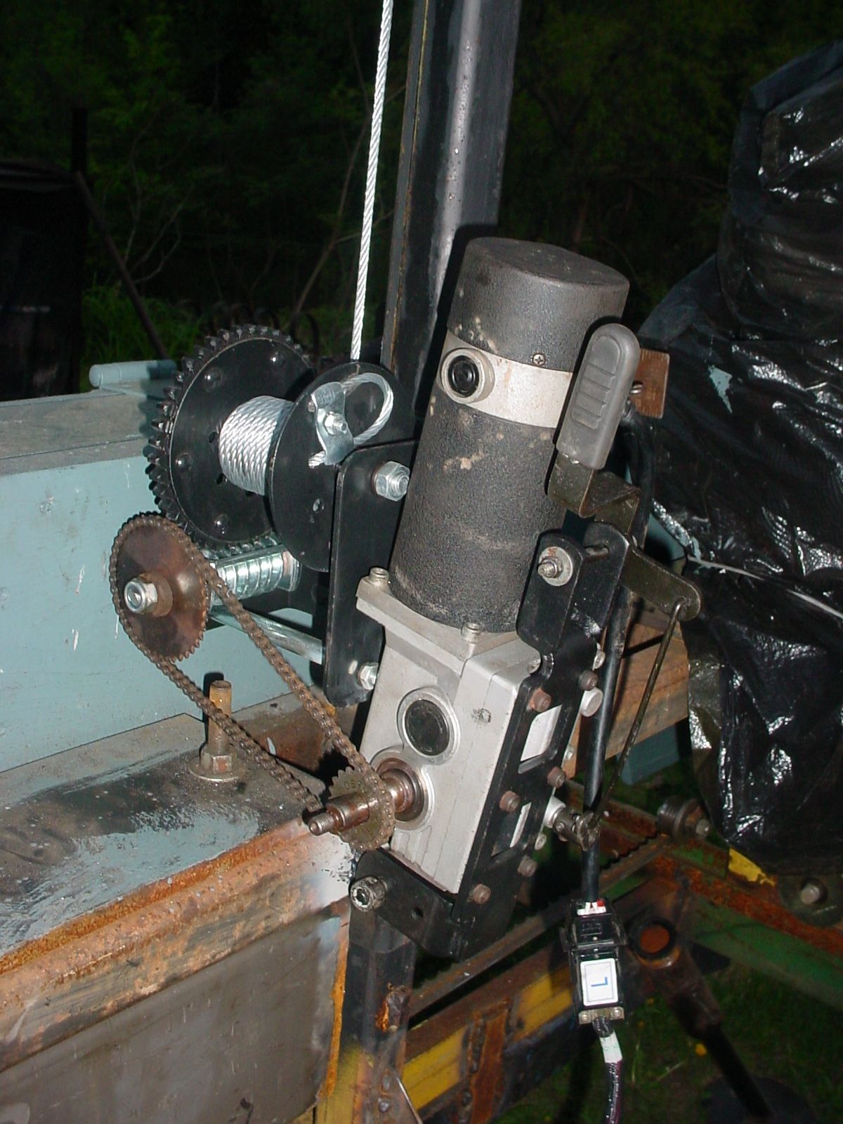

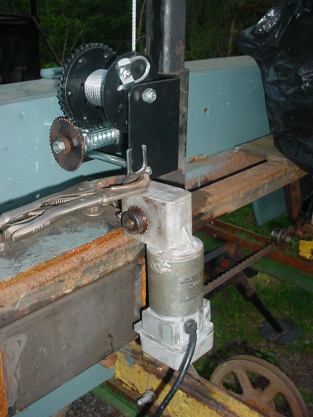

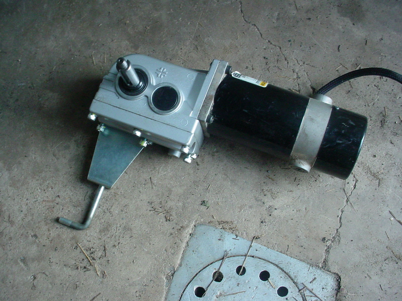

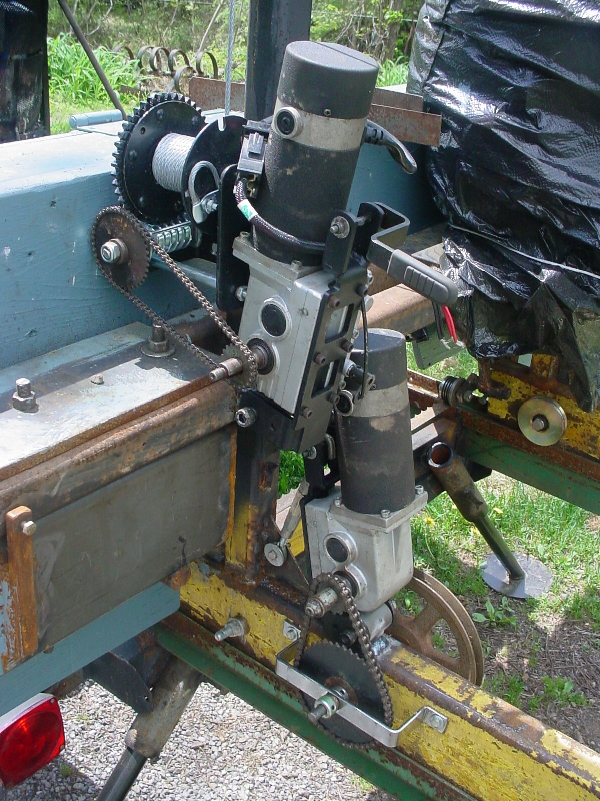

November 5, 20197 yr Author comment_207733 I'm using Wheelchair 24 volt motors to lift the carriage and push it down the rails. You just cant beat them. They don't use much power and they don't seem to get hot when pulling a load and you can get them cheap on E-bay or out of the junkyard. So far I'm very happy with the way they worked out. I used a worm gear winch that the wheelchair runs to lift the carriage. Report

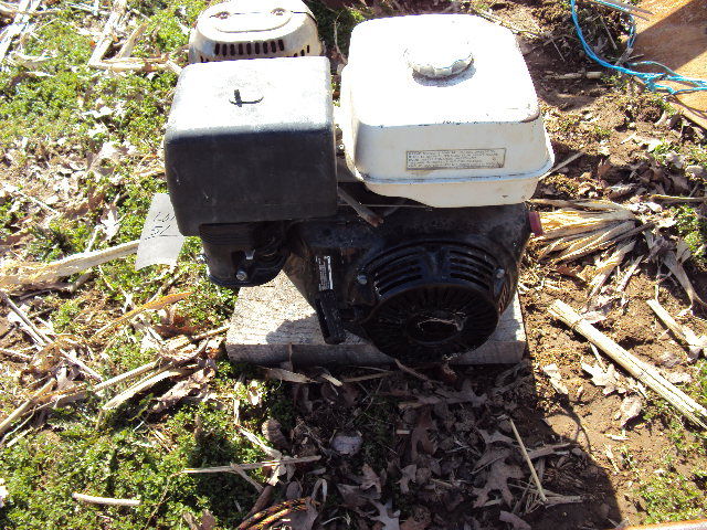

November 12, 20197 yr Author comment_208433 Powered with a 13Hp Honda engine. Bought used for $150.00. Report

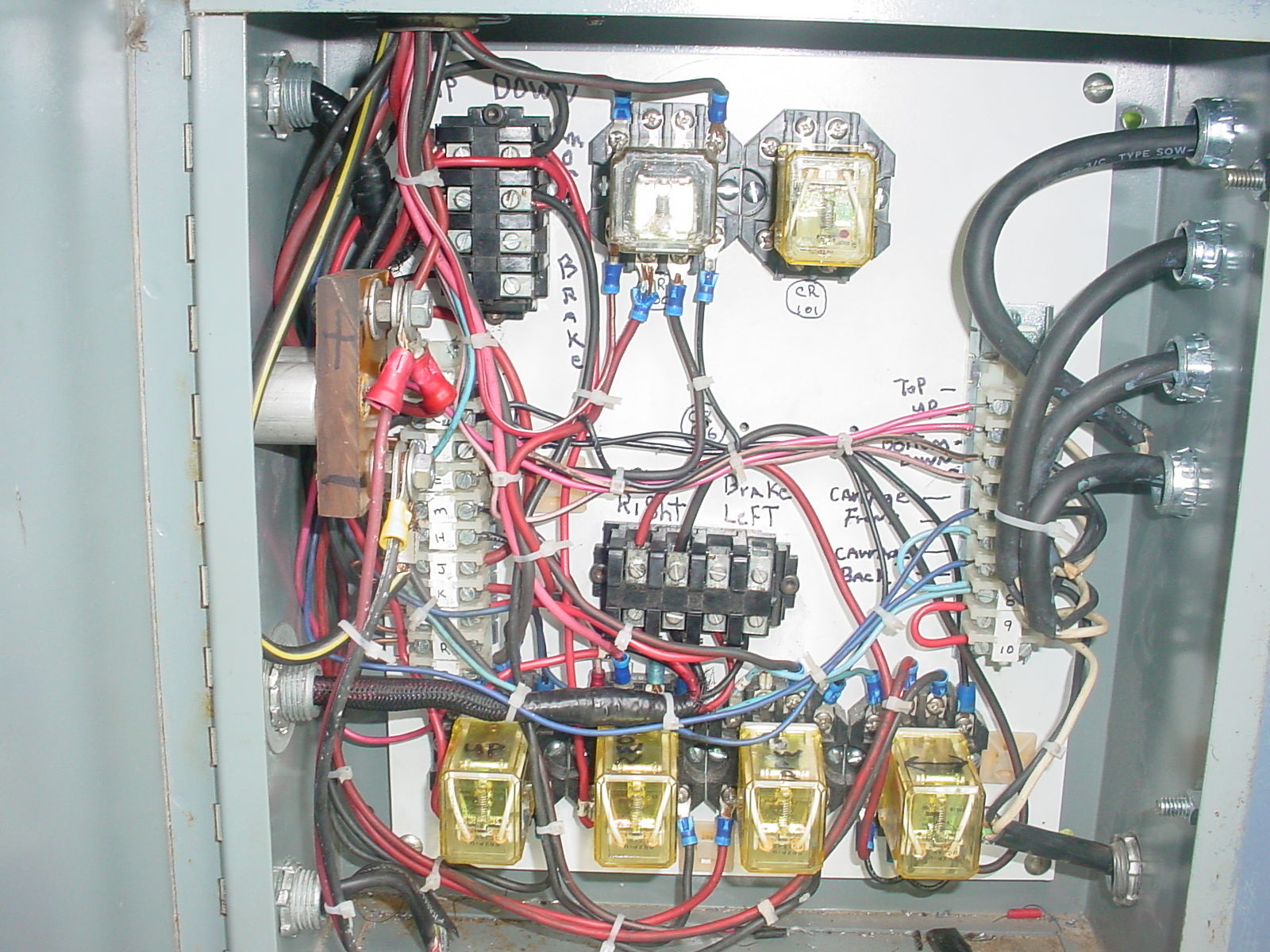

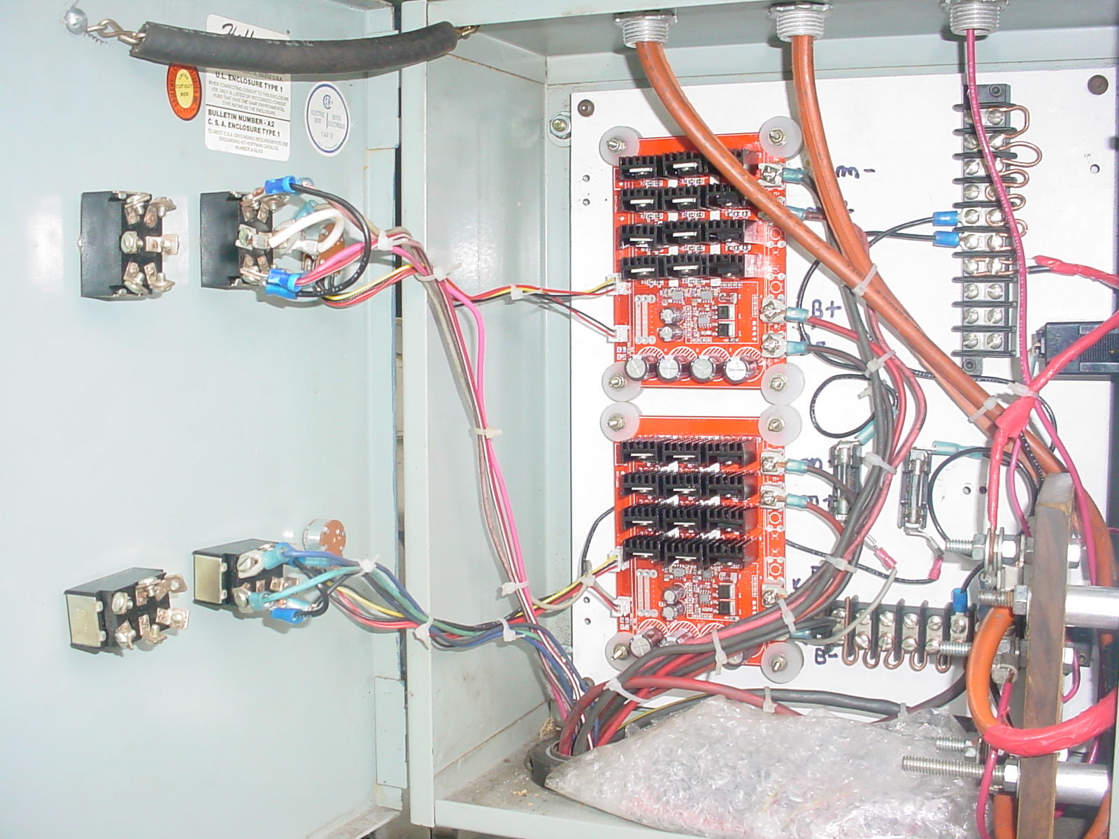

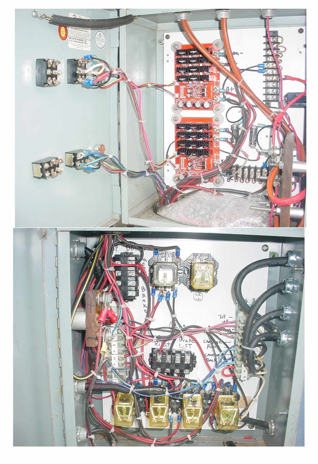

November 15, 20197 yr Author comment_208828 Good thing I like playing with electric... 24 volt system. Report
November 28, 20197 yr Author comment_210505 This is the best motors that I found for carriage movement . Cheap... Low amp use. Tough. and easy to buy (E-bay). Electric 24v wheelchair motors. Report

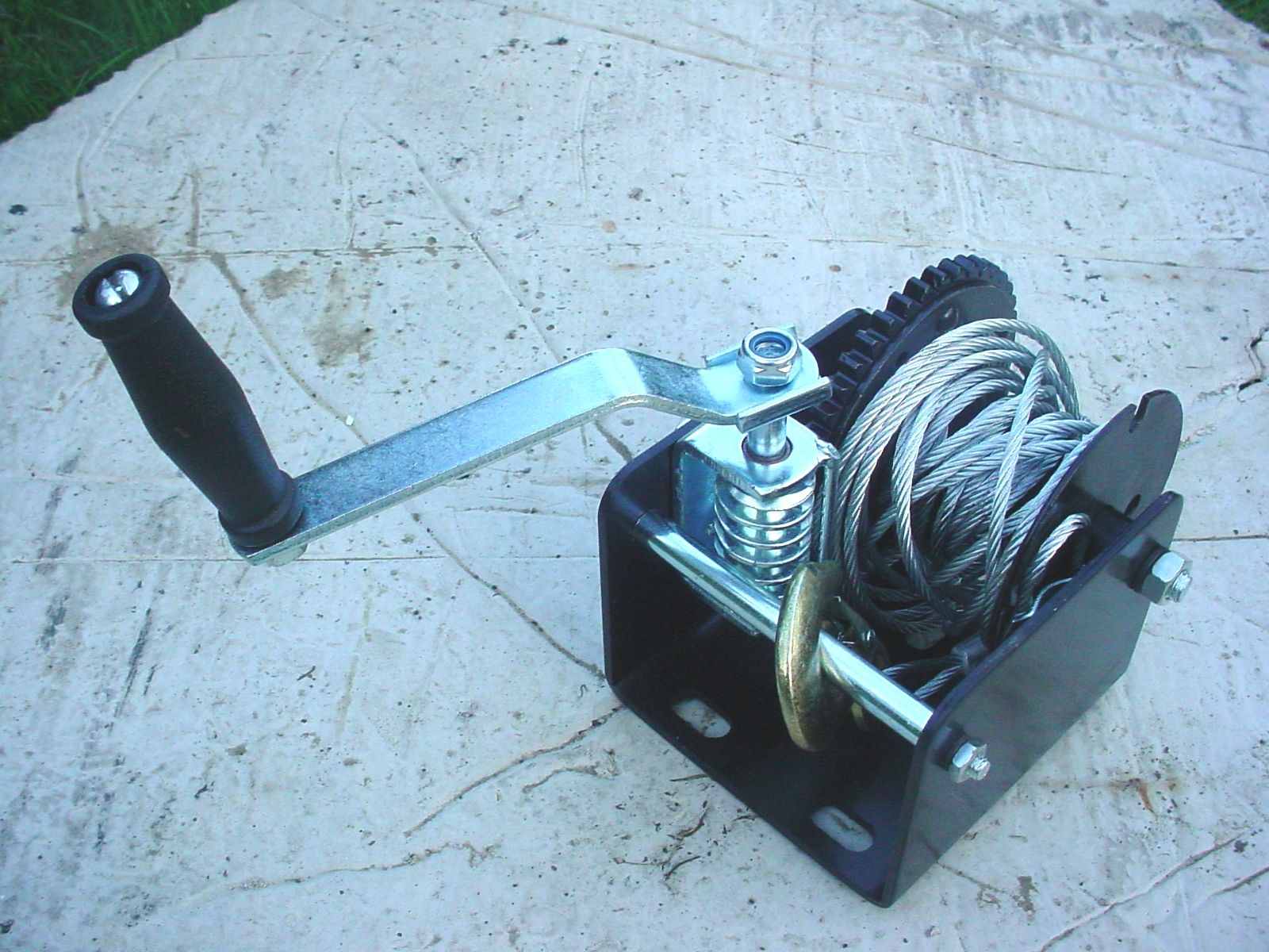

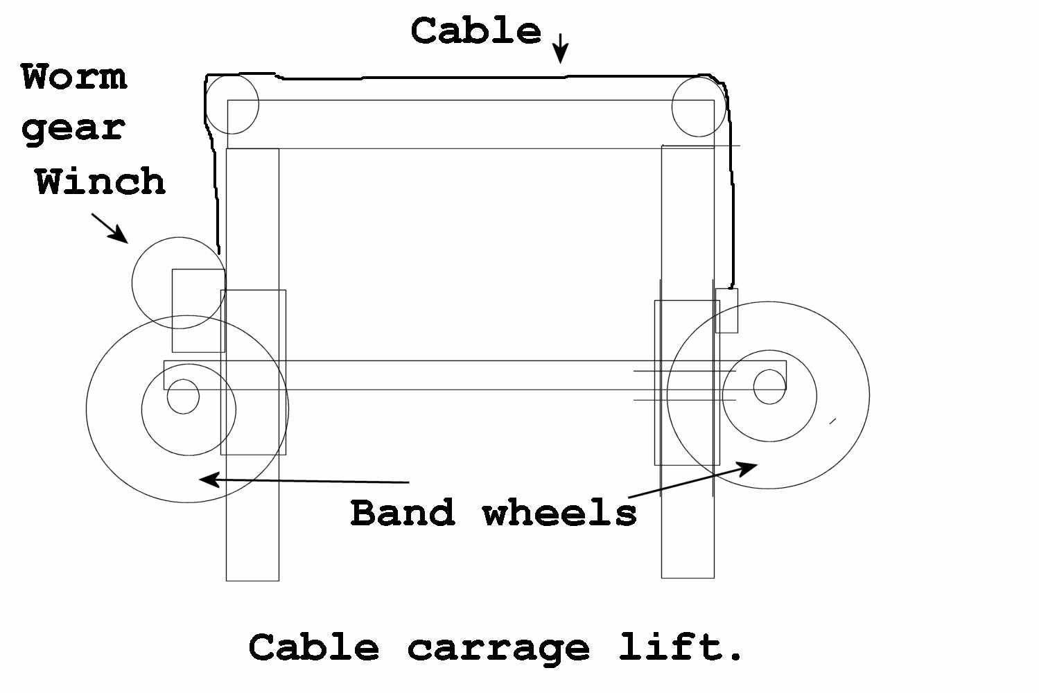

December 6, 20196 yr Author comment_211479 I found that it's best to use worm gear winches for the carriage lift. Other winches when you let go of the handle they will unwind. The worm gear will stay right where you left it. Report
December 7, 20196 yr comment_211489 2 hours ago, Kevin Beitz said: The worm gear will stay right where you left it. In had this other type in a auto repair shop they used for raising exhaust hoses to vent exhaust outside. They sucked terrible because as you stated no breaking mechanism. If you were not careful they would fall, very fast, big bang, everyone is laughing. Report
