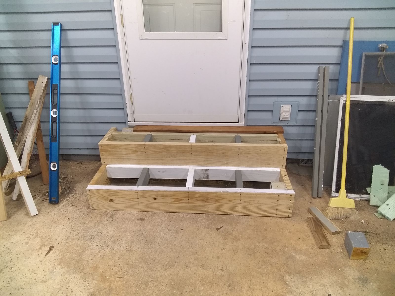

September 21, 20197 yr Author comment_202224 3 hours ago, Danl said: This one is similar to your situation. Steps can be moved to clean from behind. I had to keep the run short to allow the car to be parked in the car port. Thanks for the picture, @Cal mentioned about going wide on the one side rather than symmetrical and centered. Have to do some minor work to the siding to accommodate that design, no problem. @Cal also recommended plywood for the tops of the stairs. Gives me one piece to attached the carpet to, then bolt to the stringers, much easier to replace a single step or both later without major rebuild like now. Guys really appreciate the suggestions and pictures. Gunny Report

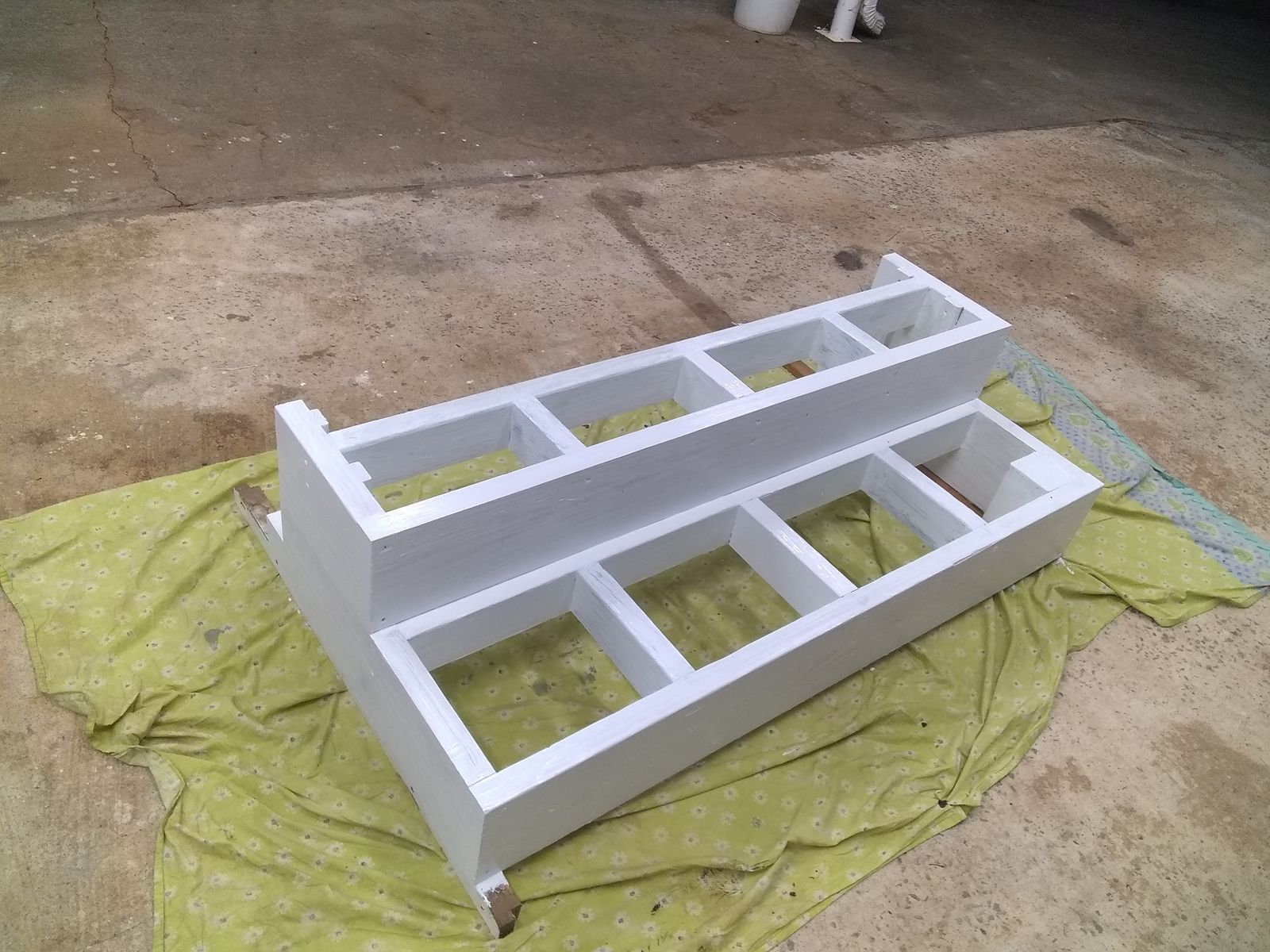

September 26, 20197 yr Author comment_202753 On 9/20/2019 at 6:48 PM, Danl said: Steps can be moved to clean from behind. Took you advice and built them about the same. Not sure from your picture what kind of bracing you used but I went with 2x4's to stiffen the entire thing. Today's work. Got the frame built and slathered a coat of primer on it. All end grain has been coated with caulk to seal it up as much as possible. Have to cut the 3/4 plywood tomorrow and edge band it with some 3/4 pine. I plan to cover the treads with outdoor carpet, wife has requested this specifically. Report

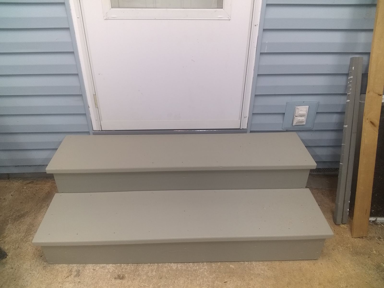

September 30, 20197 yr Author comment_203256 Once I had all the parts painted this went together quickly this afternoon. A weeks worth of work but it pays off in a nice sturdy set of steps that will last a long time. Only detail left is to install the carpet on the treads. Need to let the paint cure for a few days before installing. Report

October 4, 20197 yr Author comment_203855 This part of the carport refurb is completed. Installed carpet on steps and was tested by both Wife and two cats. All approved. Moving on with some other minor details to complete refurb. None of which is woodworking at the moment. Thanks to all who offered suggestions and advice. I truly believe this project came out better having had that input. Report
